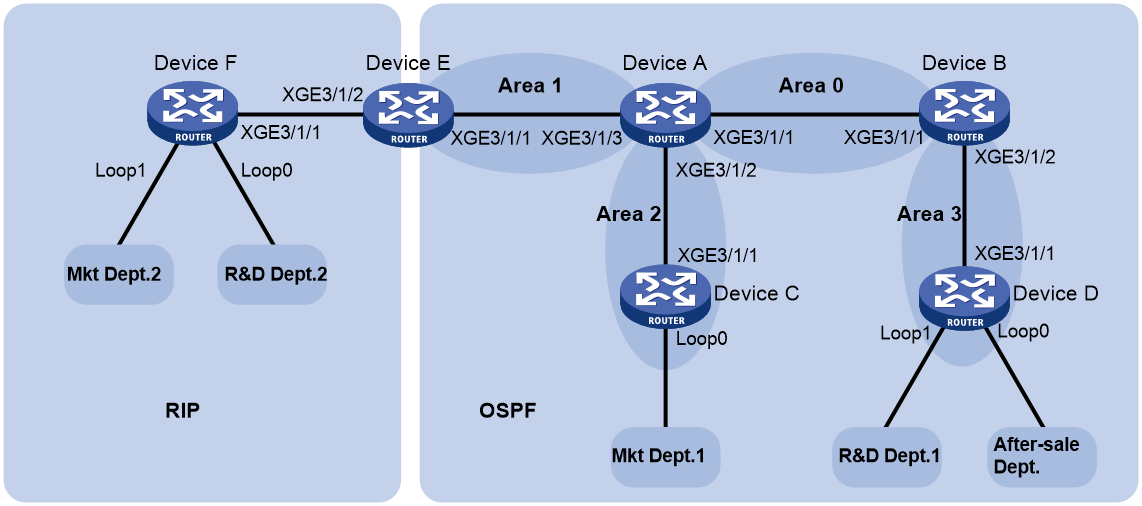

As shown in Figure 1, the devices of an enterprise reside in OSPF and RIP domains.
Configure route redistribution between OSPF and RIP to interconnect the devices.
Configure route filtering on Device E, Device C, and Device D to meet the following requirements:
·     The route destined for R&D department 2 is not redistributed to OSPF.
·     Marketing department 1 cannot reach R&D department 1.
·     R&D department 1 and the After-sale service department cannot reach Marketing department 2.
Figure 1 Network diagram
Device
Interface
IP address
Device
Interface
IP address
Device A
XGE3/1/1
10.1.1.1/24
Device B
XGE3/1/1
10.1.1.2/24
XGE3/1/2
10.2.1.1/24
XGE3/1/2
10.3.1.1/24
XGE3/1/3
10.4.1.1/24
Device C
XGE3/1/1
10.2.1.2/24
Device D
XGE3/1/1
10.3.1.2/24
Loop0
192.168.3.1/24
Loop0
192.168.1.1/24
Loop1
192.168.2.1/24
Device E
XGE3/1/1
10.4.1.2/24
Device F
XGE3/1/1
10.5.1.2/24
XGE3/1/2
10.5.1.1/24
Loop0
192.168.4.1/24
Loop1
192.168.5.1/24

Destination/Mask   Proto   Pre Cost        NextHop         Interface
0.0.0.0/32         Direct  0   0           127.0.0.1       InLoop0
10.1.1.0/24        O_INTER 10  2           10.3.1.1        XGE3/1/1
10.2.1.0/24        O_INTER 10  3           10.3.1.1        XGE3/1/1
10.3.1.0/24        Direct  0   0           10.3.1.2        XGE3/1/1
10.3.1.0/32        Direct  0   0           10.3.1.2        XGE 3/1/1
10.3.1.2/32        Direct  0   0           127.0.0.1       InLoop0
10.3.1.255/32      Direct  0   0           10.3.1.2        XGE3/1/1
10.4.1.0/24        O_INTER 10  3           10.3.1.1        XGE3/1/1
10.5.1.0/24        O_ASE2  150 1           10.3.1.1        XGE3/1/1
127.0.0.0/8        Direct  0   0           127.0.0.1       InLoop0
127.0.0.0/32       Direct  0   0           127.0.0.1       InLoop0
127.0.0.1/32       Direct  0   0           127.0.0.1       InLoop0
127.255.255.255/32 Direct  0   0           127.0.0.1       InLoop0
192.168.1.0/24     Direct  0   0           192.168.1.1     Loop0
192.168.1.0/32     Direct  0   0           192.168.1.1     Loop0
192.168.1.1/32     Direct  0   0           127.0.0.1       InLoop0
192.168.1.255/32   Direct  0   0           192.168.1.1     Loop0
192.168.2.0/24     Direct  0   0           192.168.2.1     Loop1
192.168.2.0/32     Direct  0   0           192.168.2.1     Loop1
192.168.2.1 /32    Direct  0   0           127.0.0.1       InLoop0
192.168.2.255/32   Direct  0   0           192.168.2.1     Loop1
192.168.3.1/32     O_INTER 10  3           10.3.1.1        XGE3/1/1
224.0.0.0/4        Direct  0   0           0.0.0.0         NULL0
224.0.0.0/24       Direct  0   0           0.0.0.0         NULL0
255.255.255.255/32 Direct  0   0           127.0.0.1       InLoop0
# Verify that the After-sale service department cannot reach Marketing department 2.
[DeviceD] ping -a 192.168.1.1 192.168.5.1
Ping 192.168.5.1 (192.168.5.1) from 192.168.1.1: 56 data bytes, press CTRL_C to
break
Request time out
Request time out
Request time out
Request time out
Request time out
--- Ping statistics for 192.168.5.1 ---
5 packet(s) transmitted, 0 packet(s) received, 100.0% packet loss
# Verify that R&D department 1 cannot reach Marketing department 2.
[DeviceD] ping -a 192.168.2.1 192.168.5.1
Ping 192.168.5.1 (192.168.5.1) from 192.168.2.1: 56 data bytes, press CTRL_C to
break
Request time out
Request time out
Request time out
Request time out
Request time out
The output on Device C and Device D shows that Device E has filtered the route destined for R&D development 2.
Configuration files
·     Device A:
ospf 1
 area 0.0.0.0
  network 10.1.1.0 0.0.0.255
 area 0.0.0.1
network 10.4.1.0 0.0.0.255
area 0.0.0.2
  network 10.2.1.0 0.0.0.255
interface Ten-GigabitEthernet3/1/1
 port link-mode route
interface Ten-GigabitEthernet3/1/2
 ip address 10.2.1.1 255.255.255.0
interface Ten-GigabitEthernet3/1/3
 ip address 10.4.1.1 255.255.255.0
·     Device B:
ospf 1
 area 0.0.0.0
 area 0.0.0.3
  network 10.3.1.0 0.0.0.255
 ip address 10.1.1.2 255.255.255.0
 ip address 10.3.1.1 255.255.255.0
·     Device C:
ospf 1
 filter-policy 2000 import
 area 0.0.0.2
  network 192.168.3.0 0.0.0.255
interface LoopBack0
 ip address 192.168.3.1 255.255.255.0
 ip address 10.2.1.2 255.255.255.0
acl basic 2000
 rule 0 deny source 192.168.2.0 0.0.0.255
rule 5 permit
·     Device D:
ospf 1
 area 0.0.0.3
  network 192.168.1.0 0.0.0.255
  network 192.168.2.0 0.0.0.255
interface LoopBack0
interface LoopBack1
 ip address 192.168.2.1 255.255.255.0
 ip address 10.3.1.2 255.255.255.0
acl basic 2000
 rule 0 deny source 192.168.5.0 0.0.0.255
rule 5 permit
·     Device E:
ospf 1
 import-route direct
 import-route rip 1
 filter-policy 2000 export rip 1
 area 0.0.0.1
rip 1
 undo summary
 version 2
 network 10.5.1.0 0.0.0.255
 import-route direct
 import-route ospf 1
 ip address 10.4.1.2 255.255.255.0
 ip address 10.5.1.1 255.255.255.0
acl basic 2000
 rule 0 deny source 192.168.4.0 0.0.0.255
rule 5 permit
·     Device F:
rip 1
 undo summary
 version 2
 network 192.168.4.0
 network 192.168.5.0
interface LoopBack0
 ip address 192.168.4.1 255.255.255.0
interface LoopBack1
 ip address 192.168.5.1 255.255.255.0
 ip address 10.5.1.2 255.255.255.0
Related documentation
·     H3C CR16000-F Routers Layer—3 IP Routing Configuration Guide-R8385P09
·     H3C CR16000-F Routers Layer—3 IP Routing Command Reference-R8385P09
