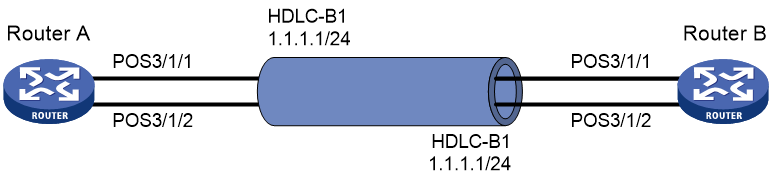

Example: Directly connecting routers through POS interfaces that use HDLC
As shown in Figure 2, configure an HDLC link bundle to increase bandwidth and enhance connection reliability between Router A and Router B.
Figure 2 Network diagram
An interface can belong to only one HDLC link bundle at any point in time. To assign a member interface to another HDLC link bundle, remove the interface from the current HDLC link bundle first.
The link layer protocol of an interface to be assigned to an HDLC link bundle must be HDLC. After the interface is assigned to the HDLC link bundle, its link layer protocol cannot be changed.
When two routers are directly connected through POS interfaces, set different clock modes on the two routers.

# Display HDLC link bundle information on Router A and Router B. This example uses Router A.
[RouterA] display bundle hdlc-bundle 1 slot 3
Bundle: HDLC-bundle1
  Selected members: 2, Total bandwidth: 1244160 kbps
  Member              State               Bandwidth(kbps)     Priority
  Pos3/1/1            Selected            622080              32768
  Pos3/1/2            Selected            622080              32768
The output shows that HDLC bundle 1 has member interfaces POS 3/1/1 and POS 3/1/2 and both of the member interfaces are in Selected state.
Configuration files
·     Router A:
interface pos 3/1/1
 clock master
 link-protocol hdlc
 bundle id 1
interface pos 3/1/2
 clock master
 link-protocol hdlc
 bundle id 1
interface hdlc-bundle 1
 ip address 1.1.1.1 24
·     Router B:
interface pos 3/1/1
 link-protocol hdlc
 bundle id 1
interface pos 3/1/2
 link-protocol hdlc
 bundle id 1
 ip address 1.1.1.2 24
