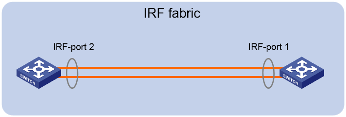

IRF port connection
When you connect neighboring IRF members, connect the physical interfaces of IRF-port 1 on one member to the physical interfaces of IRF-port 2 on the other (see Figure 1). On neighboring members, IRF ports with the same port index cannot have physical connections.
Figure 1 Connecting IRF physical interfaces

Verifying the IRF function
# Verify that the IRF fabric has been established.
[DeviceA] display irf
MemberID  Slot  Role    Priority  CPU-Mac         Description
 *+1      0     Master  1         0210-fc01-0000  ---
   2      0     Standby 1         0210-fc02-0000  ---
 * indicates the device is the master.
 + indicates the device through which the user logs in.
 The Bridge MAC of the IRF is: 3822-d60f-2800
 Auto upgrade                : yes
 Mac persistent              : always
 Domain ID                   : 0
 Auto merge                  : yes
Verifying the link backup function of multichassis aggregations

Verifying the link backup function of IRF connections
# Verify that the IRF fabric does not split and can forward traffic across member chassis after one IRF connection cable is removed. (Details not shown.)
