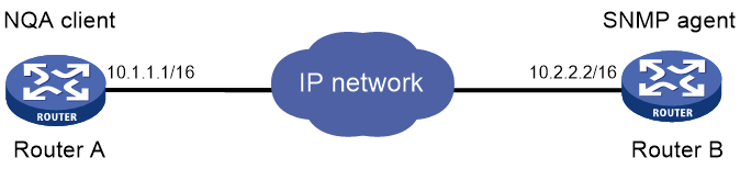

As shown in Figure 1, configure an ICMP echo operation to test the roundtrip time between Router A and Router D through Router B.
Figure 1 Network diagram
When you configure an ICMP echo operation, follow these restrictions and guidelines:
·     Make sure the devices can reach each other before you start the ICMP echo operation.
·     You cannot modify the operation configuration for a running NQA operation.
Procedures
# Create an ICMP echo operation.
<RouterA> system-view
[RouterA] nqa entry admin test
[RouterA-nqa-admin-test] type icmp-echo
# Specify the destination IP address of ICMP echo requests as 60.1.1.1.
[RouterA-nqa-admin-test-icmp-echo] destination ip 60.1.1.1
# Specify the next hop of ICMP echo requests as 10.1.1.2.
[RouterA-nqa-admin-test-icmp-echo] next-hop ip 10.1.1.2
# Configure the ICMP echo operation to perform 10 probes.
[RouterA-nqa-admin-test-icmp-echo] probe count 10
# Specify the probe timeout time as 500 milliseconds for the ICMP echo operation.
[RouterA-nqa-admin-test-icmp-echo] probe timeout 500
# Configure the ICMP echo operation to repeat at an interval of 5000 milliseconds.
[RouterA-nqa-admin-test-icmp-echo] frequency 5000
# Enable saving history records.
[RouterA-nqa-admin-test-icmp-echo] history-record enable
# Configure the maximum number of history records that can be saved as 10.
[RouterA-nqa-admin-test-icmp-echo] history-record number 10
[RouterA-nqa-admin-test-icmp-echo] quit
# Start the ICMP echo operation.
[RouterA] nqa schedule admin test start-time now lifetime forever
# After the ICMP echo operation runs for a time period, stop the operation.
[RouterA] undo nqa schedule admin test
# Display the most recent result of the ICMP echo operation.
[RouterA] display nqa result admin test
NQA entry (admin admin, tag test) test results:
    Send operation times: 10             Receive response times: 10
    Min/Max/Average round trip time: 2/5/3
    Square-Sum of round trip time: 96
    Last succeeded probe time: 2021-03-23 15:00:01.2
  Extended results:
    Packet loss ratio: 0%
    Failures due to timeout: 0
    Failures due to internal error: 0
    Failures due to other errors: 0
# Display the history records of the ICMP echo operation.
[RouterA] display nqa history admin test
NQA entry (admin admin, tag test) history records:
Index      Response     Status           Time
370        3            Succeeded        2021-03-23 15:00:01.2
369        3            Succeeded        2021-03-23 15:00:01.2
368        3            Succeeded        2021-03-23 15:00:01.2
367        5            Succeeded        2021-03-23 15:00:01.2
366        3            Succeeded        2021-03-23 15:00:01.2
365        3            Succeeded        2021-03-23 15:00:01.2
364        3            Succeeded        2021-03-23 15:00:01.1
363        2            Succeeded        2021-03-23 15:00:01.1
362        3            Succeeded        2021-03-23 15:00:01.1
361        2            Succeeded        2021-03-23 15:00:01.1
The output shows that the packets sent by Router A can reach Router D through Router B. No packet loss occurs during the operation. The minimum, maximum, and average round-trip times are 2, 5, and 3 milliseconds, respectively.

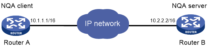

As shown in Figure 2, configure a DHCP operation to test the time required for Router A to obtain an IP address from the DHCP server (Router B).
Figure 2 Network diagram
When you configure a DHCP operation, follow these restrictions and guidelines:
·     Complete the DHCP server configuration before you start the DHCP operation.
·     Make sure the devices can reach each other before you start the DHCP operation.
Procedures
# Create a DHCP operation.
[RouterA-nqa-admin-test] type dhcp
# Specify the DHCP server IP address 10.1.1.2 as the destination address.
[RouterA-nqa-admin-test-dhcp] destination ip 10.1.1.2
# Enable the saving of history records.
[RouterA-nqa-admin-test-dhcp] history-record enable
[RouterA-nqa-admin-test-dhcp] quit
# Start the DHCP operation.
# After the operation runs for a time period, stop the operation.
# Display the most recent result of the DHCP operation.
  NQA entry(admin admin, tag test) test results:
      Send operation times: 1              Receive response times: 1
      Min/Max/Average round trip time: 624/624/624
      Square-Sum of round trip time: 389376
      Last succeeded probe time: 2021-03-24 09:56:03.2
    Extend results:
# Display the history records of the DHCP operation.
NQA entry(admin admin, tag test) history records:
    1          624          Succeeded        2021-03-24 09:56:03.2
The output shows that it took Router A 624 milliseconds to obtain an IP address from the DHCP server.

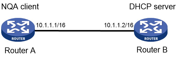

As shown in Figure 3, configure an FTP operation to test the file transmission time between Router A and the FTP server. The login username and password are admin and systemtest, respectively.
Figure 3 Network diagram
When you configure an FTP operation, follow these restrictions and guidelines:
·     Make sure the devices can reach each other before you start the FTP operation.
·     When you perform the put operation with the filename command configured, make sure the file exists on the NQA client.
·     Take the network bandwidth into consideration when you set the file size and the probe timeout.
Procedures
# Create an FTP operation.
[RouterA-nqa-admin-test] type ftp
# Specify the URL of the FTP server.
[RouterA-nqa-admin-test-ftp] url ftp://10.2.2.2
# Specify 10.1.1.1 as the source IP address.
[RouterA-nqa-admin-test-ftp] source ip 10.1.1.1
# Specify the FTP operation type as put.
[RouterA-nqa-admin-test-ftp] operation put
# Specify the file to be uploaded as config.txt.
[RouterA-nqa-admin-test-ftp] filename config.txt
# Specify the username for the FTP operation as admin.
[RouterA-nqa-admin-test-ftp] username admin
# Specify the password for the FTP operation as systemtest.
[RouterA-nqa-admin-test-ftp] password simple systemtest
[RouterA-nqa-admin-test-ftp] history-record enable
[RouterA-nqa-admin-test-ftp] quit
# Start the FTP operation.
# After the FTP operation runs for a time period, stop the operation.
# Display the most recent result of the FTP operation.
      Min/Max/Average round trip time: 173/173/173
      Square-Sum of round trip time: 29929
      Last succeeded probe time: 2021-03-25 10:07:28.6
    Extend results:
      Failures due to disconnect: 0
      Failures due to no connection: 0
# Display the history records of the FTP operation.
    1          173          Succeeded        2021-03-25 10:07:28.6
The output shows that it took Router A 173 milliseconds to upload a file to the FTP server.

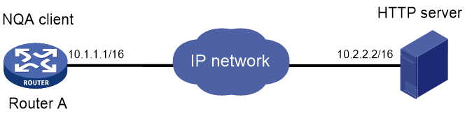

As shown in Figure 4, configure an HTTP operation on the NQA client to test the time required to obtain data from the HTTP server.
Figure 4 Network diagram
When you configure an HTTP operation, follow these restrictions and guidelines:

Example: Configuring a UDP jitter operation
As shown in Figure 5, configure a UDP jitter operation to test the jitter, delay, and round-trip time between Router A and Router B.

When you configure a UDP jitter operation, follow these restrictions and guidelines:
·     Make sure the devices can reach each other before you start the UDP jitter operation.
·     Configure Router B as the NQA server before you start the UDP jitter operation.
Procedures
Configuring Router B
# Enable the NQA server.
<RouterB> system-view
[RouterB] nqa server enable
# Configure a UDP listening service to listen on the IP address 10.2.2.2 and UDP port 9000.
[RouterB] nqa server udp-echo 10.2.2.2 9000
Configuring Router A

Example: Configuring an SNMP operation
As shown in Figure 6, configure an SNMP operation to test the time the NQA client uses to get a response from the SNMP agent.
Figure 6 Network diagram
When you configure an SNMP operation, follow these restrictions and guidelines:
·     Make sure the devices can reach each other before you start the SNMP operation.
·     Configure Router B as the SNMP agent before you start the SNMP operation.
Procedures

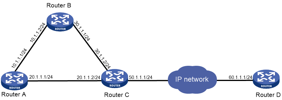

Example: Configuring a TCP operation
As shown in Figure 7, configure a TCP operation to test the time required for Router A and Router B to establish a TCP connection.
Figure 7 Network diagram
When you configure a TCP operation, follow these restrictions and guidelines:
·     Make sure the devices can reach each other before you start the TCP operation.
·     Configure Router B as the NQA server before you start the TCP operation.
Procedures

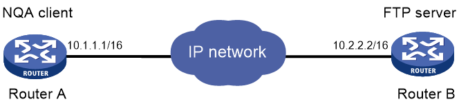

Example: Configuring a UDP echo operation
As shown in Figure 8, configure a UDP echo operation to test the round-trip time between Router A and Router B. The destination port number is 8000.
Figure 8 Network diagram
When you configure a UDP echo operation, follow these restrictions and guidelines:
·     Make sure the devices can reach each other before you start the UDP echo operation.
·     Configure Router B as the NQA server before you start the UDP echo operation.
Procedures
