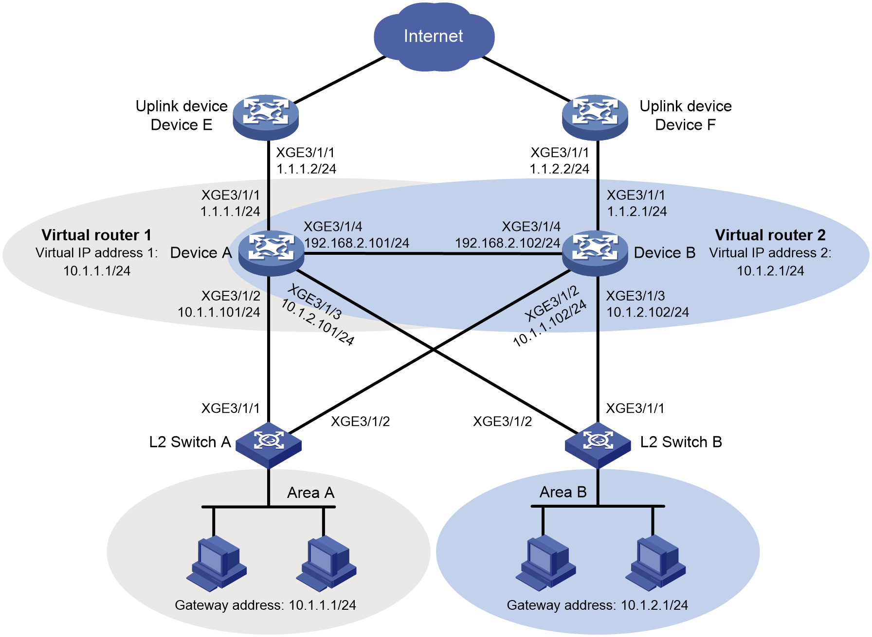

Example: Configuring VRRP-BFD-Track collaboration
As shown in Figure 1:
·     Two distribution layer devices, Device A and Device B, are deployed at the egress of area A and area B.
·     Device A and Device B belong to VRRP group 1 and VRRP group 2.
·     Device A is the master in VRRP group 1. Device B is the master in VRRP group 2.
·     The default gateway is VRRP group 1 for users in area A and VRRP group 2 for users in area B.
Configure VRRP-Track-BFD collaboration to meet the following requirements:
·     When Device A and Device B are operating correctly, they forward traffic for users in area A and area B, respectively.
·     When one gateway device or the uplink of the device fails, BFD can detect the failure and the other device takes over to implement link switchover.
·     When the downlink of a gateway device fails, L2 Switch A or L2 Switch B forwards user traffic to the gateway through interface Ten-GigabitEthernet 3/1/2. When the fault is cleared, L2 Switch A or L2 Switch B forwards user traffic to the gateway through interface Ten-GigabitEthernet 3/1/1.
Figure 1 Network diagram
Analysis
To meet the network requirements, you must perform the following tasks:
·     For Device A to become the master in VRRP group 1, configure a higher priority (110) for Device A in VRRP group 1 (Device B uses the default priority 100). For Device B to become the master in VRRP group 2, configure a higher priority (110) for Device B in VRRP group 2 (Device A uses the default priority 100).
·     To enable the failed master to forward traffic when it recovers, configure both VRRP groups to operate in preemptive mode.
·     To prevent MSTP from blocking uplink interface Ten-GigabitEthernet 3/1/1 of Device A and Device B, disable the spanning tree feature on the interfaces.
When you configure VRRP-BFD-Track collaboration, follow these restrictions and guidelines:
·     Make sure the VRRP versions on all devices of the VRRP group are the same.
·     The source IP address for BFD echo packets cannot be on the same network segment as any local interface's IP address. Otherwise, a large number of ICMP redirect packets might be sent from the peer, resulting in link congestion.
·     The virtual IP address of an IPv4 VRRP group and the downlink interface IP address of the VRRP group must be in the same subnet. Otherwise, the hosts in the subnet might fail to access external networks.
Procedures
Configuring interface IP addresses
1.     Configure Device A:
<DeviceA> system-view
[DeviceA] interface ten-gigabitethernet 3/1/1
[DeviceA-Ten-GigabitEthernet3/1/1] ip address 1.1.1.1 24
[DeviceA-Ten-GigabitEthernet3/1/1] quit
2.     Configure other devices in the same way Device A is configured. (Details not shown.)
Configuring static routes from Device E and Device F to the virtual IP addresses of the VRRP groups
1.     Configure Device E:
Configure static routes to the virtual IP addresses of VRRP group 1 and VRRP group 2.
<DeviceE> system-view
[DeviceE] ip route-static 10.1.1.0 255.255.255.0 1.1.1.1
[DeviceE] ip route-static 10.1.2.0 255.255.255.0 1.1.1.1
2.     Configure Device F:
<DeviceF> system-view
[DeviceF] ip route-static 10.1.1.0 255.255.255.0 1.1.2.1
[DeviceF] ip route-static 10.1.2.0 255.255.255.0 1.1.2.1
Configuring VRRP groups
# Configure the virtual IP address for VRRP group 1, set the preemption delay, and configure the priority of Device A in VRRP group 1.
[DeviceA] interface ten-gigabitethernet 3/1/2
[DeviceA-Ten-GigabitEthernet3/1/2] vrrp vrid 1 virtual-ip 10.1.1.1
[DeviceA-Ten-GigabitEthernet3/1/2] vrrp vrid 1 priority 110
[DeviceA-Ten-GigabitEthernet3/1/2] vrrp vrid 1 preempt-mode delay 500
[DeviceA-Ten-GigabitEthernet3/1/2] quit
# Configure the virtual IP address for VRRP group 2, and set the preemption delay.
[DeviceA] interface ten-gigabitethernet 3/1/3
[DeviceA-Ten-GigabitEthernet3/1/3] vrrp vrid 2 virtual-ip 10.1.2.1
[DeviceA-Ten-GigabitEthernet3/1/3] vrrp vrid 2 preempt-mode delay 500
[DeviceA–Ten-GigabitEthernet3/1/3] quit
2.     Configure Device B:
# Configure the virtual IP address for VRRP group 1, and set the preemption delay.
[DeviceB] interface ten-gigabitethernet 3/1/2
[DeviceB-Ten-GigabitEthernet3/1/2] vrrp vrid 1 virtual-ip 10.1.1.1
[DeviceB-Ten-GigabitEthernet3/1/2] vrrp vrid 1 preempt-mode delay 500
[DeviceB-Ten-GigabitEthernet3/1/2] quit
# Configure the virtual IP address for VRRP group 2, set the preemption delay, and configure the priority of Device B in VRRP group 2.
[DeviceB] interface ten-gigabitethernet 3/1/3
[DeviceB-Ten-GigabitEthernet3/1/3] vrrp vrid 2 virtual-ip 10.1.2.1
[DeviceB-Ten-GigabitEthernet3/1/3] vrrp vrid 2 priority 110
[DeviceB-Ten-GigabitEthernet3/1/3] vrrp vrid 2 preempt-mode delay 500
[DeviceB–Ten-GigabitEthernet3/1/3] quit
Configuring BFD
# Configure the source IP address for BFD echo packets.
[DeviceA] bfd echo-source-ip 10.10.10.10
[DeviceB] bfd echo-source-ip 11.11.11.11
Configuring Track
# Create track entry 1, and associate it with the BFD session to verify the reachability of Device E.
[DeviceA] track 1 bfd echo interface ten-gigabitethernet 3/1/1 remote ip 1.1.1.2 local ip 1.1.1.1
# Associate VRRP group 1 with track entry 1 and decrease the router priority by 20 when the state of track entry 1 changes to negative.
[DeviceA-Ten-GigabitEthernet3/1/2] vrrp vrid 1 track 1 reduced 20
Configure Device B:
# Create track entry 1, and associate it with the BFD session to verify the reachability of Device F.
[DeviceB] track 1 bfd echo interface ten-gigabitethernet 3/1/1 remote ip 1.1.2.2 local ip 1.1.2.1
# Associate VRRP group 2 with track entry 1 and decrease the router priority by 20 when the state of track entry 1 changes to negative.
[DeviceB-Ten-GigabitEthernet3/1/3] vrrp vrid 2 track 1 priority reduced 20
[DeviceB-Ten-GigabitEthernet3/1/3] quit
1.     Verify that the hosts in the LAN can access the external network when Device A and Device B are operating correctly:
# Ping 1.1.1.2 from host A in area A.
<host A> ping 1.1.1.2
PING 1.1.1.2 (1.1.1.2): 56 data bytes
56 bytes from 1.1.1.2: seq=0 ttl=128 time=22.43 ms
56 bytes from 1.1.1.2: seq=1 ttl=128 time=7.17 ms
56 bytes from 1.1.1.2: seq=2 ttl=128 time=8.91 ms
56 bytes from 1.1.1.2: seq=3 ttl=128 time=7.45 ms
56 bytes from 1.1.1.2: seq=4 ttl=128 time=9.11 ms
--- 1.1.1.2 ping statistics ---
5 packets transmitted, 5 packets received, 0% packet loss
round-trip min/avg/max = 7.17/11.01/22.43 ms
# Ping 1.1.2.2 from host C in area B.
<host C> ping 1.1.2.2
PING 1.1.2.2 (1.1.2.2): 56 data bytes
56 bytes from 1.1.2.2: seq=0 ttl=128 time=22.43 ms
56 bytes from 1.1.2.2: seq=1 ttl=128 time=7.17 ms
56 bytes from 1.1.2.2: seq=2 ttl=128 time=8.91 ms
56 bytes from 1.1.2.2: seq=3 ttl=128 time=7.45 ms
56 bytes from 1.1.2.2: seq=4 ttl=128 time=9.11 ms
--- 1.1.2.2 ping statistics ---
The output shows that the hosts in area A and area B can access the external network.
# Display BFD session information on Device A.
[DeviceA] display bfd session
 Total Session Num: 1     Up Session Num: 1     Init Mode: Active
 IPv4 Session Working Under Echo Mode:
 LD             SourceAddr      DestAddr        State    Holdtime    Interface
 65             1.1.1.1         1.1.1.2         Up       500ms       XGE3/1/1
The output shows that a BFD session has been established.
# Display detailed VRRP group information on Device A.
[DeviceA] display vrrp verbose
IPv4 Virtual Router Information:
 Running Mode      : Standard
 Total number of virtual routers : 2
   Interface Ten-GigabitEthernet3/1/2
     VRID           : 1                    Adver Timer  : 100
     Admin Status   : Up                   State        : Master
     Config Pri     : 110                  Running Pri  : 110
     Preempt Mode   : Yes                  Delay Time   : 500
     Auth Type      : None
     Virtual IP     : 10.1.1.1
     Virtual MAC    : 0000-5e00-0101
     Master IP      : 10.1.1.101
   VRRP Track Information:
     Track Object   : 1                    State : Positive   Pri Reduced : 20
   Interface Ten-GigabitEthernet3/1/3
     VRID           : 2                    Adver Timer  : 100
     Admin Status   : Up                   State        : Backup
     Config Pri     : 100                  Running Pri  : 100
The output shows the following information:
¡     In VRRP group 1, Device A is the master, and Device B is the backup. Hosts that use default gateway 10.1.1.1/24 access the Internet through Device A.
¡     In VRRP group 2, Device B is the master, and Device A is the backup. Hosts that use default gateway 10.1.2.1/24 access the Internet through Device B.
2.     Verify that the hosts in the LAN can access the external network when the uplink monitored by Device A fails:
 Total Session Num: 1     Up Session Num: 0     Init Mode: Active
 65             1.1.1.1         1.1.1.2         Down     0ms         XGE3/1/1
The output shows that the BFD session has been terminated.

The output shows that Device B becomes the master in VRRP group 1. Hosts in area A access the external network through Device B.
# When the fault is cleared, display BFD session information on Device A.
 65             1.1.1.1         1.1.1.2         Up       1000ms      XGE3/1/1
The output shows that the BFD session is resumed.

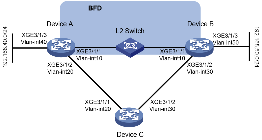

Example: Configuring BFD for static routing
As shown in Figure 2:
·     Device A has two paths to reach Device B: one over a Layer 2 switch, and the other over Device C.
·     A Layer 2 switch connects Device A and Device B.
Because Device B does not support BFD, enable BFD echo packet mode on Device A. When the link between Device B and the Layer 2 switch fails, Device A switches the path over Device C to reach Device B.

1.     Verify the configuration when Device A and Device B and the link between them are operating correctly:
# Display static route information on Device A.
[DeviceA] display ip routing-table protocol static
Summary Count : 1
Static Routing table Status : <Active>
Summary Count : 1
192.168.50.0/24     Static 60   0            192.168.10.102  XGE3/1/1
Static Routing table Status : <Inactive>
Summary Count : 0
The output shows that Device A communicates with Device B through the Layer 2 switch.
 LD/RD          SourceAddr      DestAddr        State    Holdtime    Interface
 67             192.168.10.101  192.168.10.102  Up       300ms       XGE3/1/1
2.     Verify the configuration when the link between Device B and the Layer 2 switch is faulty:
Summary Count : 1
Summary Count : 1
192.168.50.0/24     Static 65   0            192.168.20.102  XGE3/1/2
Summary Count : 0
The output shows that Device A communicates with Device B through Device C.

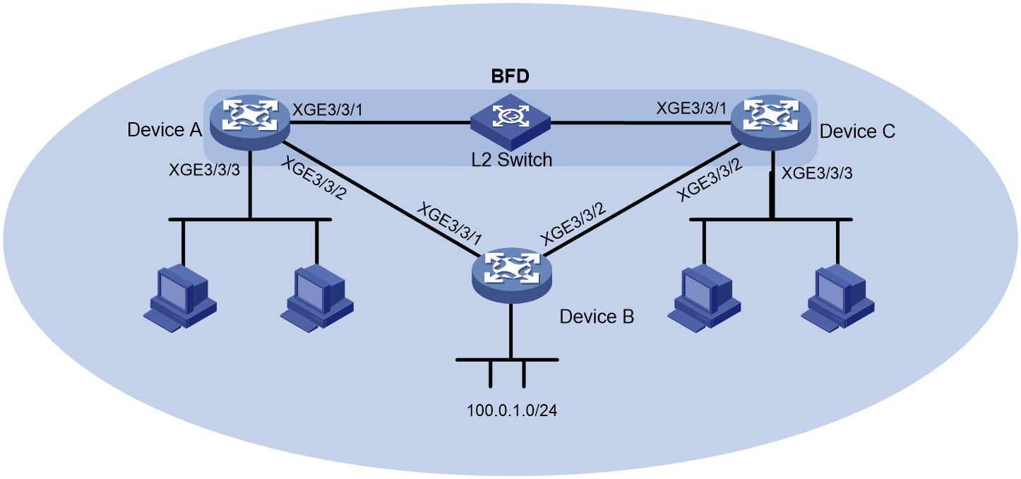

Example: Configuring BFD for RIP
As shown in Figure 3, Device A, Device B, and Device C run RIP. Device A and Device C are connected through a Layer 2 switch.
Enable BFD echo packet mode on Device A (Device C does not support BFD) to monitor the path over the Layer 2 switch. When BFD detects a link failure, it notifies RIP to switch to the path over Device B.

XGE3/1/1
10.1.0.101/24
Device A
XGE3/1/2
192.168.0.101/24
Device A
XGE3/1/3
120.1.1.1/24
Device B
XGE3/1/1
192.168.0.102/24
Device B
XGE3/1/2
13.1.1.101/24
Device C
XGE3/1/1
10.1.0.102/24
Device C
XGE3/1/2
13.1.1.102/24
Device C
XGE3/1/3
121.1.1.1/24
Procedures
[DeviceA-Ten-GigabitEthernet3/1/1] ip address 10.1.0.101 24
Configuring RIP
# Configure basic RIP functions, import direct routes, and enable BFD for RIP.
[DeviceA] rip 1
[DeviceA-rip-1] version 2
[DeviceA-rip-1] undo summary
[DeviceA-rip-1] network 10.1.0.0
[DeviceA-rip-1] network 192.168.0.0
[DeviceA-rip-1] import-route direct
[DeviceA-rip-1] quit
[DeviceA-Ten-GigabitEthernet3/1/1] rip bfd enable
# Configure basic RIP functions, and import direct routes.
<DeviceB> system-view
[DeviceB] rip 1
[DeviceB-rip-1] version 2
[DeviceB-rip-1] undo summary
[DeviceB-rip-1] network 192.168.0.0
[DeviceB-rip-1] network 13.1.1.0
[DeviceB-rip-1] import-route direct
[DeviceB-rip-1] quit
3.     Configure Device C:
<DeviceC> system-view
[DeviceC] rip 1
[DeviceC-rip-1] version 2
[DeviceC-rip-1] undo summary
[DeviceC-rip-1] network 10.1.0.0
[DeviceC-rip-1] network 13.1.1.0
[DeviceC-rip-1] import-route direct
[DeviceC-rip-1] quit
Configuring BFD parameters on Device A
[DeviceA] bfd echo-source-ip 11.11.11.11
# Configure the minimum interval for receiving BFD echo packets and the single-hop detection time multiplier.
[DeviceA-Ten-GigabitEthernet3/1/1] bfd min-echo-receive-interval 100
[DeviceA-Ten-GigabitEthernet3/1/1] bfd detect-multiplier 3
[DeviceA] display bfd session verbose
       Local Discr: 2049
         Source IP: 10.1.0.101         Destination IP: 10.1.0.102
     Session State: Up                      Interface: Ten-GigabitEthernet3/1/1
         Hold Time: 300ms                Act Tx Inter: 100ms
      Min Rx Inter: 100ms                Detect Inter: 300ms
          Rx Count: 464                      Tx Count: 465
      Connect Type: Direct             Running Up for: 00:00:46
       Detect Mode: Async                        Slot: 0
          Protocol: RIP
         Diag Info: No Diagnostic
The output shows that a BFD session has been established and is up.
# Display information about the routes to network 121.1.1.0/24 on Device A.
<DeviceA> display ip routing-table 121.1.1.0 24 verbose
Summary Count : 1
Destination: 121.1.1.0/24
   Protocol: RIP             Process ID: 1
  SubProtID: 0x1                    Age: 04h20m37s
       Cost: 1               Preference: 100
        Tag: 0                    State: Active Adv
  OrigTblID: 0x0                OrigVrf: default-vrf
    TableID: 0x2                 OrigAs: 0
      NBRID: 0x26000002          LastAs: 0
     AttrID: 0xffffffff        Neighbor: 10.1.0.102
      Flags: 0x1008c        OrigNextHop: 10.1.0.102
      Label: NULL           RealNextHop: 10.1.0.102
    BkLabel: NULL             BkNextHop: N/A
  Tunnel ID: Invalid          Interface: Ten-GigabitEthernet3/1/1
BkTunnel ID: Invalid        BkInterface: N/A
The output shows that Device A communicates with Device C through the Layer 2 switch.
# When the link between Device C and the Layer 2 switch fails, view BFD log information.
%Oct  9 18:42:17:650 2013 Device A BFD/5/BFD_CHANGE_FSM: -MDC=1;Sess[10.1.0.101/10.1.0.102, LD/RD:2049/2049, Interface: Ten-GigabitEthernet3/1/1, SessType:Echo, LinkType:INET] , Sta: UP-> DOWN, Diag:1
The output shows that BFD can quickly detect the failure and notify RIP.
Summary Count : 1
   Protocol: RIP             Process ID: 2
       Cost: 2               Preference: 100
     AttrID: 0xffffffff        Neighbor: 192.168.0.102
      Flags: 0x1008c        OrigNextHop: 192.168.0.102
      Label: NULL           RealNextHop: 192.168.0.102
  Tunnel ID: Invalid          Interface: Ten-GigabitEthernet3/1/2
The output shows that Device A communicates with Device C through Device B.

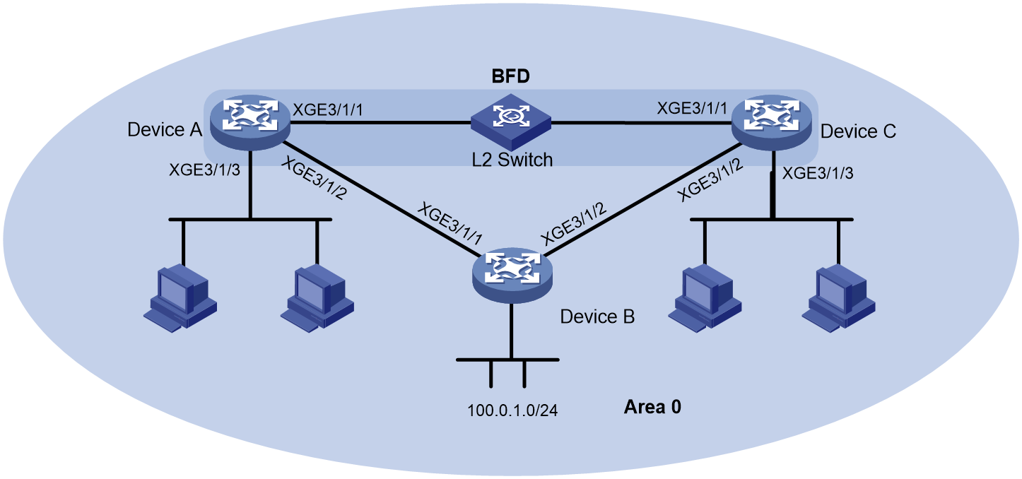

Example: Configuring BFD for OSPF
As shown in Figure 4, Device A, Device B, and Device C run OSPF. Device A and Device C are connected through a Layer 2 switch.
Enable BFD control packet mode on Device A and Device C to monitor the path over the Layer 2 switch. When BFD detects a link failure, it notifies OSPF to switch to the path over Device B.
Figure 4 Network diagram
Table 3 Interface and IP address assignment
Device
Interface
IP address
Device A
XGE3/1/1
10.1.0.101/24
Device A
XGE3/1/2
192.168.0.101/24
Device A
XGE3/1/3
120.1.1.1/24
Device B
XGE3/1/1
192.168.0.102/24
Device B
XGE3/1/2
13.1.1.101/24
Device C
XGE3/1/1
10.1.0.102/24
Device C
XGE3/1/2
13.1.1.102/24
Device C
XGE3/1/3
121.1.1.1/24
Procedures
Configuring OSPF
# Configure basic OSPF functions, and enable BFD for OSPF.
[DeviceA] ospf
[DeviceA-ospf-1] area 0
[DeviceA-ospf-1-area-0.0.0.0] network 10.1.0.0 0.0.0.255
[DeviceA-ospf-1-area-0.0.0.0] network 192.168.0.0 0.0.0.255
[DeviceA-ospf-1-area-0.0.0.0] network 120.1.1.0 0.0.0.255
[DeviceA-ospf-1-area-0.0.0.0] quit
[DeviceA-ospf-1] quit
[DeviceA-Ten-GigabitEthernet3/1/1] ospf bfd enable
# Configure basic OSPF functions.
[DeviceB] ospf
[DeviceB-ospf-1] area 0
[DeviceB-ospf-1-area-0.0.0.0] network 192.168.0.0 0.0.0.255
[DeviceB-ospf-1-area-0.0.0.0] network 13.1.1.0 0.0.0.255
[DeviceB-ospf-1-area-0.0.0.0] quit
[DeviceB-ospf-1] quit
[DeviceC] ospf
[DeviceC-ospf-1] area 0
[DeviceC-ospf-1-area-0.0.0.0] network 10.1.0.0 0.0.0.255
[DeviceC-ospf-1-area-0.0.0.0] network 13.1.1.0 0.0.0.255
[DeviceC-ospf-1-area-0.0.0.0] network 121.1.1.0 0.0.0.255
[DeviceC-ospf-1-area-0.0.0.0] quit
[DeviceC-ospf-1] quit
[DeviceC] interface ten-gigabitethernet 3/1/1
[DeviceC-Ten-GigabitEthernet3/1/1] ospf bfd enable
[DeviceC-Ten-GigabitEthernet3/1/1] quit
# Configure the session establishment mode as active (this is the default mode).
[DeviceA] bfd session init-mode active
# Configure the minimum interval for sending and receiving single-hop BFD control packets and the single-hop detection time multiplier.
[DeviceA-Ten-GigabitEthernet3/1/1] bfd min-transmit-interval 100
[DeviceA-Ten-GigabitEthernet3/1/1] bfd min-receive-interval 100
2.     Configure Device C:
[DeviceC] bfd session init-mode active
[DeviceC-Ten-GigabitEthernet3/1/1] bfd min-transmit-interval 100
[DeviceC-Ten-GigabitEthernet3/1/1] bfd min-receive-interval 100
[DeviceC-Ten-GigabitEthernet3/1/1] bfd detect-multiplier 3
# Ping host C (connected to Device C) from host A (connected to Device A) to verify the connectivity.
<host A> ping 121.1.1.2
PING 121.1.1.2 (121.1.1.2): 56 data bytes
56 bytes from 121.1.1.2: seq=0 ttl=128 time=22.43 ms
56 bytes from 121.1.1.2: seq=1 ttl=128 time=7.17 ms
56 bytes from 121.1.1.2: seq=2 ttl=128 time=8.91 ms
56 bytes from 121.1.1.2: seq=3 ttl=128 time=7.45 ms
56 bytes from 121.1.1.2: seq=4 ttl=128 time=9.11 ms
--- 121.1.1.2 ping statistics ---
The output shows that host C can be pinged successfully.
# Display detailed OSPF neighbor information on Device A.
[DeviceA] display ospf peer verbose
          OSPF Process 1 with Router ID 2.2.2.2
                  Neighbors
 Area 0.0.0.0 interface 10.1.0.101(Ten-GigabitEthernet3/1/1)'s neighbors
 Router ID: 1.1.1.1          Address: 10.1.0.102       GR State: Normal
   State: Full  Mode: Nbr is Slave  Priority: 1
   DR: 10.1.0.101  BDR: 10.1.0.102  MTU: 0
   Options is 0x42 (-|O|-|-|-|-|E|-)
   Dead timer due in 39  sec
   Neighbor is up for 00:09:01
   Authentication Sequence: [ 0 ]
   Neighbor state change count: 5
   BFD status: Enabled(Control mode)
The output shows that Device A has established OSPF neighbor relationship with Device C.
# Display BFD session information on Device A and Device C.
 Total session number: 1   Up session number: 1   Init mode: Active
 IPv4 session working under Ctrl mode:
     Local Discr: 10                  Remote Discr: 1
 Min Trans Inter: 100ms            Act Trans Inter: 100ms
  Min Recv Inter: 100ms           Act Detect Inter: 300ms
          Rx Count: 3971                     Tx Count: 3776
      Connect Type: Direct             Running Up for: 00:06:52
         Hold Time: 300ms                   Auth mode: None
        Protocol: OSPF
[DeviceC] display bfd session verbose
     Local Discr: 1                   Remote Discr: 10
       Source IP: 10.1.0.102        Destination IP: 10.1.0.101
  Min Recv Inter: 100ms           Act Detect Inter: 100ms
          Rx Count: 3                     Tx Count: 3
        Protocol: OSPF
The output shows that BFD sessions have been established and are up.
<DeviceA> display ip routing-table 121.1.1.0 verbose
Summary Count : 1
Destination: 120.1.1.0/24
   Protocol: OSPF            Process ID: 1
     AttrID: 0xffffffff        Neighbor: 0.0.0.0
%Apr  2 11:34:26:880 2014 DeviceA BFD/5/BFD_CHANGE_FSM: Sess[10.1.0.101/10.1.0.102,1026/1026, Ten-GigabitEthernet3/1/1,Ctrl] , Sta: UP-> DOWN, Diag: 5
%Apr  2 11:34:27:011 2014 DeviceA OSPF/5/OSPF_NBR_CHG: OSPF 1 Neighbor 10.1.0.102 Ten-GigabitEthernet3/1/1) from Full to Down.
The output shows that BFD can quickly detect the failure and notify OSPF.

Example: Configuring BFD for IS-IS
As shown in Figure 5, Device A, Device B, and Device C run IS-IS. Device A and Device C are connected through a Layer 2 switch.
Enable BFD control packet mode on Device A and Device C to monitor the path over the Layer 2 switch. When BFD detects a link failure, it notifies IS-IS to switch to the path over Device B.
Figure 5 Network diagram
Table 4 Interface and IP address assignment

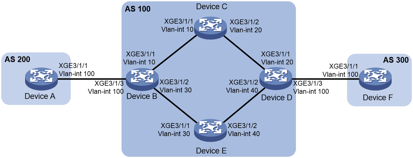

Example: Configuring BFD for BGP
As shown in Figure 6, the devices in AS 100 run OSPF to reach each other. There are two paths between Device B and Device D:
·     Path A—Path over Device C.
·     Path B—Path over Device E.
When both paths are available, BGP uses the path over Device C to forward traffic between Device A and Device F.
Enable BFD control packet mode on Device B and Device D to monitor the path over Device C. When BFD detects a link failure, it notifies BGP to switch to the path over Device E.
Figure 6 Network diagram

Device D
XGE3/1/1
10.2.0.101/24
Device D
XGE3/1/2
13.1.1.101/24
Device D
XGE3/1/3
120.2.0.2/24
Device E
XGE3/1/1
192.168.0.102/24
Device E
XGE3/1/2
13.1.1.102/24
Device F
XGE3/1/1
120.2.0.1/24
Analysis
For Path A to become the primary path, use a routing policy to set a lower cost for Path A than Path B.
In BFD control packet mode, a minimum of one end must operate in active mode for a BFD session to be established.
Procedures
[DeviceA-Ten-GigabitEthernet3/1/1] ip address 120.1.0.1 24
Configuring OSPF in AS 100
1.     Configure Device B:
[DeviceB] ospf
[DeviceB-ospf-1] import-route direct
[DeviceB-ospf-1-area-0.0.0.0] network 10.1.0.0 0.0.0.255
[DeviceC] ospf
[DeviceC-ospf-1-area-0.0.0.0] network 10.2.0.0 0.0.0.255
3.     Configure Device D:
[DeviceD] ospf
[DeviceD-ospf-1] import-route direct
[DeviceD-ospf-1] area 0
[DeviceD-ospf-1-area-0.0.0.0] network 10.2.0.0 0.0.0.255
[DeviceD-ospf-1-area-0.0.0.0] network 13.1.1.0 0.0.0.255
[DeviceD-ospf-1-area-0.0.0.0] quit
[DeviceD-ospf-1] quit
4.     Configure Device E:
[DeviceE] ospf
[DeviceE-ospf-1] area 0
[DeviceE-ospf-1-area-0.0.0.0] network 13.1.1.0 0.0.0.255
[DeviceE-ospf-1-area-0.0.0.0] network 192.168.0.0 0.0.0.255
[DeviceE-ospf-1-area-0.0.0.0] quit
[DeviceE-ospf-1] quit
Configuring BGP
# Enable BGP and set the local AS number to 200.
[DeviceA] bgp 200
[DeviceA-bgp-default] router-id 1.1.1.1
# Establish an EBGP connection with Device B.
[DeviceA-bgp-default] peer 120.1.0.2 as-number 100
# Create the BGP IPv4 unicast address family and enter its view.
[DeviceA-bgp-default] address-family ipv4 unicast
# In BGP IPv4 unicast address family view, inject local network 120.1.0.0/24 to the BGP routing table.
[DeviceA-bgp-default-ipv4] network 120.1.0.0 255.255.255.0
# Enable BGP to exchange IPv4 unicast routing information with peer 120.1.0.2.
[DeviceA-bgp-default-ipv4] peer 120.1.0.2 enable
[DeviceA-bgp-default-ipv4] quit
# Enable BGP and set the local AS number to 100.
[DeviceB] bgp 100
[DeviceB-bgp-default] router-id 2.2.2.2
# Establish an EBGP connection with Device A.
[DeviceB-bgp-default] peer 120.1.0.1 as-number 200
# Establish IBGP connections with Device D.
[DeviceB-bgp-default] peer 10.2.0.101 as-number 100
[DeviceB-bgp-default] peer 13.1.1.101 as-number 100
[DeviceB-bgp-default] address-family ipv4 unicast
# Enable BGP to exchange IPv4 unicast routing information with peer 10.2.0.101.
[DeviceB-bgp-default-ipv4] peer 10.2.0.101 enable
# In BGP IPv4 unicast address family view, specify the device as the next hop for routes sent to peer 10.2.0.101.
[DeviceB-bgp-default-ipv4] peer 10.2.0.101 next-hop-local
# Enable BGP to exchange IPv4 unicast routing information with peer 13.1.1.101.
[DeviceB-bgp-default-ipv4] peer 13.1.1.101 enable
# In BGP IPv4 unicast address family view, specify the device as the next hop for routes sent to peer 13.1.1.101.
[DeviceB-bgp-default-ipv4] peer 13.1.1.101 next-hop-local
# Enable BGP to exchange IPv4 unicast routing information with peer 120.1.0.1.
[DeviceB-bgp-default-ipv4] peer 120.1.0.1 enable
[DeviceB-bgp-default-ipv4] quit
[DeviceD] bgp 100
[DeviceD-bgp-default] router-id 4.4.4.4
# Establish IBGP connections with Device B.
[DeviceD-bgp-default] peer 10.1.0.101 as-number 100
[DeviceD-bgp-default] peer 192.168.0.101 as-number 100
# Establish an EBGP connection with Device F.
[DeviceD-bgp-default] peer 120.2.0.1 as-number 300
[DeviceD-bgp-default] address-family ipv4 unicast
# Enable BGP to exchange IPv4 unicast routing information with peer 10.1.0.101.
[DeviceD-bgp-default-ipv4] peer 10.1.0.101 enable
# In BGP IPv4 unicast address family view, specify the device as the next hop for routes sent to peer 10.1.0.101.
[DeviceD-bgp-default-ipv4] peer 10.1.0.101 next-hop-local
# Enable BGP to exchange IPv4 unicast routing information with peer 192.168.0.101.
[DeviceD-bgp-default-ipv4] peer 192.168.0.101 enable
# In BGP IPv4 unicast address family view, specify the device as the next hop for routes sent to peer 192.168.0.101.
[DeviceD-bgp-default-ipv4] peer 192.168.0.101 next-hop-local
# Enable BGP to exchange IPv4 unicast routing information with peer 120.2.0.1.
[DeviceD-bgp-default-ipv4] peer 120.2.0.1 enable
[DeviceD-bgp-default-ipv4] quit
4.     Configure Device F:
# Enable BGP and set the local AS number to 300.
[DeviceF] bgp 300
[DeviceF-bgp-default] router-id 6.6.6.6
# Establish an EBGP connection with Device D.
[DeviceF-bgp-default] peer 120.2.0.2 as-number 100
[DeviceF-bgp-default] address-family ipv4 unicast
# In BGP IPv4 unicast address family view, inject local network 120.2.0.0/24 to the BGP routing table.
[DeviceF-bgp-default-ipv4] network 120.2.0.0 255.255.255.0
# Enable BGP to exchange IPv4 unicast routing information with peer 120.2.0.2.
[DeviceF-bgp-default-ipv4] peer 120.2.0.2 enable
[DeviceF-bgp-default-ipv4] quit
Configuring routing policies
# Create ACL 2000 to permit packets sourced from 120.1.0.0/24.
[DeviceB] acl basic 2000
[DeviceB-acl-ipv4-basic-2000] rule permit source 120.1.0.0 0.0.0.255
[DeviceB-acl-ipv4-basic-2000] quit
# Set a local preference of 200 for routes advertised to peer 10.2.0.101, and set the preference for IBGP routes to 100.
[DeviceB] route-policy local-pre permit node 10
[DeviceB-route-policy-local-pre-10] if-match ip address acl 2000
[DeviceB-route-policy-local-pre-10] apply local-preference 200
[DeviceB-route-policy-local-pre-10] quit
[DeviceB] bgp 100
[DeviceB-bgp-default-ipv4] peer 10.2.0.101 route-policy local-pre export
[DeviceB-bgp-default-ipv4] preference 255 100 130
[DeviceB-bgp-default] quit
2.     Configure Device D:
# Create ACL 2000 to permit packets sourced from 120.2.0.0/24.
[DeviceD] acl basic 2000
[DeviceD-acl-ipv4-basic-2000] rule permit source 120.2.0.0 0.0.0.255
[DeviceD-acl-ipv4-basic-2000] quit
# Set a local preference of 200 for routes learned from peer 10.1.0.101, and configure the preference for IBGP routes as 100.
[DeviceD] route-policy local-pre permit node 10
[DeviceD-route-policy-local-pre-10] if-match ip address acl 2000
[DeviceD-route-policy-local-pre-10] apply local-preference 200
[DeviceD-route-policy-local-pre-10] quit
[DeviceD] bgp 100
[DeviceD-bgp-default-ipv4] peer 10.1.0.101 route-policy local-pre export
[DeviceD-bgp-default-ipv4] preference 255 100 130
[DeviceD-bgp-default] quit
Configuring BFD
# Enable BFD for the link to BGP peer 10.2.0.101.
[DeviceB] bgp 100
[DeviceB-bgp-default] peer 10.2.0.101 bfd
# Enable BFD for the link to BGP peer 10.1.0.101.
[DeviceD] bgp 100
[DeviceD-bgp-default] peer 10.1.0.101 bfd
# Ping Device F from Device A to verify the connectivity.
[DeviceA] ping 120.2.0.1
Ping 120.2.0.1 (120.2.0.1): 56 data bytes, press CTRL_C to break
56 bytes from 120.2.0.1: icmp_seq=0 ttl=252 time=1.189 ms
56 bytes from 120.2.0.1: icmp_seq=1 ttl=252 time=1.095 ms
56 bytes from 120.2.0.1: icmp_seq=2 ttl=252 time=1.086 ms
56 bytes from 120.2.0.1: icmp_seq=3 ttl=252 time=1.097 ms
56 bytes from 120.2.0.1: icmp_seq=4 ttl=252 time=1.089 ms
--- Ping statistics for 120.2.0.1 ---
round-trip min/avg/max/std-dev = 1.086/1.111/1.189/0.039 ms
The output shows that Device F can be pinged successfully.
# Display BGP peer information on Device B.
[DeviceB] display bgp peer ipv4
 BGP local router ID: 2.2.2.2
 Local AS number: 100
 Total number of peers: 3                  Peers in established state: 3
  Peer                    AS  MsgRcvd  MsgSent OutQ PrefRcv Up/Down  State
  10.2.0.101             100        6        4    0       1 00:00:56 Established
  13.1.1.101             100        6        5    0       1 00:00:56 Established
  120.1.0.1              200        6        5    0       1 00:00:56 Established
·     Two IBGP connections have been established between Device B and Device D.
·     An EBGP connection has been established between Device B and Device A.
# Display detailed BFD session information on Device B.
[DeviceB] display bfd session verbose
 IPv4 Session Working Under Ctrl Mode:
       Local Discr: 2049                 Remote Discr: 0
         Source IP: 10.1.0.101         Destination IP: 10.2.0.101
     Session State: UP                      Interface: N/A
      Min Tx Inter: 1000400ms               Act Tx Inter: 1000400ms
      Min Rx Inter: 1000400ms               Detect Inter: 50002000ms
          Rx Count: 0                        Tx Count: 910
      Connect Type: Indirect           Running Up for: 00:00:00
         Hold Time: 0ms                     Auth mode: None
          Protocol: BGP
# Display information about the routes to network 120.2.0.0/24 on Device B.
[DeviceB] display ip routing-table 120.2.0.0 24 verbose
Summary Count : 3
Destination: 120.2.0.0/24
   Protocol: BGP             Process ID: 0
  SubProtID: 0x1                    Age: 00h24m48s
       Cost: 0               Preference: 100
    TableID: 0x2                 OrigAs: 300
      NibID: 0x15000001          LastAs: 300
     AttrID: 0x1               Neighbor: 10.2.0.101
      Flags: 0x10060        OrigNextHop: 10.2.0.101
  SubProtID: 0x8                    Age: 00h26m19s
       Cost: 1               Preference: 150
        Tag: 1                    State: Inactive Adv
      NibID: 0x13000005          LastAs: 0
      Flags: 0x41           OrigNextHop: 10.1.0.102
      NibID: 0x13000003          LastAs: 0
      Flags: 0x41           OrigNextHop: 192.168.0.102
The output shows that Device B communicates with Device D through path over Device C.
# When the path over Device C fails, ping Device F from Device A.
<DeviceA> ping 120.2.0.1
Ping 120.1.0.1 (120.2.0.1): 56 data bytes, press CTRL_C to break
56 bytes from 120.2.0.1: icmp_seq=0 ttl=252 time=0.680 ms
56 bytes from 120.2.0.1: icmp_seq=1 ttl=252 time=0.295 ms
56 bytes from 120.2.0.1: icmp_seq=2 ttl=252 time=0.423 ms
56 bytes from 120.2.0.1: icmp_seq=3 ttl=252 time=0.464 ms
56 bytes from 120.2.0.1: icmp_seq=4 ttl=252 time=0.445 ms
5 packets transmitted, 5 packets received, 0.0% packet loss
round-trip min/avg/max/std-dev = 0.295/0.461/0.680/0.124 ms
<DeviceB> display ip routing-table 120.2.0.0 24 verbose
Summary Count : 2
  SubProtID: 0x1                    Age: 00h00m18s

The output shows that Device B communicates with Device D through path over Device E.
Configuration files
·     Device A:
interface Ten-GigabitEthernet3/1/1
 port link-mode route
 ip address 120.1.0.1 255.255.255.0
bgp 200
 router-id 1.1.1.1
 peer 120.1.0.2 as-number 200
·     Device B:
ospf 1
import-route direct
 area 0.0.0.0
 ip address 10.1.0.101 255.255.255.0
interface Ten-GigabitEthernet3/1/2
 ip address 192.168.0.101 255.255.255.0
interface Ten-GigabitEthernet3/1/3
 ip address 120.1.0.2 255.255.255.0
bgp 100
 router-id 2.2.2.2
 peer 10.2.0.101 bfd
acl basic 2000
 rule 0 permit source 120.1.0.0 0.0.0.255
·     Device C:
ospf 1
 area 0.0.0.0
 ip address 10.1.0.102 255.255.255.0
 ip address 10.2.0.102 255.255.255.0
·     Device D:
ospf 1
 import-route direct
 area 0.0.0.0
 ip address 10.2.0.101 255.255.255.0
 ip address 13.1.1.101 255.255.255.0
bgp 100
 router-id 4.4.4.4
 peer 10.1.0.101 bfd
acl basic 2000
 rule 0 permit source 120.2.0.0 0.0.0.255
·     Device E:
ospf 1
 area 0.0.0.0
 ip address 192.168.0.102 255.255.255.0
 ip address 13.1.1.102 255.255.255.0
·     Device F:
 ip address 120.2.0.1 255.255.255.0
bgp 300
 router-id 6.6.6.6
Example: Configuring BFD for PBR
As shown in Figure 7, Device A has two paths to reach Device C:
·     Link A.
·     Link B.
Configure PBR to enable Device A to forward traffic with source IP address 40.0.0.2 over Link B.
Enable BFD echo packet mode on Device A (Device C does not support BFD) to monitor Link B. When BFD detects a link failure, Device A switches the path to Link A.
Figure 7 Network diagram
Procedures
[DeviceA] interface Ten-GigabitEthernet 3/1/2
[DeviceA-Ten-GigabitEthernet3/1/2] ip address 40.0.0.1 24
# Configure a static route to reach network 50.0.0.0.
[DeviceA] ip route-static 50.0.0.0 24 ten-gigabitethernet 3/1/1 13.13.13.2
[DeviceB] ip route-static 50.0.0.0 24 ten-gigabitethernet 3/1/2 24.24.24.4
Configuring routing policies on Device A
# Create ACL 3010 to permit packets sourced from 40.0.0.2.
[DeviceA] acl advanced 3010
[DeviceA-acl-ipv4-adv-3010] rule 0 permit ip source 40.0.0.2 0
[DeviceA-acl-ipv4-adv-3010] quit
# Create routing policy aaa to set next hop 12.12.12.2 for packets matching ACL 3010, and associate the next hop with track entry 11.
[DeviceA] policy-based-route aaa permit node 5
[DeviceA-pbr-aaa-5] if-match acl 3010
[DeviceA-pbr-aaa-5] apply next-hop 12.12.12.2 track 11
[DeviceA-pbr-aaa-5] quit
# Apply routing policy aaa to Ten-GigabitEthernet 3/1/2.
[DeviceA] interface ten-gigabitEthernet 3/1/2
[DeviceA-Ten-GigabitEthernet3/1/2] ip policy-based-route aaa
[DeviceA] bfd echo-source-ip 3.3.3.3
# Configure the minimum interval for receiving BFD echo packets and the single-hop detection time multiplier, and associate track entry 11 with BFD.
[DeviceA-Ten-GigabitEthernet3/1/3] bfd min-echo-receive-interval 100
[DeviceA-Ten-GigabitEthernet3/1/3] bfd detect-multiplier 3
[DeviceA-Ten-GigabitEthernet3/1/3] quit
[DeviceA] track 11 bfd echo interface ten-gigabitethernet 3/1/3 remote ip 12.12.12.2 local ip 12.12.12.1
# Display outbound traffic statistics for all interfaces on Device A.
<DeviceA> reset counters interface
<DeviceA> display counters outbound interface
Interface         Total (pkts)   Broadcast (pkts)   Multicast (pkts)  Err (pkts)
XGE3/1/1                     0                  0                  0           0
XGE3/1/2                     0                  0                  0           0
XGE3/1/3                     585414             0                  0           0
XGE3/1/4                     0                  0                  0           0
XGE3/1/5                     0                  0                  0           0
XGE3/1/6                     0                  0                  0           0
The output shows that the traffic sourced from 40.0.0.0 is forwarded through Ten-GigabitEthernet 3/1/3 (Link B).
       Local Discr: 2049
         Source IP: 12.12.12.1         Destination IP: 12.12.12.2
     Session State: Up                      Interface: Ten-GigabitEthernet3/1/3
      Min Tx Inter: 100ms                Act Tx Inter: 100ms
          Rx Count: 128234                   Tx Count: 371950
      Connect Type: Direct             Running Up for: 00:01:04
       Detect Mode: Async                Chassis/Slot: 1/0
          Protocol: TRACK
# When the link between Device A and Device B fails, view BFD log information.
%Dec 10 16:39:46:210 2013 DeviceA BFD/5/BFD_CHANGE_FSM: -MDC=1; Sess[12.12.12.1/
12.12.12.2, LD/RD:2049/2049, Interface: Ten-GigabitEthernet3/1/3, SessType:Echo, LinkType:INET] , S
ta: UP-> DOWN, Diag: 1
%Dec 10 16:39:47:342 2013 DeviceA IFNET/3/PHY_UPDOWN: -MDC=1; Ten-GigabitEthernet3/1/3 link status is down.
%Dec 10 16:39:47:343 2013 DeviceA IFNET/5/LINK_UPDOWN: -MDC=1; Line protocol on
the interface Ten-GigabitEthernet3/1/3 is down.
%Dec 10 16:39:47:343 2013 DeviceA IFNET/3/PHY_UPDOWN: -MDC=1; Ten-GigabitEthernet3/1/3
The output shows that the BFD session is down.
# Clear the interface statistics, and display outbound traffic statistics for all interfaces on Device A again.
XGE3/1/1                863764                  0                  0           0
XGE3/1/2                     0                  0                  0           0
XGE3/1/3                     0                  0                  0           0
XGE3/1/4                     0                  0                  0           0
XGE3/1/5                     0                  0                  0           0
XGE3/1/6                     0                  0                  0           0
The output shows that the traffic sourced from 40.0.0.0 is forwarded through Ten-GigabitEthernet 3/1/1 (Link A).
Configuration files
·     Device A:
 if-match acl 3010
 ip address 13.13.13.1 255.255.255.0
 ip address 40.0.0.1 255.255.255.0
 ip address 12.12.12.1 255.255.255.0
ip route-static 50.0.0.0 24 Ten-GigabitEthernet3/1/1 13.13.13.2
 ip local policy-based-route aaa
acl advanced 3010
 track 11 bfd echo interface Ten-GigabitEthernet3/1/3 remote ip 12.12.12.2 local ip 12.12.12.1
·     Device B:
 ip address 12.12.12.2 255.255.255.0
 ip address 24.24.24.2 255.255.255.0
ip route-static 50.0.0.0 24 Ten-GigabitEthernet3/1/2 24.24.24.4
·     Device C:
 ip address 13.13.13.2 255.255.255.0
 ip address 50.0.0.1 255.255.255.0
 ip address 24.24.24.4 255.255.255.0
