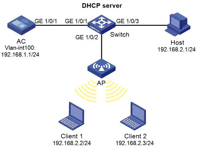

As shown in Figure 1, the DHCP server assigns IP addresses to Client 1 and the AP. Client 2 is assigned a static IPv4 address.
Configure network settings to meet the following requirements:
·     Both of the clients access the same wireless network.
·     Enable IPv4SG to generate IPv4SG bindings based on DHCP so that the AP forwards the packets only from Client 1.
Figure 1 Network diagram
When you configure a serial ID for the AP, use the serial ID labeled on the AP's rear panel.
