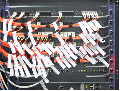

Label cables before you route or bundle them. For more information about labeling cables, see "Appendix F  Engineering labels for cables."

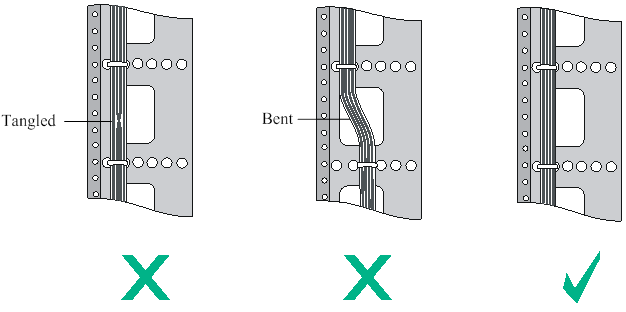

·     Use the correct ties to bind the cables. Do not bind cables with joined ties.
·     The distances between cable ties must be three to four times of the cable diameter.
·     Bind and route the cables neatly inside the rack, and make sure the cables are not kinked or bent. Do not tie cables or bundles in a knot.

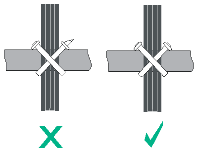

·     After binding the cables, cut the excess from the ties, leaving no sharp or angular tips. See Figure 3.
Figure 3 Cutting the cable ties

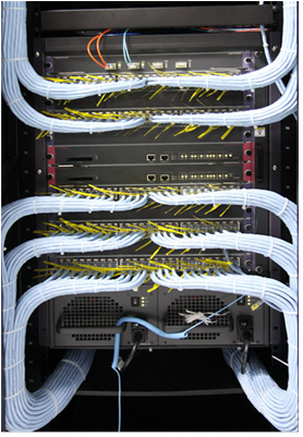

Network cable management
Figure 4 Network cable management

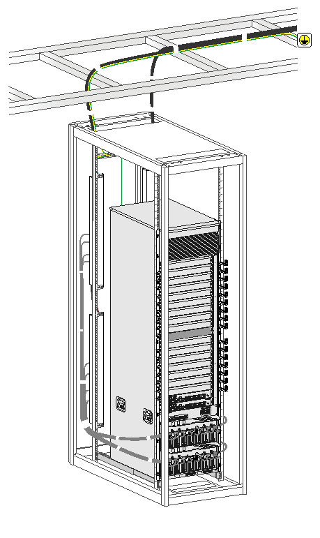

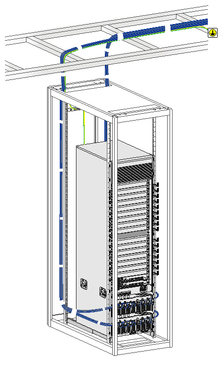

Route the power cords according to the actual conditions in the equipment room, such as the locations of power distribution cabinets, receptacles, and lightning protection boxes. When routing AC power cords, connect them to a power distribution cabinet in the equipment room through PDUs on the rack or through a grounding strip. When routing DC power cords, connect them directly to a power distribution cabinet in the equipment room.
For future device maintenance, avoid blocking the device modules, such as fan trays, when routing power cords.
Figure 6 Routing AC power cords
Figure 7 Routing DC power cords
