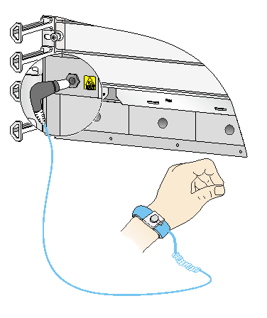

Attaching an ESD wrist strap
The router is shipped with an ESD wrist strap. To minimize ESD damage to electronic components, wear the ESD wrist strap and make sure it is reliably grounded when installing modules.
To use an ESD wrist strap:
1. Make sure the router is reliably grounded. For how to ground your router, see "Grounding the router."
2. Put on the wrist strap.
3. Tighten the wrist strap to keep good skin contact. Make sure the resistance reading between your body and the ground is between 1 and 10 megohms.
4. As shown in Figure 1, insert the ESD wrist strap into the ESD port on the router chassis, or attach it to the grounding post of the chassis with an alligator clip.
Figure 1 Attaching an ESD wrist strap

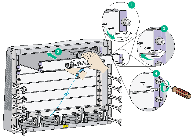

Installing MPUs/service modules/switching fabric modules
CAUTION: · Before installing a card, make sure the connectors on the card are not broken or blocked to avoid damaging the backplane. · To ensure good ventilation, install a filler panel over an empty MPU, service module, or switching fabric module slot. MPU slots and service module slots use the same type of filler panels. · The switching fabric modules for the SR8808-X, SR8812-X, SR8808H-X , and SR8816-X routers each are shipped with a protection box. Before you install these switching fabric modules, pull the ejector levers on the module outwards, and then pull the module out of the protection box. · To install a service module with a height of 52.5 mm (2.07 in) on an SR8808H-X or SR8816-X router, first remove the air duct above the service module slot. · When installing a universal open application platform on an SR8804-X, an SR8808-X, or an SR8812-X router, install the provided slot adapter above the platform. The slot adapter occupies two slots. The installation method for a slot adapter is the same as a filler panel. |
The installation procedures for MPUs, service modules, and switching fabric modules are the same. Unless otherwise stated, MPUs, service modules, and switching fabric modules are collectively referred to as "cards" in this document. These cards are hot swappable.
The card slots on the router are either horizontally oriented or vertically oriented. When installing a card in a horizontal slot, make sure its PCB faces up. When installing a card in a vertical slot, make sure its PCB faces left. The following procedure installs a card in a horizontal slot.
To install a card in a horizontal slot:
1. Wear an ESD wrist strap, and make sure it makes good skin contact and is reliably grounded. For more information, see "Attaching an ESD wrist strap."
2. Remove the filler panel (if any) from the target slot.
Keep the filler panel secure for future use.
Some card slots do not have a filler panel. The figures in this section are for illustration only.
3. Press the ejector levers down so that they are vertical to the front panel. (This step applies only to ejector levers similar to those on a CSPEX-1504X card.)
4. Hold the card by the front panel with one hand and support the card bottom with the other. Slide the card steadily into the slot along the guide rails.
5. When most part of the card is inserted in the slot, pull the ejector levers on the card outward.
6. Push the card until the positioning pin on card touches the hole on the chassis.
7. Press the ejector levers inward until the ejector levers touch the panel tightly and the card seats into the backplane
8. Push the ejector levers up to its original position. (This step applies only to ejector levers similar to those on a CSPEX-1504X card.)
9. Fasten the captive screws on the card.
10. When the router is powered on, check the running status of the card.

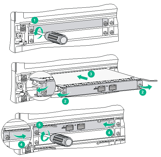

Installing a subcard
CAUTION: · To ensure good ventilation, install filler panels in unused slots. · All subcards except for the MIC-SM are hot swappable. |
This section describes how to install a subcard on an SPEX or MPE base card. A base card and a card use the same installation procedure. For the card installation procedure, see "Installing MPUs/service modules/switching fabric modules".
To install a subcard:
1. Wear an ESD wrist strap and make sure it makes good skin contact and is reliably grounded. For more information, see "Attaching an ESD wrist strap."
2. Identify whether the subcard is hot swappable.
¡ If the subcard is not hot swappable, make sure the base card is powered off.
¡ If the subcard is hot swappable, make sure the base card is installed on the router.
3. Unpack the subcard.
4. Remove the filler panel (if any) from the target slot on the base card.
Keep the removed filler panel secure for future use.
5. Open the ejector levers of the subcard, and gently push the subcard (with bottom up) into the slot along the guide rails until the ejector levers of the subcard touch the base card panel.
6. Push the front panel of the subcard forward. Then close the ejector levers so that the subcard is flush with the base card.
7. Use a Phillips screwdriver to fasten the screws on the subcard.
Figure 3 Installing a subcard

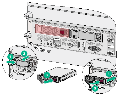

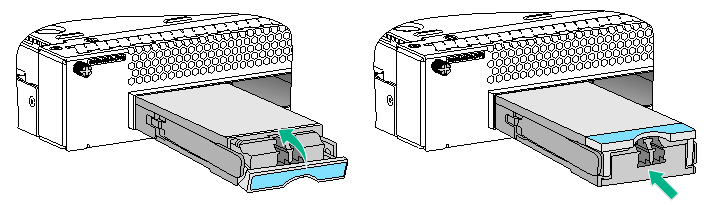

Installing a hard disk
2. Make sure a universal open application platform is installed in the router.
3. Unpack the hard disk.
4. Remove the filler panel from the slot to be used.
5. Press the button on the filler panel to the right and pull the filler panel outward.
Keep the removed filler panels for future use.
6. Press the button on the hard disk panel. The hard disk panel will open automatically.
7. Gently push the hard disk in along the guide rails.
8. Close the hard disk panel after the hard disk clicks into place.
Figure 4 Installing the hard disk

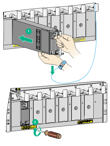

Installing a power supply
CAUTION: · Provide a circuit breaker for each power supply and make sure the circuit breaker is off before installation. · Do not install power supplies of different models on the same router. · When moving the power supply, support the bottom of the power supply, instead of holding its handle to avoid damaging the power supply. · To avoid bodily injury, strictly follow the procedure in Figure 5 to install a power supply. |
The router uses N + 1 or N + N power redundancy and supports AC or DC power input.
The power supply slots are horizontal on an SR8804-X router and vertical on SR8808-X, SR8812-X, SR8808H-X and SR8816-X routers.
Figure 5 Power supply installation flow
The installation procedure is the same for AC and DC power supplies. The following procedure installs an AC power supply.
Some power supply slots do not have a filler panel. The figures in this section are for illustration only.
To install a power supply:
2. Remove the filler panel, if any, from the power supply slot.
¡ If the filler panel has captive screws, use a Phillips screwdriver to loosen the captive screws on the filler panel first and then remove the filler panel.
¡ If the filler panel does not have captive screws, pull out the fill panel directly.
3. Unpack the power supply.
4. Grasping the power supply handle with one hand and supporting the power supply bottom with the other, push the power supply along the guide rails into the slot.
5. Press the handle inward until the handle seats into the slot.
6. Use a Phillips screwdriver to fasten the captive screw on the handle to attach the power supply.
Figure 6 Installing a power supply in a vertical slot (SR8808-X)

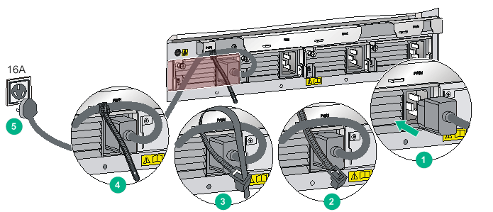

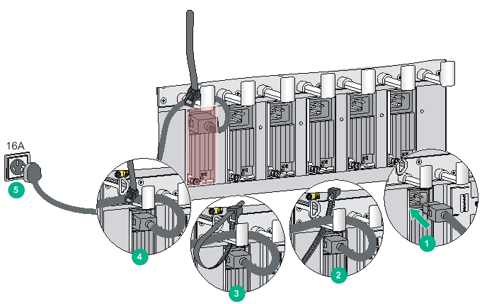

Connecting an AC power cord
WARNING! Before you connect an AC power cord, make sure the circuit breaker for the power cord is turned off. |
To connect an AC power cord:
1. Connect the power cord to the power receptacle on the power supply.
2. Use a releasable cable tie to secure the power cord to the cable management bracket.
¡ For the SR8808-X, SR8812-X, SR8808H-X and SR8816-X routers with vertical power supply slots, see Figure 7 to secure the power cord.
For the SR8808H-X or SR8816-X router, each hook on the cable management bracket has a cutout. You can also feed the cable tie through the cutout to secure the power cord.
¡ For the SR8804-X router with horizontal power supply slot, see Figure 8 to secure the power cord.
3. Connect the other end of the power cord to the AC power receptacle of the power source and switch on the circuit breaker.
4. Verify the power supply input status LED.
If the LED is on, the power cord is correctly connected. For description of power supply status LEDs, see "Appendix C LEDs."
Figure 7 Securing the power cord (vertical slot)
Figure 8 Securing the power cord (horizontal slot)

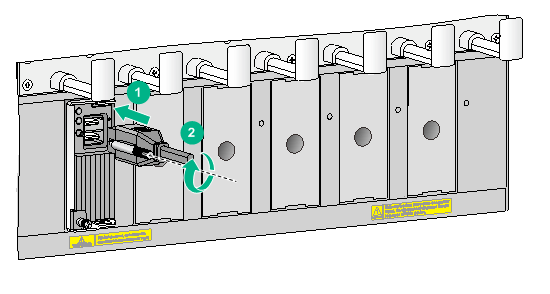

Connecting a DC power cord
WARNING! · Make sure each DC power cord has a separate circuit breaker. · Before you connect a DC power cord, make sure the DC power source circuit breakers are turned off. |

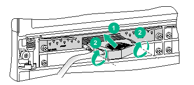

Connecting a DC power cord to an LSUM1DC2400 or PSR2400-12D power supply
1. Connect the power cord to the power receptacle of the power supply.
2. Fasten the screw to secure the power cord.
Figure 9 Connecting a power cord to an LSUM1DC2400 or PSR2400-12D power supply (vertical slot)
3. (Optional) Use a cable tie to secure the power cord to the cable management bracket.
The same method is used for securing AC and DC power cords. For information about securing a DC power cord, see "Connecting an AC power cord."

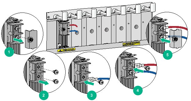

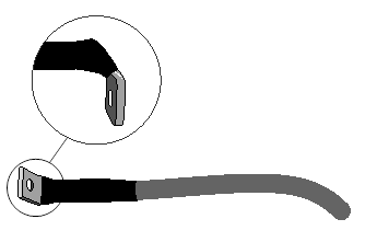

4. Connect the other end of the DC power cord to a DC power source, with the wire marked with –48V connected to the negative terminal (–48V) and the wire marked with RTN connected to the positive terminal (RTN).
Connecting a DC power cord to a PSR2400-D power supply
WARNING! A DC power cord includes a negative wire and a positive wire. When connecting the power cord to the power source, make sure the circuit breaker switches for the positive wire and the negative wire are both turned off. |
IMPORTANT: To meet the current requirements and match the terminals on the PSR2400-D power supplies, use the power cords or power cord lugs provided by H3C. |
To connect a DC power cord to a PSR2400-D power supply:
1. Use a Phillips screwdriver to loosen the screw on the terminal protection cover and then remove the protection cover from the power supply.
2. Use a Phillips screwdriver to loosen the screws on the wiring terminals.
3. Connect the DC power cord to the power supply.
a. Connect the wire marked with – to the positive terminal (–) on the power supply and fasten the screw.
b. Connect the wire marked with + to the positive terminal (+) on the power supply and fasten the screw.
Use a heat-shrink tubing to cover the joint between the lug and the power wire. Make sure the heat-shrink tubing wraps the root of the lug.
Figure 10 Covering the joint with the heat-shrink tubing
4. Place the protection cover over the wiring terminals and fasten the screw.
Figure 11 Connecting a power cord to a PSR2400-D power supply (vertical slot)
5. Connect the end of the DC power cord to a DC power source, with the wire marked with – connected to the terminal marked with –48V(–) and the wire marked with + connected to the terminal marked with RTN (+).

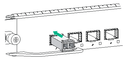

Installing an XFP/QSFP+/QSFP28/SFP28/SFP+/SFP transceiver module
The installation procedure is similar for XFP, QSFP+, QSFP28, SFP28, SFP+, and SFP transceiver modules. The following uses an SFP+ transceiver module for illustration.
To install an SFP+ transceiver module:
2. Remove the dust plug from the target fiber port.
3. Unpack the transceiver module.
4. As shown in Figure 12, close the bail latch upward to catch the knob on the top of the transceiver module. Then correctly orient the transceiver module and align it with the fiber port, and push it gently into the port until you feel it snap into place.
Transceiver modules and fiber ports have disorientation rejection designs. If you cannot insert a transceiver module easily into a port, the orientation might be wrong. Remove and reorient the transceiver module.
In case of limited space, you can gently push against the front face of the transceiver module instead of the two sides.
5. If you are not to install an optical fiber, insert a dust plug into the transceiver module bore.
6. Connect a fiber to the module. For the installation procedure, see "Connecting your router to the network through optical fibers."
Figure 12 Installing an SFP+ transceiver module

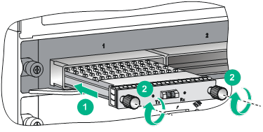

Installing a CFP transceiver module
3. Unpack the CFP module.
4. As shown in Figure 13, correctly orient the transceiver module and align it with the fiber port. Push it gently into the port until you feel it snaps into place.
5. Fasten the captive screws on the transceiver module to secure it in place.
If a screw cannot be fastened, adjust the CFP transceiver module and the screw and re-fasten the screw, or remove the CFP transceiver module and then reinstall it.
Figure 13 Installing a CFP transceiver module
Installing a CFP2 transceiver module
2. Unpack the CFP2 transceiver module.
3. Pivot the module handle up onto the top of the module and orient the module with the handle above the ports. Gently push the module into the port until the spring tabs on the two sides of the module click into place. See Figure 14.
Figure 14 Installing a CFP2 transceiver module
Connecting an E1 cable
2. Connect the HD96 connector of the E1 cable to the interface on the subcard and use a screwdriver to fasten the screws on the connector.
3. Connect the other end of the E1 cable to the peer device.
Figure 15 Installing an E1 cable
