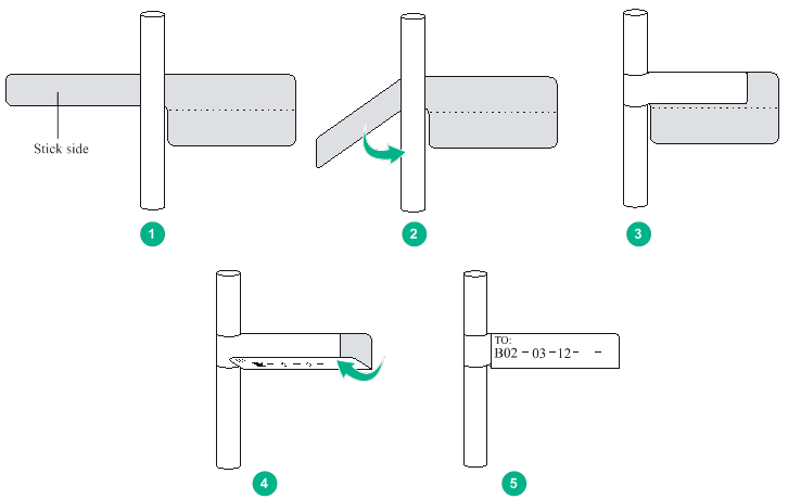

Labels for signal cables

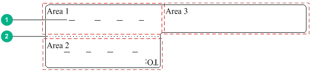

A label for signal cables is L-shaped with fixed dimensions. The light-blue dividing lines on the label help to specify more clearly the position of the cable. For example, there is one dividing line between the rack number and the chassis number and another one between the chassis number and the slot number. The cut dotted line helps to fold the label when you affix it to the cable. A mark "TO:" is located at the lower right corner of the label to identify the peer end of the cable on which the label is affixed.
As shown in Figure 1, write a signal cable label as follows:
· Write the position of the cable in Area 1.
· Write the position of the cable on the peer end in Area 2.
· Area 3 is the part that is folded up inside the label when the label is affixed to the cable.
Figure 1 Label for signal cables
(1) Dividing line |
(2) Cut dotted line |

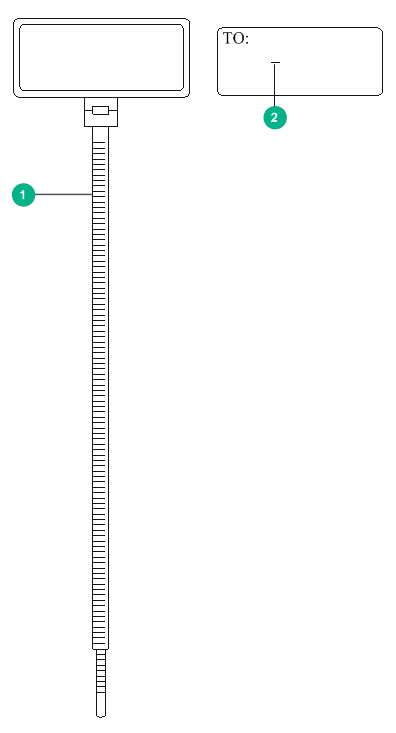

Labels for power cords
A label for power cords should be attached to the identification plate on a cable tie that binds the power cords. The identification plate has an embossment of 0.2 × 0.6 mm (0.008 × 0.02 in) around (symmetric on both sides), and the area in the middle is for affixing the label.
A mark "TO:" is located at the upper left corner of the label to identify the peer end of the cable on which the label is affixed. You can write the position of the peer device, control cabinet, distribution box, or power socket. The meaning of the dividing lines is the same as labels for signal cables.
Figure 2 Label for power cords
(1) Cable tie |
(2) Dividing line on the label |

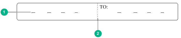

A generic label is bar-shaped with fixed dimensions. It is applicable to both signal cables and power cords. A mark "TO:" is located at the upper left corner in the right area of the label to identify the peer end of the cable on which the label is affixed. The meaning of the dividing lines is the same as labels for signal cables.
Figure 3 Generic label
(1) Dividing line on the label |

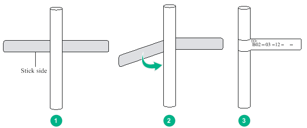

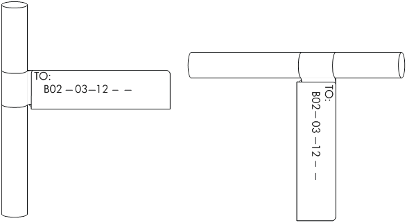

Affixing a label to a signal cable
Typically, a label is affixed 2 cm (0.79 in) away from the connector on a signal cable. You can affix the label to other positions as needed. Figure 4 shows how to affix a label when a cable is laid vertically.

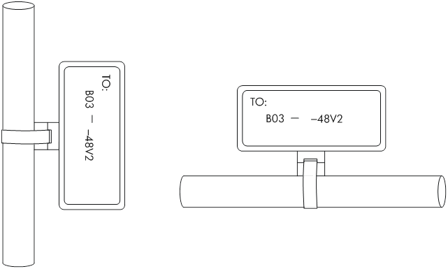

Figure 5 shows the affixed labels when the cable is laid vertically and horizontally.
Figure 5 Affixed labels
Affixing a label to a power cord
Stick the label to the recessed rectangular area on the identification plate. You can stick the label to either side of the identification plate. Be sure to affix the labels on the same side of the identification plates.
A cable tie is bundled 2 cm (0.79 in) away from the connector. You can affix the label to other positions as needed. Figure 6 shows how to affix a label when a cable is laid horizontally.
Bind cable ties on both ends of a cable. After the bundling, the finished identification plate should be on top of the cable in horizontal cabling, or on the right side of the cable in vertical cabling. Make sure the label is facing out, as shown in Figure 7.

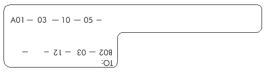

Figure 9 Example of a label on an Ethernet cable
· A01-03-10-05—The local end of the Ethernet cable is connected to Ethernet Port 05, Slot 10, Chassis 03 of the rack on Row A, Column 01 in the equipment room.
· B02-03-12—The peer end of the Ethernet cable is connected to Ethernet Port 12, Chassis 03 of the rack on Row B, Column 02 in the equipment room.

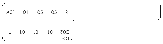

Figure 10 Example of a label on an optical fiber between two devices
· A01-01-05-05-R—The local end of the optical fiber is connected to Optical Receiving Interface 05 on Slot 5, Chassis 01 in the rack on Row A, Column 01 in the equipment room.
· G01-01-01-01-T—The peer end of the optical fiber is connected to Optical Transmitting Interface 01 on Slot 01, Chassis 01 in the rack on Row G, Column 01 in the equipment room

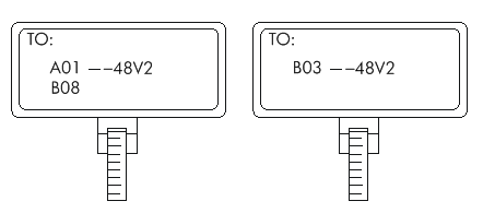

Figure 12 Example of labels on a DC power cord
· A01/B08––48V2 (loaded cabinet side)—The cable is –48V2 DC supply, which is from the 8th connecter on the second row of –48V bus bar in the cabinet on Row A, and Column 1 in the equipment room.
· B03––48V2 (distribution box side)—The cable is –48V2 DC supply, which is from the loaded cabinet on Row B, Column 03 in the equipment room.

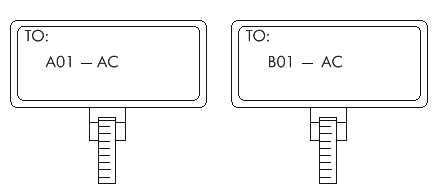

Engineering labels for AC power cords
These labels are affixed to the AC cables that provide power for cabinets and protection grounding cables, including POWER, RTN, and PGND cables. The 220 VAC cables and related PGND and RTN cables are covered with insulating sheath, so the labels only need to contain "AC" and the cabinet number. The labels for AC power cords are affixed to one side of the identification plates on cable ties.
Table 5 Information on labels affixed to AC power cords
Content |
Meaning |
MN-AC |
MN: Rack number (row number and column number in the equipment room) or the location of the socket where the power is led in. The location of the socket is marked according to onsite situation. If the sockets can be identified by row number and column number, they can be numbered following the same rule for the rack number. Otherwise, specify the detailed locations to avoid confusing with other sockets. |
The label only carries location information about the peer equipment and the power socket, while information of the local end is not necessary. Make sure labels are affixed in the correct direction. That is, after the cable ties are bundled onto the cable, the identification plates with the labels should face up, and the text on the labels in the same cabinet must be in the same direction, as shown in Figure 13:
Figure 13 Example of labels on an AC power cord
· A01-AC (loaded cabinet side)—The power cord is connected to the socket of Row A and Column 01 in the equipment room.
· B01-AC (power socket side)—The power cord is connected to the loaded cabinet of Row B, Column 01 in the equipment room.
