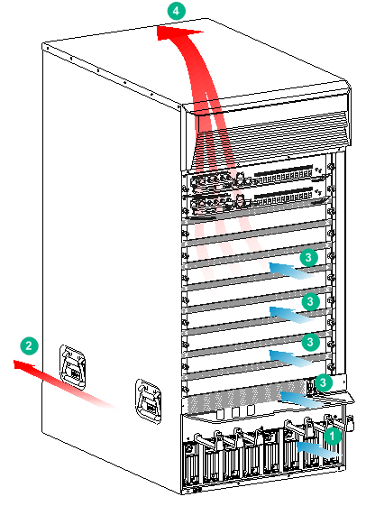

Figure 1 describes the airflow through the SR8808-X chassis. Figure 2 describes the airflow through the SR8808H-X chassis. Figure 3 describes the airflow through the SR8816-X chassis. Figure 4 describes the airflow through the other models.
Figure 1 Airflow through the SR8808-X chassis
(1) Direction of the airflow into the power supplies |
(2) Direction of the airflow out of the power supplies |
(3) Direction of the airflow into the chassis |
(4) Direction of the airflow out of the chassis |

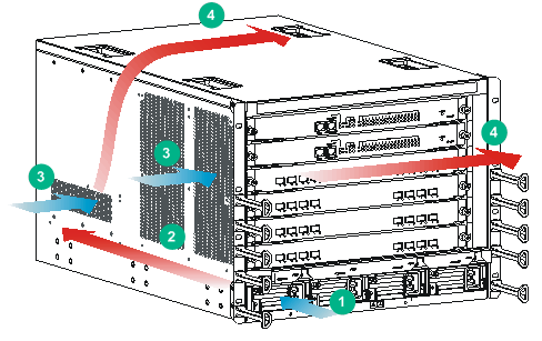

Figure 2 Airflow through the SR8808H-X chassis

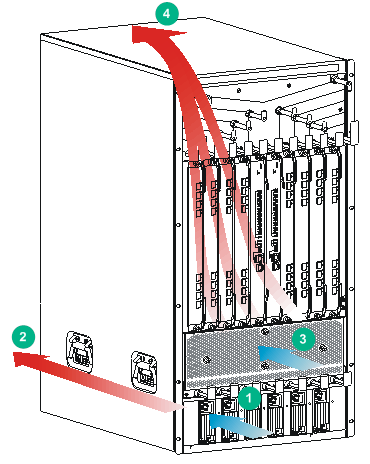

Figure 3 Airflow through the SR8816-X chassis

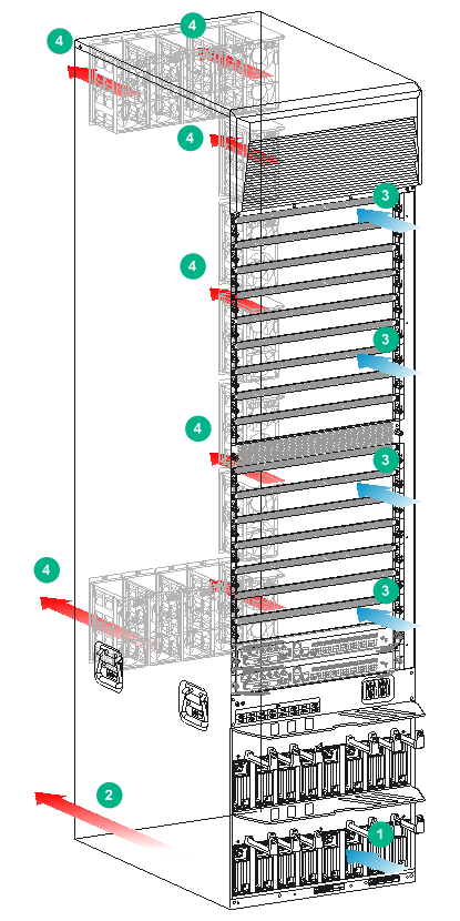

Figure 4 Airflow through the other models

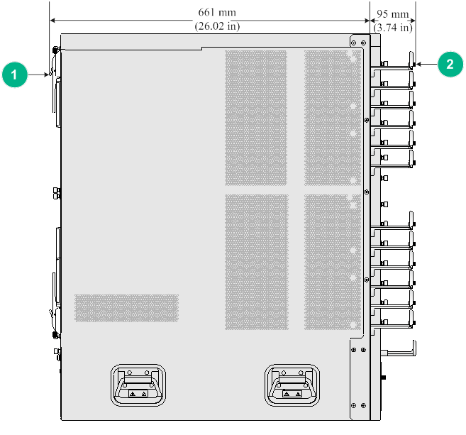

Figure 5 describes the depth of the SR8804-X, SR8808-X (one fan tray), SR8808-X (two fan trays), and SR8812-X chassis. Figure 6 describes the depth of the SR8808H-X and SR8816-X chassis.
Figure 5 SR8812-X chassis depth
(1) Ejector levers of the switching fabric modules |
(2) Cable management bracket |

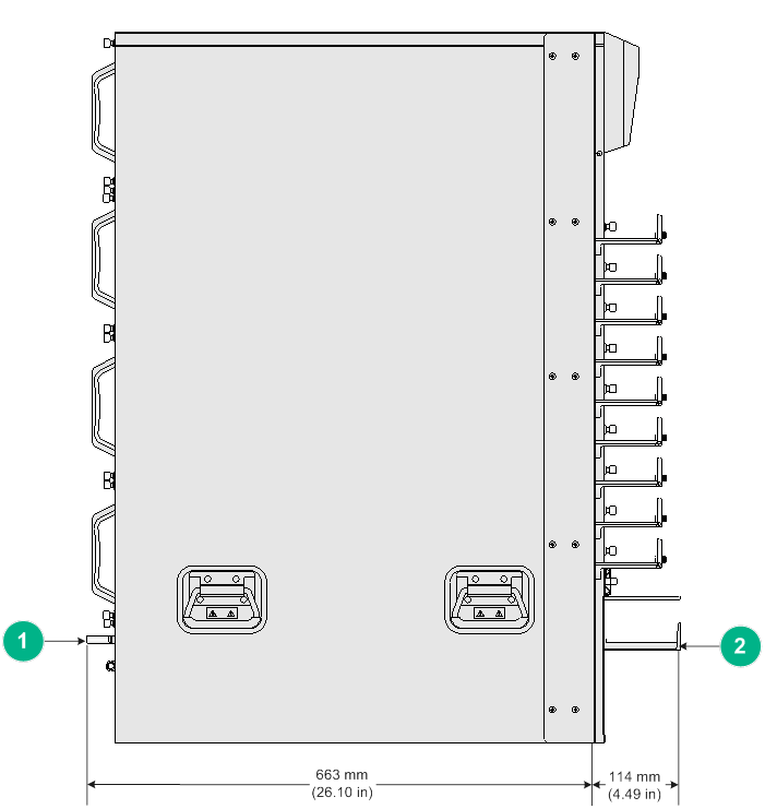

Figure 6 SR8808H-X chassis depth
(1) Handle at the rear of the chassis |
