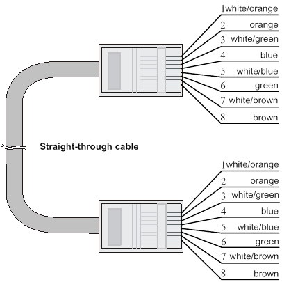

·     Straight-throughThe pinouts at both ends comply with standard 568B, as shown in Figure 2.

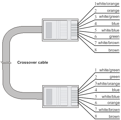

·     CrossoverThe pinouts at one end comply with standard 568B, and those at the other end comply with standard 568A, as shown in Figure 3.
Figure 2 Straight-through cable
Figure 3 Crossover cable

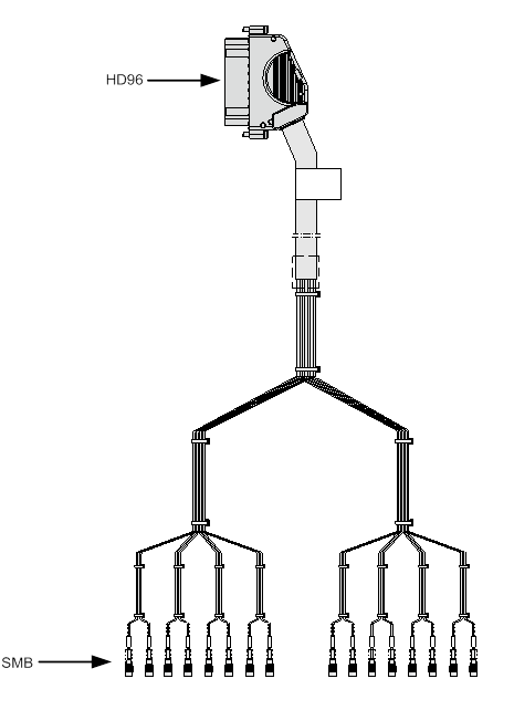

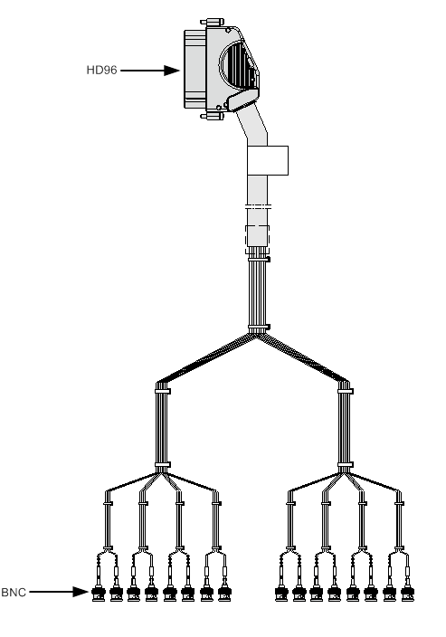

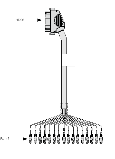

E1 cable
You can use an E1 cable to connect E1-HM96 Ethernet copper ports.
Figure 4 E1 cable (1)
Figure 5 E1 cable (2)
Figure 6 E1 cable (3)

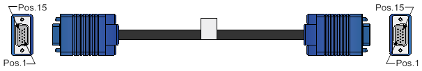

VGA cable
You can use a VGA cable to connect the universal open application platform and PC (or terminal).
Figure 7 VGA cable
Table 6 Cable connections between the universal open application platform and VGA connectors on the PC (or terminal)
VGA
Singal
1
VGA_RED
2
VGA_GREEN
3
VGA_BIUE
4
VGA_CABLE_PRSNT
5
GND
6
RED GND
7
GREEN GND
8
BIUE GND
9
P5V
10
GND
11
NC
12
VGA_SW_DATX
13
VGA_HSYNC
14
VGA_VSYNC
15
VGA_SW_CLKX
