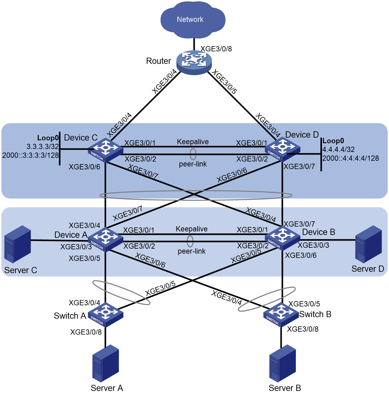

Example: Configuring multi-tier M-LAG and VRRP (campus)
Building a stable extended Layer 2 network within the campus requires dual-homing access to ensure reliability and load balancing to improve link utilization. Deploy M-LAG between the core tier and distribution tier, and between the distribution tier and access tier to form a loop-free topology. As shown in Figure 1:
·     Device A and Device B form a tier-1 M-LAG system M-LAG-1. Switch A and Switch B are connected to  M-LAG-1 through M-LAG interfaces.
·     Device C and Device D form a tier-2 M-LAG system M-LAG-2. Router is connected to M-LAG-2 through ECMP routes.
·     M-LAG-1 and M-LAG-2 are interconnected through M-LAG interfaces.
Deploy multi-tier M-LAG interconnected network to meet the following requirements:
·     Layer 2 and Layer 3 connectivity is available within the campus.
·     Layer 3 connectivity is available between the campus and the external network.
·     VRRP is deployed for the devices in M-LAG-2 at the core tier.
·     When both member devices in M-LAG-1 have link failures, the services can still communicate with one another.
·     When both member devices in M-LAG-2 have link failures, the services can still communicate with one another.
·     IPv4 and IPv6 dual stack is supported.
Figure 1 Network diagram

Analysis
·     Switch A and Switch B are Layer 2 access devices connected to Server A and Server B.
·     Server C and Server D are single-homed to the network.
·     Server A and Server C belong to the same VLAN. Server B and Server D belong to the same VLAN.
·     Configure Device A and Device B at the distribution tier as the tier-1 M-LAG for packet aggregation.
·     Configure Device C and Device D at the core tier as the tier-2 M-LAG. Configure VRRP on the devices, and specify the virtual IP address as the gateway address for Server A, Server B, Server C, and Server D. Configure ECMP routes associated with the uplink router.
·     The router is a Layer 3 device connected to the external network.
All the device parameters before the following configurations use the default settings. When using the following configurations on your devices in a live network, make sure they do not conflict with your current configurations to prevent potential negative impact on your network.
Make sure the settings for the m-lag system-mac command are different for the M-LAG devices at different tiers.

Configuring the links between tier-1 M-LAG devices and downlink devices Switch A and Switch B
Device A
Device B
Description
Remarks
vlan 10 20
vlan 10 20

Configuring the links between tier-1 M-LAG devices and the single-homed server
Device A
Device B
Description
Remarks
interface Ten-gigabitethernet 3/0/3
Enter the view of the physical interface connecting the M-LAG system to the single-homed server.
N/A
port access vlan 10
port trunk permit vlan 20
Assign the interface to VLAN 10 and VLAN 20.
N/A
Return to system view.
N/A
Configuring the links between tier-1 M-LAG devices and tier-2 M-LAG devices
Device A
Device B
Description
Remarks
interface bridge-aggregation 20

Configuring the tier-2 M-LAG system
Procedure summary
·     Configuring tier-2 M-LAG
·     Configuring the links between tier-2 M-LAG devices and tier-1 M-LAG devices
·     Configuring VRRP gateways
·     Configuring the links between tier-2 M-LAG devices and the router
·     Configuring the Layer 3 link connecting the tier-2 M-LAG devices
Device C
Device D
Description
Remarks
m-lag system-mac 2-2-2
Configure the M-LAG system MAC address.
You must configure the same M-LAG system MAC address for devices in the same M-LAG system.
m-lag system-number 1
m-lag system-number 2
Configure M-LAG system number.
You must set different M-LAG system numbers for devices in the same M-LAG system.
m-lag system-priority 34
Configure the M-LAG system priority.
You must set the same M-LAG system priority for devices in the same M-LAG system.
m-lag role priority 100
m-lag role priority 200
Set the M-LAG role priority of the device.
N/A
ip vpn-instance keepalive
Create a VPN instance named keepalive.
N/A
N/A
m-lag keepalive ip destination 192.168.3.2 source 192.168.3.1 vpn-instance keepalive
m-lag keepalive ip destination 192.168.3.1 source 192.168.3.2 vpn-instance keepalive
Device C
Device D
Description
Remarks
vlan 10 20
vlan 10 20
Create VLANs.
N/A
Device C
Device D
Description
Remarks
interface vlan-interface 10
Create VLAN-interface 10.
N/A
ip address 10.1.1.1 24
ip address 10.1.1.2 24
Assign an IPv4 address to VLAN-interface 10.
N/A
vrrp vrid 1 virtual-ip 10.1.1.100
Create IPv4 VRRP group 1, and configure virtual IP address 10.1.1.100 for the VRRP group.
Device C
Device D
Description
Remarks
vlan 34
vlan 34
Create a VLAN.
N/A
N/A
interface vlan-interface 34
Configure a VLAN interface.
Layer 3 link interconnecting the two M-LAG devices used for east-west traffic forwarding and north-south traffic escape.
ip address 34.1.1.1 24
ip address 34.1.1.2 24
Assign an IPv4 address to the interface.
N/A
ospf 1 area 0
ospf 1 area 0
Enable OSPF for the interface.
N/A
ipv6 address 34::1 64
ipv6 address 34::2 64
Assign an IPv6 address to the interface.
N/A
ospfv3 1 area 0.0.0.0
Enable OSPFv3 for the interface.
N/A
N/A
m-lag mad exclude interface Vlan-interface 34
Exclude VLAN-interface 101 from the shutdown action by M-LAG MAD.
This configuration avoids traffic interruption caused by ARP/ND entry synchronization failure when the VLAN interface is in M-LAG MAD DOWN state.

Traffic model
About the traffic model
The traffic model contains the following information:
·     ID—Traffic ID, in O-X-XXX format. The first segment (O) represents overlay traffic. The second segment (X) represents the IP version (4 for IPv4 and 6 for IPv6). The third segment (XXX) represents a unique number for the traffic, starting from 001.
·     Type—Traffic type, such as known unicast/IPv4 and unicast/L2.
·     Direction—Traffic direction, such as inter-leaf east-west traffic and north-south traffic.
·     Path—The nodes that the traffic traverses from the source to the destination.
·     Simulation method—Traffic simulation method. Testers are used to simulate the patterns of traffic on the network set up in this example.
·     Simulation traffic load—The network can be tested under light load (fewer than 1000 simulation traffic flows) or heavy load (more than 1000 simulation traffic flows).
·     Traffic direction to firewalls/LBs—No firewalls or LBs are used in this example, or traffic is directed to firewalls or LBs through PBR, M-LAG+VRRP, or static routing.
Traffic
ID
Type
Direction
Path
Simulation method
Remarks
O-4-001
Known unicast/IPv4
North-south traffic
Server A-Device A&B-Device C&D-Router-Network
Tester
Light
N/A
When the uplink interface of Device C fails, traffic is forwarded along the Layer 3 link between M- LAG member devices.
O-4-002
Known unicast/IPv4
North-south traffic
Server C-Device A-Device C&D-Router-Network
Tester
Light
N/A
O-4-003
Known unicast/IPv4
North-south traffic
Server D-Device B-Device C&D-Router-Network
Tester
Light
N/A
O-4-004
Known unicast/IPv4
East-west traffic
Server A-Device A&B-Device C&D-Device A&B-Server B
Tester
Light
N/A
N/A
O-4-005
Known unicast/IPv4
East-west traffic
Server A-Device A&B-Device C&D-Device B-Server D
Tester
Light
N/A
N/A
O-6-001
Known unicast/IPv6
North-south traffic
Tester
Light
N/A
O-6-002
Known unicast/IPv6
North-south traffic
Server C-Device A-Device D&D-Router-Network
Tester
Light
N/A
O-6-003
Known unicast/IPv6
North-south traffic
Tester
Light
N/A
O-6-004
Known unicast/IPv6
East-west traffic
Tester
Light
N/A
N/A
O-6-005
Known unicast/IPv6
East-west traffic
Tester
Light
N/A
N/A
O-L2-001
Known unicast L2
East-west traffic
Server A-Device A&B-Device A-Server C
Tester
Light
N/A
N/A

Verifying the tier-2 M-LAG system status
 View the status of the M-LAG system between Device C and Device D to verify that the M-LAG system can be established correctly. Take Device C as an example:
# Display summary information about the peer-link interface and M-LAG interfaces.

# View the status of the M-LAG system between Device A and Device B to verify that the M-LAG system can be established correctly. Take Device A as an example:
# Display summary information about the peer-link interface and M-LAG interfaces, and verify that the peer-link interface is up.

Verifying the routing protocol status
# Display OSPF neighbor and route information on Device C.

Verify east-west and north-south traffic forwarding
Server A, Server B, and Server C have Layer 2 and Layer 3 connectivity between them.
Server A, Server C, Server D, and Network have Layer 3 connectivity between them.
