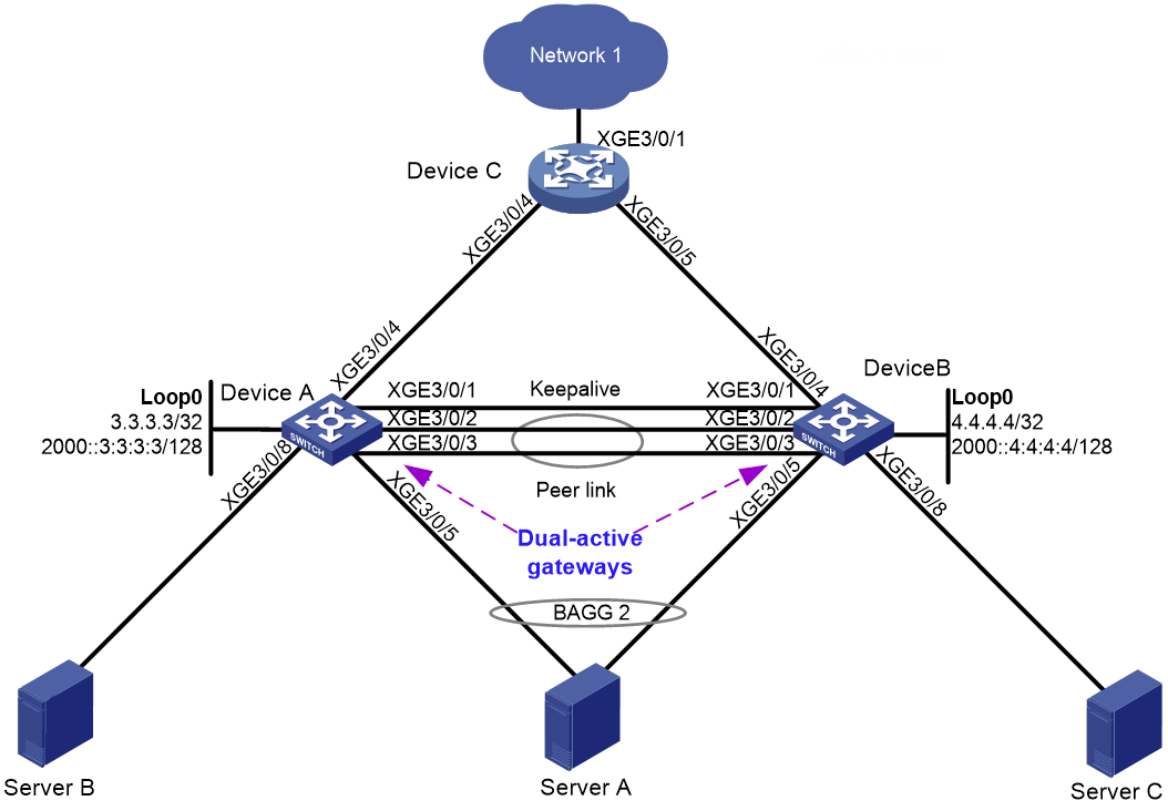

As shown in Figure 1:
·     Set up an M-LAG system with Device A and Device B, and attach Server A to M-LAG interfaces on the M-LAG system.
·     Configure dual-active gateways on Device A and Device B for Server A.
·     Configure ECMP routes between the M-LAG system and upstream Device C.
·     Attach singlehomed servers Server B and Server C to the M-LAG system.  Server B is in the same subnet as Server A, and Server C is in a different subnet than Server A.
Establish network connections to meet the following requirements:
·     Server A, Server B, and Server C have both IPv4 and IPv6 connectivity among them.
·     Server A, Server B, and Server C have both IPv4 and IPv6 connectivity with Network.
·     Service traffic is not interrupted when link failures occur on the M-LAG member devices.
Figure 1 Network diagram
Device
Interface

Analysis
·     Configure VLAN interfaces on Device A and Device B to provide dual-active gateway services for Server A.
·     Attach Server A with two links to the M-LAG system, and specify the IP address of VLAN-interface 100 as the gateway on Server A.
·     Attach Server B with one link to the M-LAG system, and specify the IP address of VLAN-interface 100 as the gateway on Server B.
·     Attach Server C with one link to the M-LAG system, and specify the IP address of VLAN-interface 200 as the gateway on Server C.
·     Configure ECMP routes to Device C on Device A and Device B.
·     Configure Device A and Device B as OSPF and OSPFv3 neighbors to each other for them to forward traffic of singlehomed servers and back up each other.
·     Configure IPv4 and IPv6 dual stack.

Configuring dual-active gateways
Device A
Device B
Description
Remarks
vlan 100
vlan 100
Create VLAN 100.
N/A
Return to system view.
N/A
interface bridge-aggregation 2
Enter aggregate interface view.
N/A
port link-type trunk
Configure Bridge-Aggregation 2 as a trunk port.
N/A
port trunk permit vlan 100
Assign the interface to VLAN 100.
N/A
undo port trunk permit vlan 1
Remove the interface from VLAN 1.
N/A
N/A
interface vlan-interface 100
Create VLAN-interface 100.
N/A
ip address 100.1.1.1 24
Assign an IPv4 address to VLAN-interface 100.
The IP address is used as the IPv4 dual-active gateway.
ipv6 address 100::1 64
Assign an IPv6 address to VLAN-interface 100.
The IP address is used as the IPv6 dual-active gateway.
mac-address 0002-2222-2222
Assign a MAC address to VLAN-interface 100.
N/A
N/A
m-lag mad exclude interface Vlan-interface100
Exclude VLAN-interface 100 from the shutdown action by M-LAG MAD.
Excluded the VLAN interface of the VLAN accommodating M-LAG interfaces from the shutdown action by M-LAG MAD. This ensures correct ARP and ND entry synchronization via the VLAN interface.
Configuring the interconnect links between the M-LAG system and upstream Device C
Device A
Device B
Description
vlan 32
vlan 33
Create VLAN 33.
interface Ten-gigabitethernetE 3/0/4
Enter Ethernet interface view.
port access vlan 32
port access vlan 33
Assign the interface to VLAN 33.
interface vlan-interface 32
interface vlan-interface 33
Create VLAN-interface 33.
ip address 32.1.1.1 24
ip address 33.1.1.1 24
Assign an IPv4 address to the VLAN interface.
ospf 1 area 0
ospf 1 area 0
Enable OSPF on the interface.
ipv6 address 32::1 64
ipv6 address 33::1 64
Assign an IPv6 address to the VLAN interface.
ospfv3 1 area 0
ospfv3 1 area 0
Enable OSPFv3 on the interface.
Configuring the interfaces facing singlehomed devices
Device A
Device B
Description
vlan 200
Create VLAN 200.
interface ten-gigabitethernet 3/0/8
Configure the interface to which Server B and Server C are singlehomed.
port access vlan 100
port access vlan 200
Assign the interface to VLAN 200.
interface vlan-interface 200
Create VLAN-interface 200.
ip address 200.1.1.1 24
ipv6 address 200::1 64
Configuring upstream Device C
Procedure summary
·     Configuring the interconnect links between upstream Device C and the M-LAG system
·     Configuring the interconnect links between upstream Device C and Network
Device C
Description
undo stp global enable
Disable the spanning tree protocol globally.
vlan 32 33
Create VLANs.
port access vlan 32
Assign the interface facing Device A to VLAN 32.
interface Ten-gigabitethernetE 3/0/5
port access vlan 33
Assign the interface facing Device B to VLAN 33.
router id 5.5.5.5
Configure a route ID.
ospf 1
Configure OSPF to establish IPv4 connectivity between the M-LAG member devices.
import-route direct
Redistribute direct routes..
area 0
Configure area 0.
Return to OSPF view.
ospfv3 1
Enable OSPFv3.
router-id 5.5.5.5
Configure area 0.
import-route direct
area 0
Configure area 0.
Return to OSPFv3 view.
interface loopback 0
Create a loopback interface.
ip address 5.5.5.5 255.255.255.255
Assign an IPv4 address to the loopback interface.
ospf 1 area 0
Enable OSPF on the loopback interface.
ipv6 address 2000::5:5:5:5/128
Assign an IPv6 address to the loopback interface.
ospfv3 1 area 0
Enable OSPFv3 on the loopback interface.
Create VLAN-interface 32.
ip address 32.1.1.2 24
ospf 1 area 0
Enable OSPF on the VLAN interface.
ipv6 address 32::2 64
ospfv3 1 area 0
Enable OSPFv3 on the VLAN interface.
ip address 33.1.1.2 24
ospf 1 area 0
ipv6 address 33::2 64
ospfv3 1 area 0
Device C
Description
vlan 22
Create VLAN 22.
interface Ten-gigabitethernetE 3/0/1
port access vlan 22
Assign the interface facing the external network to VLAN 22.
interface vlan-interface 22
Create VLAN-interface 22.
ip address 22.1.1.1 24
ipv6 address 22::1 64
Traffic forwarding models
Overlay traffic characteristics
The forwarding model matrix provides the following characteristics of overlay traffic:
·     No.—Traffic number in the O-X-XXX format:
¡     OOverlay traffic.
¡     X—Protocol number, which can be 4 (IPv4) or 6 (IPv6).
¡     XXX—Traffic sequence number starting from 001.
·     Traffic type—Type of overlay traffic, which can be IPv4 known unicast or IPv6 known unicast.
·     Direction—Direction of overlay traffic. The value is south-north or east-west.
·     Forwarding path—Nodes that overlay traffic traverses.
·     Traffic simulation—Traffic simulation method. Typically, a tester is used to simulate server traffic.
·     Load—Traffic size, which can be light (less than 1000 flows) and heavy (more than 1000 flows).
·     Traffic direction to firewalls/LB—Configuration used to direct traffic to firewalls and load balancers, such as PBR, M-LAG, VRRP, static routes.
Forwarding models
No.
Traffic type
Direction
Forwarding path
Traffic simulation
Load
Remarks
O-4-001
IPv4 known unicast
South-north
Server A > Device A&B > Device C > Network 1
Tester
Light
N/A
Traffic fails over via the Layer 3 link between the M-LAG member devices upon failure of an uplink interface.
O-4-002
IPv4 known unicast
South-north
Server B > Device A > Device C > Network 1
Tester
Light
N/A
O-4-003
IPv4 known unicast
South-north
Server C > Device B > Device C > Network 1
Tester
Light
N/A
O-4-004
IPv4 known unicast
East-west
Server A > Device A&B > Device A > Server B
Tester
Light
N/A
N/A
O-4-005
IPv4 known unicast
East-west
Server A > Device A&B > Device B > Server C
Tester
Light
N/A
N/A
O-4-006
IPv4 known unicast
East-west
Server B > Device A > Device B > Server C
Tester
Light
N/A
N/A
O-6-001
IPv6 known unicast
South-north
Tester
Light
N/A
O-6-002
IPv6 known unicast
South-north
Server B > Device A&B > Device C >
Tester
Light
N/A
O-6-003
IPv6 known unicast
South-north
Server C > Device A&B > Device C >
Tester
Light
N/A
O-6-004
IPv6 known unicast
East-west
Tester
Light
N/A
N/A
O-6-005
IPv6 known unicast
East-west
Tester
Light
N/A
N/A
O-6-006
IPv6 known unicast
East-west
Tester
Light
N/A
N/A

# Display detailed information about the peer-link interface and M-LAG interfaces.
[DeviceA]display m-lag summary
Flags: A -- Aggregate interface down, B -- No peer M-LAG interface configured
       C -- Configuration consistency check failed
PeerLink: BAGG1
PeerLink state (cause): UP
Keepalive link state (cause): UP
                     M-LAG interface information
M-LAG interface  M-LAG group  Local state (cause)  Peer state  Remaining down time(s)
BAGG2         1         UP                   UP          -
[DeviceA]
[DeviceA]display m-lag verbose
Flags: A -- Home_Gateway, B -- Neighbor_Gateway, C -- Other_Gateway,
       D -- PeerLink_Activity, E -- DRCP_Timeout, F -- Gateway_Sync,
       G -- Port_Sync, H -- Expired
Peer-link interface/Peer-link interface ID: BAGG1/1
State: UP
Cause: -
Local DRCP flags/Peer DRCP flags: ABDFG/ABDFG
Local Selected ports (index): TE3/0/2 (2), TE3/0/3 (3)
Peer Selected ports indexes: 99, 100
Peer-link interface/Peer-link interface: BAGG2/1
Local M-LAG interface state: UP
Peer M-LAG interface state: UP
M-LAG group state: UP
Local M-LAG interface down cause: -
Remaining m-lag DOWN time: -
Local M-LAG interface LACP MAC: Config=N/A, Effective=0002-0002-0002
Peer M-LAG interface LACP MAC: Config=N/A, Effective=0002-0002-0002
Local M-LAG interface LACP priority: Config=32768, Effective=123
Peer M-LAG interface LACP priority: Config=32768, Effective=123
Local Selected ports (index): TE3/0/5 (5)
Peer Selected ports indexes: 102
[DeviceB]display m-lag summary
Peer-link interface: BAGG1
Peer-link interface state (cause): UP
M-LAG IF  M-LAG group  Local state (cause)  Peer state  Remaining down time(s)
BAGG2         1         UP                   UP          -
[DeviceB]
[DeviceB]display m-lag verbose
PeerLink interface/PeerLink interface ID: BAGG1/1
State: UP
Cause: -
Local Selected ports (index): TE3/0/2 (99), TE3/0/3 (100)
Peer Selected ports indexes: 2, 3
PeerLink interface/PeerLink interface group ID: BAGG2/1
Remaining M-LAG DOWN time: -
Local Selected ports (index): TE3/0/5 (102)
Peer Selected ports indexes: 5
Verifying the routing protocols
# Display the OSPF neighbors of Device A.
[DeviceA]display ospf peer
          OSPF Process 1 with Router ID 3.3.3.3
               Neighbor Brief Information
 Area: 0.0.0.0
 Router ID       Address         Pri Dead-Time  State             Interface
 4.4.4.4         101.1.1.2       1   32         Full/BDR          Vlan101
 5.5.5.5         32.1.1.2        1   38         Full/DR           Vlan32
# Display the OSPFv3 neighbors of Device A.
[DeviceA]display ospfv3 peer
               OSPFv3 Process 1 with Router ID 3.3.3.3
 Area: 0.0.0.0
 Router ID       Pri State             Dead-Time InstID Interface
 4.4.4.4         1   Full/BDR          00:00:39  0      Vlan101
 5.5.5.5         1   Full/BDR          00:00:40  0      Vlan32
# Display the OSPF neighbors of Device B.
[DeviceB]display ospf peer
          OSPF Process 1 with Router ID 4.4.4.4
 Area: 0.0.0.0
 3.3.3.3         101.1.1.1       1   33         Full/DR           Vlan101
 5.5.5.5         33.1.1.2        1   31         Full/DR           Vlan33
# Display the OSPFv3 neighbors of Device B.
[DeviceB]display ospfv3 peer
               OSPFv3 Process 1 with Router ID 4.4.4.4
 Area: 0.0.0.0
 3.3.3.3         1   Full/DR           00:00:36  0      Vlan101
 5.5.5.5         1   Full/BDR          00:00:39  0      Vlan33
# Display the OSPF neighbors of Device C.
[DeviceC]display ospf peer
          OSPF Process 1 with Router ID 5.5.5.5
 Area: 0.0.0.0
 3.3.3.3         32.1.1.1        1   35         Full/BDR          Vlan32
 4.4.4.4         33.1.1.1        1   35         Full/BDR          Vlan33
# Display the OSPFv3 neighbors of Device C.
[DeviceC]display ospfv3 peer
               OSPFv3 Process 1 with Router ID 5.5.5.5
 Area: 0.0.0.0
 3.3.3.3         1   Full/DR           00:00:38  0      Vlan32
 4.4.4.4         1   Full/DR           00:00:35  0      Vlan33
Verifying connectivity among the servers and between the servers and Network
Verify that Server A and Server B have IPv4 and IPv6 connectivity between them.
Verify that Server A and Server C have IPv4 and IPv6 connectivity between them.
Verify that Server A, Server B, and Server C have IPv4 and IPv6 connectivity with Network.
Verifying connectivity among the servers and between the servers and Network in case of downlink failure on Device A or Device B
Verify that Server A, Server B, and Server C have connectivity among them and with Network after the Device A is disconnected from Server A. Transient traffic loss occurs during traffic failover.
Verify that Server A, Server B, and Server C have connectivity among them and with Network after the Device B is disconnected from Server A. Transient traffic loss occurs during traffic failover.
Verifying connectivity among the servers and between the servers and Network in case of uplink failure on Device A or Device B
Verify that Server A, Server B, and Server C have connectivity among them and with Network after the Device A is disconnected from Device C. Transient traffic loss occurs during traffic failover.
Verify that Server A, Server B, and Server C have connectivity among them and with Network after the Device B is disconnected from Device C. Transient traffic loss occurs during traffic failover.
Upgrading the devices
