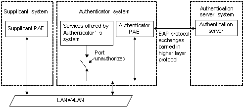

802.1x operates in the typical client/server model and defines three entities: supplicant system, authenticator system, and authentication server system, as shown in Figure 1-1.
Figure 1-1 Architecture of 802.1x
l           Supplicant system: A system at one end of the LAN segment, which is authenticated by the authenticator system at the other end. A supplicant system is usually a user-end device and initiates 802.1x authentication through 802.1x client software supporting the EAP over LANs (EAPOL) protocol.
l           Authenticator system: A system at the other end of the LAN segment, which authenticates the connected supplicant system. An authenticator system is usually an 802.1x-enabled network device and provides ports (physical or logical) for supplicants to access the LAN.
l           Authentication server system: The system providing authentication, authorization, and accounting services for the authenticator system. The authentication server, usually a Remote Authentication Dial-in User Service (RADIUS) server, maintains user information like username, password, VLAN that the user belongs to, committed access rate (CAR) parameters, priority, and ACLs.
The above systems involve three basic concepts: PAE, controlled port, control direction.

An authenticator provides ports for supplicants to access the LAN. Each of the ports can be regarded as two logical ports: a controlled port and an uncontrolled port.
l           The uncontrolled port is always open in both the inbound and outbound directions to allow EAPOL protocol frames to pass, guaranteeing that the supplicant can always send and receive authentication frames.
l           The controlled port is open to allow normal traffic to pass only when it is in the authorized state.
l           The controlled port and uncontrolled port are two parts of the same port. Any frames arriving at the port are visible to both of them.

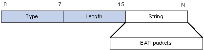

The EAP-Message attribute is used to encapsulate EAP packets. Figure 1-6 shows its encapsulation format. The value of the Type field is 79. The String field can be up to 253 bytes. If the EAP packet is longer than 253 bytes, it can be fragmented and encapsulated into multiple EAP-Message attributes.

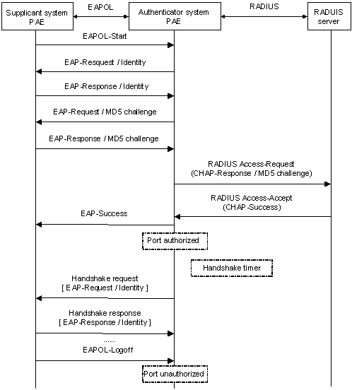

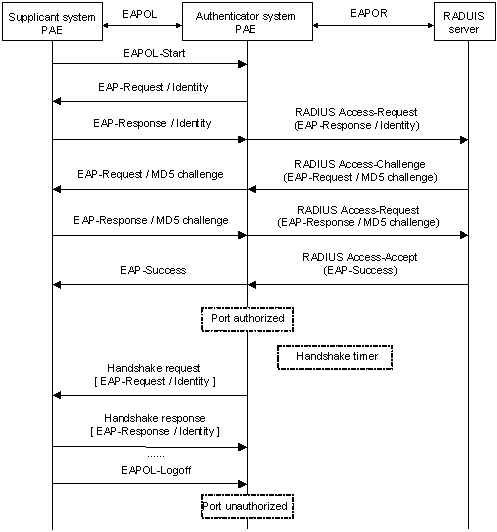

Figure 1-8 shows the message exchange procedure with EAP-MD5.
Figure 1-8 Message exchange in EAP relay mode
1)         When a user launches the 802.1x client software and enters the registered username and password, the 802.1x client software generates an EAPOL-Start frame and sends it to the authenticator to initiate an authentication process.
2)         Upon receiving the EAPOL-Start frame, the authenticator responds with an EAP-Request/Identity packet for the username of the supplicant.
3)         When the supplicant receives the EAP-Request/Identity packet, it encapsulates the username in an EAP-Response/Identity packet and sends the packet to the authenticator.
4)         Upon receiving the EAP-Response/Identity packet, the authenticator relays the packet in a RADIUS Access-Request packet to the authentication server.
5)         When receiving the RADIUS Access-Request packet, the RADIUS server compares the identify information against its user information table to obtain the corresponding password information. Then, it encrypts the password information using a randomly generated challenge, and sends the challenge information through a RADIUS Access-Challenge packet to the authenticator.
6)         After receiving the RADIUS Access-Challenge packet, the authenticator relays the contained EAP-Request/MD5 Challenge packet to the supplicant.
7)         When receiving the EAP-Request/MD5 Challenge packet, the supplicant uses the offered challenge to encrypt the password part (this process is not reversible), creates an EAP-Response/MD5 Challenge packet, and then sends the packet to the authenticator.
8)         After receiving the EAP-Response/MD5 Challenge packet, the authenticator relays the packet in a RADIUS Access-Request packet to the authentication server.
9)         When receiving the RADIUS Access-Request packet, the RADIUS server compares the password information encapsulated in the packet with that generated by itself. If the two are identical, the authentication server considers the user valid and sends to the authenticator a RADIUS Access-Accept packet.
10)     Upon receiving the RADIUS Access-Accept packet, the authenticator opens the port to grant the access request of the supplicant. After the supplicant gets online, the authenticator periodically sends handshake requests to the supplicant to check whether the supplicant is still online. By default, if two consecutive handshake attempts end up with failure, the authenticator concludes that the supplicant has gone offline and performs the necessary operations, guaranteeing that the authenticator always knows when a supplicant goes offline.
11)     The supplicant can also send an EAPOL-Logoff frame to the authenticator to go offline unsolicitedly. In this case, the authenticator changes the status of the port from authorized to unauthorized.

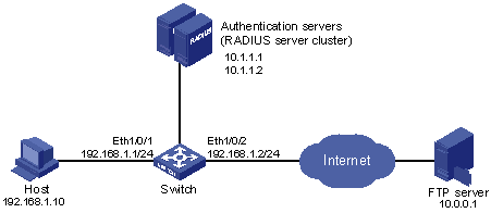

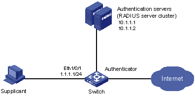

1.5  802.1x Configuration Example
I. Network requirements
l           The access control method of macbased is required on the port to control supplicants.
l           All supplicants belong to default domain aabbcc.net, which can accommodate up to 30 users. RADIUS authentication is performed at first, and then local authentication when no response from the RADIUS server is received. If the RADIUS accounting fails, the authenticator gets users offline.
l           A server group with two RADIUS servers is connected to the switch. The IP addresses of the servers are 10.1.1.1 and 10.1.1.2 respectively. Use the former as the primary authentication/secondary accounting server, and the latter as the secondary authentication/primary accounting server.
l           Set the shared key for the switch to exchange packets with the authentication server as name, and that for the switch to exchange packets with the accounting server as money.
l           Specify the switch to try up to five times at an interval of 5 seconds in transmitting a packet to the RADIUS server until it receives a response from the server, and to send real time accounting packets to the accounting server every 15 minutes.
l           Specify the switch to remove the domain name from the username before passing the username to the RADIUS server.
l           Set the username of the 802.1x user as localuser and the password as localpass and specify to use plain text mode. Enable the idle cut function to get the user offline whenever the user remains idle for over 20 minutes.
II. Network diagram
Figure 1-10 Network diagram for 802.1x configuration
III. Configuration procedure
&  Note:
The following configuration procedure covers most AAA/RADIUS configuration commands for the authenticator, while configuration on the supplicant and RADIUS server are omitted. For information about AAA/RADIUS configuration commands, refer to AAA RADIUS HWTACACS Configuration.
# Configure the IP addresses for each interface. (Omitted)
# Add local access user localuser, enable the idle cut function, and set the idle cut interval.
<Sysname> system-view
[Sysname] local-user localuser
[Sysname-luser-localuser] service-type lan-access
[Sysname-luser-localuser] password simple localpass
[Sysname-luser-localuser] attribute idle-cut 20
[Sysname-luser-localuser] quit
# Create RADIUS scheme radius1 and enter its view.
[Sysname] radius scheme radius1
# Configure the IP addresses of the primary authentication and accounting RADIUS servers.
[Sysname-radius-radius1] primary authentication 10.1.1.1
[Sysname-radius-radius1] primary accounting 10.1.1.2
# Configure the IP addresses of the secondary authentication and accounting RADIUS servers.
[Sysname-radius-radius1] secondary authentication 10.1.1.2
[Sysname-radius-radius1] secondary accounting 10.1.1.1
# Specify the shared key for the device to exchange packets with the authentication server.
[Sysname-radius-radius1] key authentication name
# Specify the shared key for the device to exchange packets with the accounting server.
[Sysname-radius-radius1] key accounting money
# Set the interval for the device to retransmit packets to the RADIUS server and the maximum number of transmission attempts.
[Sysname-radius-radius1] timer response-timeout 5
[Sysname-radius-radius1] retry 5
# Set the interval for the device to send real time accounting packets to the RADIUS server.
[Sysname-radius-radius1] timer realtime-accounting 15
# Specify the device to remove the domain name of any username before passing the username to the RADIUS server.
[Sysname-radius-radius1] user-name-format without-domain
[Sysname-radius-radius1] quit
# Create domain aabbcc.net and enter its view.
[Sysname] domain aabbcc.net
# Set radius1 as the RADIUS scheme for users of the domain and specify to use local authentication as the secondary scheme.
[Sysname-isp-aabbcc.net] authentication default radius-scheme radius1 local
[Sysname-isp-aabbcc.net] authorization default radius-scheme radius1 local
[Sysname-isp-aabbcc.net] accounting default radius-scheme radius1 local
# Set the maximum number of users for the domain as 30.
[Sysname-isp-aabbcc.net] access-limit enable 30
# Enable the idle cut function and set the idle cut interval.
[Sysname-isp-aabbcc.net] idle-cut enable 20
[Sysname-isp-aabbcc.net] quit
# Configure aabbcc.net as the default domain.
[Sysname] domain default enable aabbcc.net
# Enable 802.1x globally.
[Sysname] dot1x
# Enable 802.1x for port Ethernet 1/0/1.
[Sysname] interface Ethernet 1/0/1
[Sysname-Ethernet1/0/1] dot1x
[Sysname-Ethernet1/0/1] quit
# Set the port access control method. (Optional. The default answers the requirement.)
[Sysname] dot1x port-method macbased interface Ethernet 1/0/1

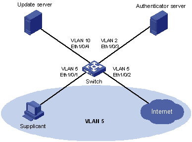

As shown in Figure 1-11:
l           A host is connected to port Ethernet 1/0/1 of the switch and must pass 802.1x authentication to access the Internet.
l           The authentication server run RADIUS and is in VLAN 2.
l           The update server, which is in VLAN 10, is for client software download and upgrade.
l           Port Ethernet 1/0/2 of the switch, which is in VLAN 5, is for accessing the Internet.

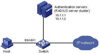

As shown in Figure 1-12:
l           On port Ethernet 1/0/1, enable 802.1x and set VLAN 10 as the guest VLAN.
As shown in Figure 1-13:
l           Authenticated supplicants are assigned to VLAN 5 and permitted to access the Internet.
II. Network diagrams
Figure 1-11 Network diagram for guest VLAN configuration
Figure 1-12 Network diagram with VLAN 10 as the guest VLAN
Figure 1-13 Network diagram when the supplicant passes authentication

1.7  ACL Assigning Configuration Example
As shown in Figure 1-14, a host is connected to port Ethernet 1/0/1 of the switch and must pass 802.1x authentication to access the Internet.
l           Configure the RADIUS server to assign ACL 3000.
l           Enable 802.1x authentication on port Ethernet 1/0/1 of the switch, and configure ACL 3000.
After the host passes 802.1x authentication, the RADIUS server assigns ACL 3000 to port Ethernet 1/0/1. As a result, the host can access the Internet but cannot access the FTP server, whose IP address is 10.0.0.1.
II. Network diagram
Figure 1-14 Network diagram for ACL assigning

3.5.2  RADIUS-Based MAC Authentication Configuration Example
As illustrated in Figure 3-2, a host is connected to the device through port Ethernet 1/0/1. The device authenticates the host through the RADIUS server.
l           MAC authentication is required on every port to control user access to the Internet.
l           Set the offline detect timer to 180 seconds and the quiet timer to 3 minutes.
II. Network diagram
Figure 3-2 Network diagram for MAC authentication using RADIUS
1)         Configure MAC authentication on the device
# Configure the IP addresses of the interfaces. (Omitted)
# Configure a RADIUS scheme.
[Device] radius scheme 2000
[Device-radius-2000] primary authentication 10.1.1.1 1812
[Device-radius-2000] primary accounting 10.1.1.2 1813
[Device-radius-2000] key authentication abc
[Device-radius-2000] key accounting abc
[Device-radius-2000] user-name-format without-domain
[Device-radius-2000] quit
# Specify the AAA schemes for the ISP domain.
[Device] domain 2000
[Device-isp-2000] authentication default radius-scheme 2000
[Device-isp-2000] authorization default radius-scheme 2000
[Device-isp-2000] accounting default radius-scheme 2000
[Device-isp-2000] quit
# Enable MAC authentication globally.
[Device] mac-authentication
# Enable MAC authentication for port Ethernet 1/0/1.
[Device] mac-authentication interface ethernet 1/0/1
# Specify the ISP domain for MAC authentication.
[Device] mac-authentication domain 2000

3.5.3  ACL Assigning Configuration Example
As shown in Figure 3-3, a host is connected to port Ethernet 1/0/1 of the switch and must pass MAC authentication to access the Internet.
l           Enable MAC authentication on port Ethernet 1/0/1 of the switch, and configure ACL 3000.
After the host passes MAC authentication, the RADIUS server assigns ACL 3000 to port Ethernet 1/0/1. As a result, the host can access the Internet but cannot access the FTP server, whose IP address is 10.0.0.1.
II. Network diagram
Figure 3-3 Network diagram for ACL assigning
# Configure the RADIUS scheme.
[Sysname] radius scheme 2000
[Sysname-radius-2000] primary authentication 10.1.1.1 1812
[Sysname-radius-2000] primary accounting 10.1.1.2 1813
[Sysname-radius-2000] key authentication abc
[Sysname-radius-2000] key accounting abc
[Sysname-radius-2000] user-name-format without-domain
[Sysname-radius-2000] quit
# Create an ISP domain and specify the AAA schemes.
[Sysname] domain 2000
[Sysname-isp-2000] authentication default radius-scheme 2000
[Sysname-isp-2000] authorization default radius-scheme 2000
[Sysname-isp-2000] accounting default radius-scheme 2000
[Sysname-isp-2000] quit
# Configure ACL 3000 to deny packets destined for 10.0.0.1.
[Sysname] acl number 3000
[Sysname-acl-adv-3000] rule 0 deny ip destination 10.0.0.1 0
[Sysname-acl-adv-3000] quit
[Sysname] mac-authentication
[Sysname-Ethernet1/0/1] mac-authentication
After completing the above configurations, you can use the ping command to verify whether the ACL 3000 assigned by the RADIUS server functions.
[Sysname] ping 10.0.0.1
  PING 10.0.0.1: 56  data bytes, press CTRL_C to break
    Request time out
    Request time out
    Request time out
    Request time out
    Request time out
  --- 10.0.0.1 ping statistics ---
    5 packet(s) transmitted
    0 packet(s) received
    100.00% packet loss
