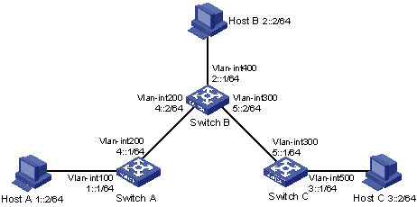

1.4  IPv6 Static Routing Configuration Example
I. Network requirements
With IPv6 static routes configured, all hosts and switches can interact with each other.
II. Network diagram
Figure 1-1 Network diagram for static routes
III. Configuration procedure
1)         Configure the IPv6 addresses of all VLAN interfaces (Omitted)
2)         Configure IPv6 static routes.
# Configure the default IPv6 static route on Switch A.
<SwitchA> system-view
[SwitchA] ipv6
[SwitchA] ipv6 route-static :: 0 4::2
# Configure two IPv6 static routes on Switch B.
<SwitchB> system-view
[SwitchB] ipv6
[SwitchB] ipv6 route-static 1:: 64 4::1
[SwitchB] ipv6 route-static 3:: 64 5::1
# Configure the default IPv6 static route on Switch C.
<SwitchC> system-view
[SwitchC] ipv6
[SwitchC] ipv6 route-static :: 0 5::2
3)         Configure the IPv6 addresses of hosts and gateways.
Configure the IPv6 addresses of all the hosts based upon the network diagram, configure the default gateway of Host A as 1::1, that of Host B as 2::1, and that of Host C as 3::1.
4)         Display configuration information
# Display the IPv6 routing table of Switch A.
[SwitchA] display ipv6 routing-table
Routing Table :
         Destinations : 7        Routes : 7
Destination: ::/0                                        Protocol  : Static
NextHop    : 4::2                                        Preference: 60
Interface  : Vlan200                                     Cost      : 0
Destination: ::1/128                                     Protocol  : Direct
NextHop    : ::1                                         Preference: 0
Interface  : InLoop0                                     Cost      : 0
Destination: 1::/64                                      Protocol  : Direct
NextHop    : 1::1                                        Preference: 0
Interface  : Vlan100                                     Cost      : 0
Destination: 1::1/128                                    Protocol  : Direct
Destination: 4::/64                                      Protocol  : Direct
NextHop    : 4::1                                        Preference: 0
Destination: 4::1/128                                    Protocol  : Direct
Destination: FE80::/10                                   Protocol  : Direct
NextHop    : ::                                          Preference: 0
Interface  : NULL0                                       Cost      : 0
# Verify the connectivity with the ping command.
[SwitchA] ping ipv6 3::1
  PING 3::1 : 56  data bytes, press CTRL_C to break
    Reply from 3::1
    bytes=56 Sequence=1 hop limit=254  time = 63 ms
    Reply from 3::1
    bytes=56 Sequence=2 hop limit=254  time = 62 ms
    Reply from 3::1
    bytes=56 Sequence=3 hop limit=254  time = 62 ms
    Reply from 3::1
    bytes=56 Sequence=4 hop limit=254  time = 63 ms
    Reply from 3::1
    bytes=56 Sequence=5 hop limit=254  time = 63 ms
  --- 3::1 ping statistics ---
    5 packet(s) transmitted
    5 packet(s) received
    0.00% packet loss
    round-trip min/avg/max = 62/62/63 ms

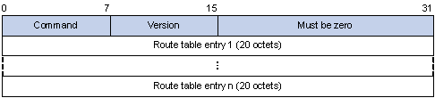

A RIPng packet consists of a header and multiple route table entries (RTEs). The maximum number of RTEs in a packet depends on the MTU of the sending interface.
Figure 2-1 shows the packet format of RIPng.
Figure 2-1 RIPng basic packet format
l           Command: Type of message. 0x01 indicates Request, 0x02 indicates Response.
l           Version: Version of RIPng. It can only be 0x01 currently.
l           RTE: Route table entry, 20 bytes for each entry.

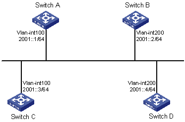

2.6  RIPng Configuration Example
As shown in Figure 2-4, all switches run RIPng. Configure Switch B to filter the route (3::/64) learnt from Switch C, which means the route will not be added to the routing table of Switch B, and Switch B will not forward it to Switch A.
II. Network diagram
Figure 2-4 Network diagram for RIPng configuration

# Display the routing table of Switch B.
[SwitchB] display ripng 1 route
   Route Flags: A - Aging, S - Suppressed, G - Garbage-collect
 Peer FE80::20F:E2FF:FE23:82F5  on Vlan-interface100
 Dest 1::/64,
     via FE80::20F:E2FF:FE23:82F5, cost  1, tag 0, A, 6 Sec
 Dest 2::/64,
 Peer FE80::20F:E2FF:FE00:100  on Vlan-interface200
 Dest 3::/64,
     via FE80::20F:E2FF:FE00:100, cost  1, tag 0, A, 11 Sec
 Dest 4::/64,
 Dest 5::/64,
# Display the routing table of Switch A.
[SwitchA] display ripng 1 route
 Peer FE80::200:2FF:FE64:8904  on Vlan-interface100
 Dest 1::/64,
     via FE80::200:2FF:FE64:8904, cost  1, tag 0, A, 31 Sec
 Dest 4::/64,
     via FE80::200:2FF:FE64:8904, cost  2, tag 0, A, 31 Sec
 Dest 5::/64,
 Dest 3::/64,
3)         Configure Switch B to filter incoming and outgoing routes.
[SwitchB] acl ipv6 number 2000
[SwitchB-acl6-basic-2000] rule deny source 3::/64
[SwitchB-acl6-basic-2000] rule permit
[SwitchB-acl6-basic-2000] quit
[SwitchB] ripng 1
[SwitchB-ripng-1] filter-policy 2000 import
[SwitchB-ripng-1] filter-policy 2000 export
[SwitchB-ripng-1] quit
# Display routing tables of Switch B and Switch A.
 Dest 1::/64,
     via FE80::20F:E2FF:FE23:82F5, cost  1, tag 0, A, 2 Sec
 Dest 2::/64,
 Dest 4::/64,
     via FE80::20F:E2FF:FE00:100, cost  1, tag 0, A, 5 Sec
 Dest 5::/64,
 Peer FE80::20F:E2FF:FE00:1235  on Vlan-interface100
 Dest 1::/64,
     via FE80::20F:E2FF:FE00:1235, cost  1, tag 0, A, 2 Sec
 Dest 4::/64,
     via FE80::20F:E2FF:FE00:1235, cost  2, tag 0, A, 2 Sec
 Dest 5::/64,

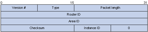

The five packets have the same packet header, which different from the OSPFv2 packet header is only 16 bytes in length, has no authentication field, but is added with an Instance ID field to support multi-instance per link.
Figure 3-1 gives the OSPFv3 packet header.
Figure 3-1 OSPFv3 packet header
Major fields:
l           Version #: Version of OSPF, which is 3 for OSPFv3.
l           Type: Type of OSPF packet, from 1 to 5 are hello, DD, LSR, LSU, and LSAck respectively.
l           Packet Length: Packet length in bytes, including header.
l           Instance ID: Instance ID for a link.
l           0: Reserved, which must be 0.

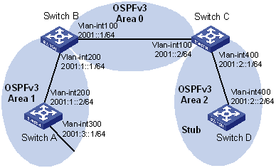

3.8  OSPFv3 Configuration Examples
3.8.1  Configuring OSPFv3 Areas
In the following figure, all switches run OSPFv3. The AS is split into three areas, in which, Switch B and Switch C act as ABRs to forward routing information between areas.
It is required to configure Area 2 as a stub area, reducing LSAs into the area without affecting route reachability.
II. Network diagram
Figure 3-2 Network diagram for OSPFv3 area configuration
1)         Configure IPv6 addresses for interfaces (omitted)
2)         Configure OSPFv3 basic functions
# Configure Switch A.
[SwitchA] ipv6
[SwitchA] ospfv3
[SwitchA-ospfv3-1] router-id 1.1.1.1
[SwitchA-ospfv3-1] quit
[SwitchA] interface vlan-interface 300
[SwitchA-Vlan-interface300] ospfv3 1 area 1
[SwitchA-Vlan-interface300] quit
[SwitchA] interface vlan-interface 200
[SwitchA-Vlan-interface200] ospfv3 1 area 1
[SwitchA-Vlan-interface200] quit
# Configure Switch B
[SwitchB] ipv6
[SwitchB] ospfv3
[SwitchB-ospf-1] router-id 2.2.2.2
[SwitchB-ospf-1] quit
[SwitchB-Vlan-interface100] ospfv3 1 area 0
[SwitchB] interface vlan-interface 200
[SwitchB-Vlan-interface200] ospfv3 1 area 1
[SwitchB-Vlan-interface200] quit
# Configure Switch C
[SwitchC] ipv6
[SwitchC] ospfv3
[SwitchC-ospfv3-1] router-id 3.3.3.3
[SwitchC-ospfv3-1] quit
[SwitchC] interface vlan-interface 100
[SwitchC-Vlan-interface100] ospfv3 1 area 0
[SwitchC-Vlan-interface100] quit
[SwitchC] interface vlan-interface 400
[SwitchC-Vlan-interface400] ospfv3 1 area 2
[SwitchC-Vlan-interface400] quit
# Configure Switch D
<SwitchD> system-view
[SwitchD] ipv6
[SwitchD] ospfv3
[SwitchD-ospfv3-1] router-id 4.4.4.4
[SwitchD-ospfv3-1] quit
[SwitchD] interface Vlan-interface 400
[SwitchD-Vlan-interface400] ospfv3 1 area 2
[SwitchD-Vlan-interface400] quit
# Display OSPFv3 neighbor information on Switch B.
[SwitchB] display ospfv3 peer
            OSPFv3 Area ID 0.0.0.0 (Process 1)
Neighbor ID    Pri   State          Dead Time   Interface      Instance ID
3.3.3.3        1     Full/DR        00:00:39    Vlan100        0
            OSPFv3 Area ID 0.0.0.1 (Process 1)
1.1.1.1         1     Full/Backup   00:00:38    Vlan200        0
# Display OSPFv3 neighbor information on Switch C.
[SwitchC] display ospfv3 peer
2.2.2.2        1     Full/Backup    00:00:39    Vlan100        0
            OSPFv3 Area ID 0.0.0.2 (Process 1)
4.4.4.4         1     Full/DR       00:00:38    Vlan400        0
# Display OSPFv3 routing table information on Switch D.
[SwitchD] display ospfv3 routing
E1 - Type 1 external route,    IA - Inter area route,    I  - Intra area route
E2 - Type 2 external route,    *  - Seleted route
            OSPFv3 Router with ID (4.4.4.4) (Process 1)
 *Destination: 2001::/64
  Type       : IA                                       Cost     : 2
  NextHop    : FE80::F40D:0:93D0:1                      Interface: Vlan400
 *Destination: 2001:1::/64
  Type       : IA                                       Cost     : 3
 *Destination: 2001:2::/64
  Type       : I                                        Cost     : 1
  NextHop    : directly-connected                       Interface: Vlan400
 *Destination: 2001:3::/64
  Type       : IA                                       Cost     : 4
3)         Configure Area 2 as a stub area
[SwitchD] ospfv3
[SwitchD-ospfv3-1] area 2
[SwitchD-ospfv3-1-area-0.0.0.2] stub
# Configure Switch C, and specify the cost of the default route sent to the stub area as 10.
[SwitchC] ospfv3
[SwitchC-ospfv3-1] area 2
[SwitchC-ospfv3-1-area-0.0.0.2] stub
[SwitchC-ospfv3-1-area-0.0.0.2] default-cost 10
# Display OSPFv3 routing table information on Switch D. You can find a default route is added, whose cost is the cost of the directly connected route plus the configured cost.
 *Destination: ::/0
  Type       : IA                                       Cost     : 11
  Type       : IA                                       Cost     : 2
  Type       : IA                                       Cost     : 3
  Type       : I                                        Cost     : 1
  Type       : IA                                       Cost     : 4
4)         Configure Area 2 as a totally stub area
# Configure Switch C, the ABR, to make Area 2 as a totally stub area.
[SwitchC-ospfv3-1-area-0.0.0.2] stub no-summary
# Display OSPFv3 routing table information on Switch D. You can find route entries are reduced. All non direct routes are removed except the default route.
 *Destination: ::/0
  Type       : IA                                       Cost     : 11
  Type       : I                                        Cost     : 1
3.8.2  Configuring OSPFv3 DR Election
In the following figure:
l           The priority of Switch A is 100, the highest priority on the network, so it will be the DR.
l           The priority of Switch C is 2, the second highest priority on the network, so it will be the BDR.
l           The priority of Switch B is 0, so it cannot become the DR.
l           RouterD has the default priority 1.
II. Network diagram
Figure 3-3 Network diagram for OSPFv3 DR election configuration
[SwitchB] ipv6
[SwitchB] ospfv3
[SwitchB-ospfv3-1] router-id 2.2.2.2
[SwitchB-ospfv3-1] quit
[SwitchB-Vlan-interface200] ospfv3 1 area 0
[SwitchC] ipv6
[SwitchC] ospfv3
[SwitchD] ipv6
[SwitchD] ospfv3
[SwitchD] interface vlan-interface 200
[SwitchD-Vlan-interface200] ospfv3 1 area 0
[SwitchD-Vlan-interface200] quit
# Display neighbor information on Switch A. You can find the switches have the same default DR priority 1. In this case, the switch with the highest Router ID is elected as the DR. Therefore, Switch D is the DR, and Switch C is the BDR.
 [SwitchA] display ospfv3 peer
2.2.2.2        1     2-Way/DROther   00:00:36    Vlan200        0
3.3.3.3        1     Full/Backup     00:00:35    Vlan100        0
4.4.4.4        1     Full/DR         00:00:33    Vlan200        0
# Display neighbor information on Switch D. You can find the neighbor states between Switch D and other switches are all full.
 [SwitchD] display ospfv3 peer
1.1.1.1        1     Full/DROther    00:00:30    Vlan100        0
2.2.2.2        1     Full/DROther    00:00:37    Vlan200        0
3.3.3.3        1     Full/Backup     00:00:31    Vlan100        0
3)         Configure DR priorities for interfaces.
# Configure the DR priority of VLAN-interface 100 as 100 on Switch A.
[SwitchA] interface Vlan-interface 100
[SwitchA-Vlan-interface100] ospfv3 dr-priority 100
# Configure the DR priority of VLAN-interface 200 as 0 on Switch B.
[SwitchB-Vlan-interface200] ospfv3 dr-priority 0
#Configure the DR priority of Switch C as 2.
[SwitchC] interface Vlan-interface 100
[SwitchC-Vlan-interface100] ospfv3 dr-priority 2
# Display neighbor information on Switch A. You can find DR priorities have been updated, but DR and BDR are not changed.
2.2.2.2        0     2-Way/DROther   00:00:38    Vlan200        0
3.3.3.3        2     Full/Backup     00:00:32    Vlan100        0
4.4.4.4        1     Full/DR         00:00:36    Vlan200        0
#Display neighbor information on Switch D. You can find Switch D is still the DR.
1.1.1.1        100   Full/DROther    00:00:33    Vlan100        0
2.2.2.2        0     Full/DROther    00:00:36    Vlan200        0
3.3.3.3        2     Full/Backup     00:00:40    Vlan100        0
4)         Restart DR/BDR election
# Use the shutdown and undo shutdown commands on interfaces to restart DR/BDR election (omitted).
# Display neighbor information on Switch A. You can find Switch C becomes the BDR.
2.2.2.2        0     Full/DROther    00:00:31    Vlan200        0
3.3.3.3        2     Full/Backup     00:00:39    Vlan100        0
4.4.4.4        1     Full/DROther    00:00:37    Vlan200        0
# Display neighbor information on Switch D. You can find Switch A becomes the DR.
1.1.1.1        100   Full/DR         00:00:34    Vlan100        0
2.2.2.2        0     2-Way/DROther   00:00:34    Vlan200        0

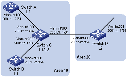

4.5  IPv6 IS-IS Configuration Example
As shown in Figure 4-1, Switch A, Switch B, Switch C and Switch D reside in the same autonomous system, and all are enabled with IPv6.
Switch A and Switch B are Level-1 switches, Switch D is a Level-2 switch, and Switch C is a Level-1-2 switch. Switch A, Switch B, and Switch C are in area 10, while Switch D is in area 20.
II. Network diagram
Figure 4-1 Network diagram for IPv6 IS-IS basic configuration
2)         Configure IPv6 IS-IS
[SwitchA] isis 1
[SwitchA-isis-1] is-level level-1
[SwitchA-isis-1] network-entity 10.0000.0000.0001.00
[SwitchA-isis-1] ipv6 enable
[SwitchA-isis-1] quit
[SwitchA-Vlan-interface100] isis ipv6 enable 1
# Configure Switch B.
[SwitchB] isis 1
[SwitchB-isis-1] is-level level-1
[SwitchB-isis-1] network-entity 10.0000.0000.0002.00
[SwitchB-isis-1] ipv6 enable
[SwitchB-isis-1] quit
[SwitchB-Vlan-interface200] isis ipv6 enable 1
# Configure Switch C.
[SwitchC] isis 1
[SwitchC-isis-1] network-entity 10.0000.0000.0003.00
[SwitchC-isis-1] ipv6 enable
[SwitchC-isis-1] quit
[SwitchC-Vlan-interface100] isis ipv6 enable 1

# Configure Switch D.
[SwitchD] isis 1
[SwitchD-isis-1] is-level level-2
[SwitchD-isis-1] network-entity 20.0000.0000.0004.00
[SwitchD-isis-1] ipv6 enable
[SwitchD-isis-1] quit
[SwitchD] interface vlan-interface 300
[SwitchD-Vlan-interface300] isis ipv6 enable 1
[SwitchD-Vlan-interface300] quit
[SwitchD] interface vlan-interface 301
[SwitchD-Vlan-interface301] isis ipv6 enable 1
[SwitchD-Vlan-interface301] quit

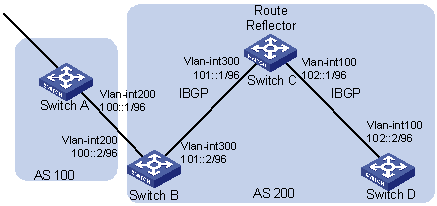

5.7.4  Configuring an IPv6 BGP Route Reflector
Follow these steps to configure an IPv6 BGP route reflector:
To do...
Use the command...
Remarks
Enter system view
Enter BGP view
bgp as-number
Required
Enter IPv6 address family view
ipv6-family
Configure the router as a route reflector and specify a peer/peer group as a client
peer { ipv6-group-name | ipv6-address } reflect-client
Required
Not configured by default
Enable route reflection between clients
reflect between-clients
Optional
Enabled by default
 Configure the cluster ID of the route reflector
reflector cluster-id cluster-id
Optional
 By default, a route reflector uses its router ID as the cluster ID
&  Note:
l      In general, since the route reflector forwards routing information between clients, it is not required to make clients of a route reflector fully meshed. If clients are fully meshed, it is recommended to disable route reflection between clients to reduce routing costs.

5.9.2  IPv6 BGP Route Reflector Configuration
Switch B receives an EBGP update and sends it to Switch C, which is configured as a route reflector with two clients: Switch B and Switch D.
Switch B and Switch D need not establish an IBGP connection because Switch C reflects updates between them.
II. Network diagram
Figure 5-2 Network diagram for IPv6 BGP route reflector configuration
1)         Configure IPv6 addresses for VLAN interfaces (omitted)
2)         Configure IPv6 BGP basic functions
[SwitchA] ipv6
[SwitchA] bgp 100
[SwitchA-bgp] router-id 1.1.1.1
[SwitchA-bgp] ipv6-family
[SwitchA-bgp-af-ipv6] peer 100::2 as-number 200
[SwitchA-bgp-af-ipv6] network 1:: 64
#Configure Switch B.
[SwitchB] ipv6
[SwitchB] bgp 200
[SwitchB-bgp] router-id 2.2.2.2
[SwitchB-bgp] ipv6-family
[SwitchB-bgp-af-ipv6] peer 100::1 as-number 100
[SwitchB-bgp-af-ipv6] peer 101::1 as-number 200
[SwitchB-bgp-af-ipv6] peer 101::1 next-hop-local
[SwitchC] ipv6
[SwitchC] bgp 200
[SwitchC-bgp] router-id 3.3.3.3
[SwitchC-bgp] ipv6-family
[SwitchC-bgp-af-ipv6] peer 101::2 as-number 200
[SwitchC-bgp-af-ipv6] peer 102::2 as-number 200
[SwitchD] ipv6
[SwitchD] bgp 200
[SwitchD-bgp] router-id 4.4.4.4
[SwitchD-bgp] ipv6-family
[SwitchD-bgp-af-ipv6] peer 102::1 as-number 200
3)         Configure route reflector
# Configure Switch C as a route reflector, Switch B and Switch D as its clients.
[SwitchC-bgp-af-ipv6] peer 101::2 reflect-client
[SwitchC-bgp-af-ipv6] peer 102::2 reflect-client
Use the display bgp ipv6 routing-table command on Switch B and Switch D respectively, you can find both of them have learned the network 1::/64.

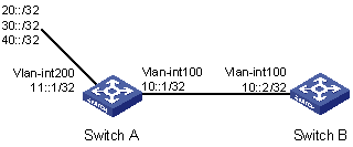

6.5  Routing Policy Configuration Example
6.5.1  Applying Routing Policy When Redistributing IPv6 Routes
l           Enable RIPng on Switch A and Switch B.
l           Configure three static routes on Switch A and apply a routing policy when redistributing static routes, making routes 20::0/32 and 40::0/32 pass, routes in 30::0/32 filtered out.
l           Display RIPng routing table information on Switch B to verify the configuration.
II. Network diagram
Figure 6-1 Network diagram for routing policy application to route redistribution
1)         Configure Switch A
# Configure IPv6 addresses for VLAN-interface 100 and VLAN-interface 200.
[SwitchA] ipv6
[SwitchA-Vlan-interface100] ipv6 address 10::1 32
[SwitchA-Vlan-interface200] ipv6 address 11::1 32
# Enable RIPng on VLAN-interface 100.
[SwitchA-Vlan-interface100] ripng 1 enable
# Configure three static routes.
[SwitchA] ipv6 route-static 20:: 32 11::2
[SwitchA] ipv6 route-static 30:: 32 11::2
[SwitchA] ipv6 route-static 40:: 32 11::2
# Configure routing policy.
[SwitchA] ip ipv6-prefix a index 10 permit 30:: 32
[SwitchA] route-policy static2ripng deny node 0
[SwitchA-route-policy] if-match ipv6 address prefix-list a
[SwitchA-route-policy] quit
[SwitchA] route-policy static2ripng permit node 10
# Enable RIPng and redistribute static routes.
[SwitchA] ripng
[SwitchA-ripng-1] import-route static route-policy static2ripng
2)         Configure Switch B.
# Configure the IPv6 address for VLAN-interface 100.
[SwitchB] ipv6
[SwitchB-Vlan-interface100] ipv6 address 10::2 32
[SwitchB-Vlan-interface100] ripng 1 enable
# Enable RIPng.
[SwitchB] ripng
# Display RIPng routing table information.
[SwitchB-ripng-1] display ripng 1 route
 Peer FE80::7D58:0:CA03:1  on Vlan-interface 100
 Dest 10::/32,
     via FE80::7D58:0:CA03:1, cost  1, tag 0, A, 18 Sec
 Dest 20::/32,
     via FE80::7D58:0:CA03:1, cost  1, tag 0, A, 8 Sec
 Dest 40::/32,
     via FE80::7D58:0:CA03:1, cost  1, tag 0, A, 3 Sec
