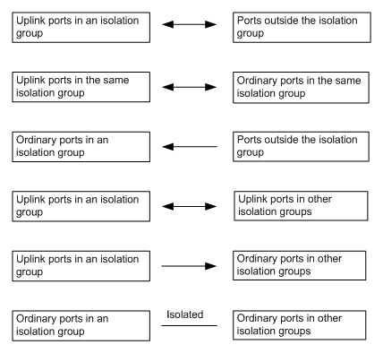

Port isolation is independent of the VLAN the port belongs to.
l           For ports belonging to different VLANs, Layer 2 data can pass only from the ordinary port to the uplink port in the same isolation group unidirectionally.
l           Within the same VLAN, there are two types of connectivity of Layer 2 data on ports within and outside the isolation group, as shown in Figure 2-1.
Figure 2-1 Connectivity of layer 2 data between ports inside and outside an isolation group on a device supporting uplink port
&  Note:
The arrows in the above figure indicate the transmission direction of Layer 2 data.
