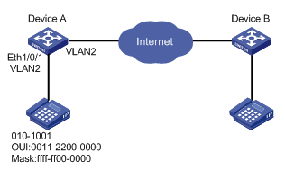

2.4  Voice VLAN Configuration Examples
2.4.1  Automatic Voice VLAN Mode Configuration Example
I. Network requirement
l           Create VLAN 2 and configure it as a voice VLAN with an aging time of 100 minutes.
l           The voice traffic sent by the IP phones is tagged. Configure Ethernet 1/0/1 as a Hybrid port and as the access port, with VLAN 6 as the default VLAN.
l           The device allows voice packets from Ethernet 1/0/1 with an OUI address of 0011-2200-0000 and a mask of ffff-ff00-0000 to be forwarded through the voice VLAN.
II. Network diagram
Figure 2-1 Network diagram for automatic voice VLAN mode configuration
III. Configuration procedure
 # Create VLAN 2 and VLAN 6.
<DeviceA> system-view
[DeviceA] vlan 2
[DeviceA-vlan2] quit
[DeviceA] vlan 6
[DeviceA-vlan6] quit
# Configure the voice VLAN aging time.
[DeviceA] voice vlan aging 100
# Configure the OUI address 0011-2200-0000 as the legal address of the voice VLAN.
[DeviceA] voice vlan mac-address 0011-2200-0000 mask ffff-ff00-0000
# Enable the voice VLAN feature globally.
[DeviceA] voice vlan 2 enable
# Configure the voice VLAN mode on Ethernet 1/0/1 as automatic. (Optional, by default, the voice VLAN mode on a port is automatic mode)
[DeviceA] interface ethernet 1/0/1
[DeviceA-Ethernet1/0/1] voice vlan mode auto
# Configure Ethernet 1/0/1 as a Hybrid port.
[DeviceA-Ethernet1/0/1] port link-type access
 Please wait... Done.
[DeviceA-Ethernet1/0/1] port link-type hybrid
# Configure the default VLAN of the port as VLAN 6 and allow packets from VLAN 6 to pass through the port.
[DeviceA-Ethernet1/0/1] port hybrid pvid vlan 6
[DeviceA-Ethernet1/0/1] port hybrid vlan 6 tagged
# Enable the voice VLAN feature on the port.
[DeviceA-Ethernet1/0/1] voice vlan enable
[DeviceA-Ethernet1/0/1] return
IV. Verification
# Display information about the OUI addresses, OUI address masks, and descriptive strings.
<DeviceA> display voice vlan oui
Oui Address     Mask            Description
0001-e300-0000  ffff-ff00-0000  Siemens phone
0003-6b00-0000  ffff-ff00-0000  Cisco phone
0004-0d00-0000  ffff-ff00-0000  Avaya phone
0011-2200-0000  ffff-ff00-0000
0060-b900-0000  ffff-ff00-0000  Philips/NEC phone
00d0-1e00-0000  ffff-ff00-0000  Pingtel phone
00e0-7500-0000  ffff-ff00-0000  Polycom phone
00e0-bb00-0000  ffff-ff00-0000  3com phone
# Display the current Voice VLAN state.
<DeviceA> display voice vlan state
Voice VLAN status: ENABLE
 Voice VLAN ID: 2
 Voice VLAN security mode: Security
 Voice VLAN aging time: 100 minutes
 Voice VLAN enabled port and its mode:
 PORT                     MODE
 Ethernet1/0/1              AUTO
<DeviceA>

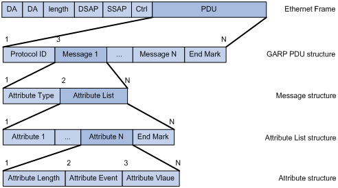

III. GARP message format
The following figure illustrates the GARP message format.
Figure 3-1 GARP message format
Table 3-1 describes the GARP message fields.
Table 3-1 Description on the GARP message fields
Field
Description
Value
Protocol ID
Protocol identifier for GARP
1
Message
One or multiple messages, each containing an attribute type and an attribute list
Attribute Type
Defined by the concerned GARP application
0x01 for GVRP, indicating the VLAN ID attribute
Attribute List
Contains one or multiple attributes
Attribute
Consists of an Attribute Length, an Attribute Event, and an Attribute Value
Attribute Length
Number of octets occupied by an attribute, inclusive of the attribute length field
2 to 255 (in bytes)
Attribute Event
Event described by the attribute
0: LeaveAll event
1: JoinEmpty event
2: JoinIn event
3: LeaveEmpty event
4: LeaveIn event
5: Empty event
Attribute Value
Attribute value
VLAN ID for GVRP
If the Attribute Event is LeaveAll, Attribute Value is omitted.
End Mark
Indicates the end of a GARP PDU
0x00
