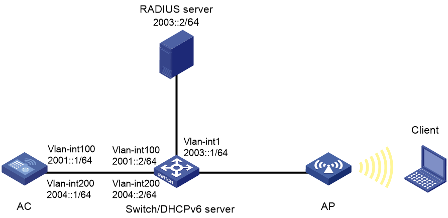

As shown in Figure 1, the switch acts as a DHCPv6 server to assign IPv6 addresses to the AP and the client. Configure EAD authentication on the AC to authenticate the client.
Use the serial ID labeled on the AP's rear panel to specify an AP.

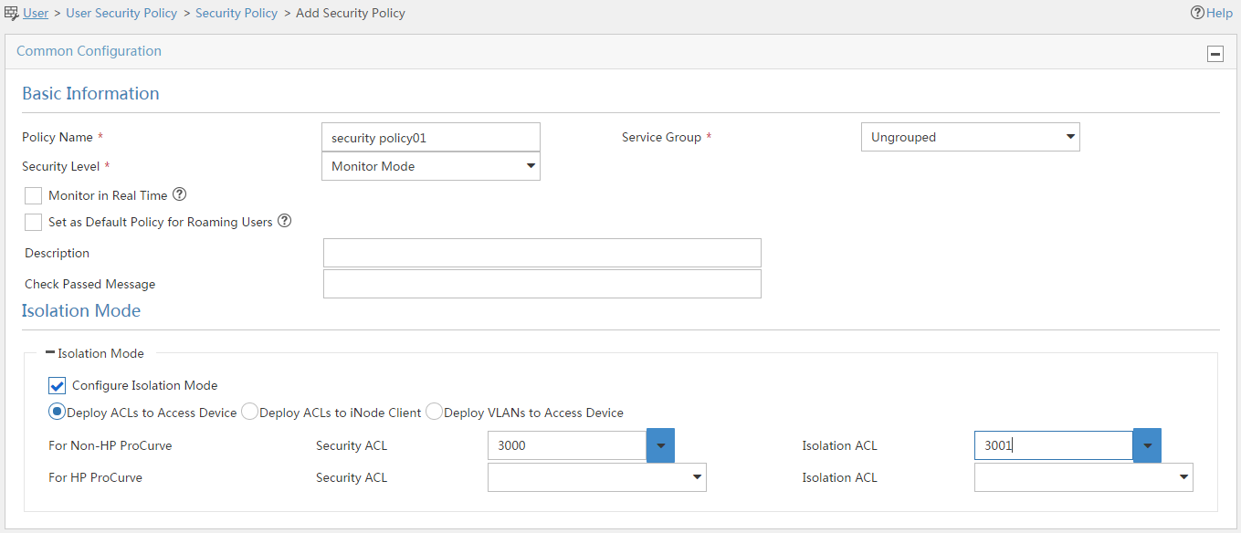

5. Configure ACLs:
# Create IPv6 advanced ACL 3000 and enter its view.
[AC] acl ipv6 advanced 3000
# Create an ACL rule to permit all IPv6 packets.
[AC-acl-ipv6-adv-3000] rule permit ipv6
[AC-acl-ipv6-adv-3000] quit
# Create IPv6 advanced ACL 3001 and enter its view.
[AC] acl ipv6 advanced 3001
# Create an ACL rule to permit all UDP packets.
[AC-acl-ipv6-adv-3001] rule permit udp
# Create an ACL rule to deny all TCP packets.
[AC-acl-ipv6-adv-3001] rule deny tcp
[AC-acl-ipv6-adv-3001] quit

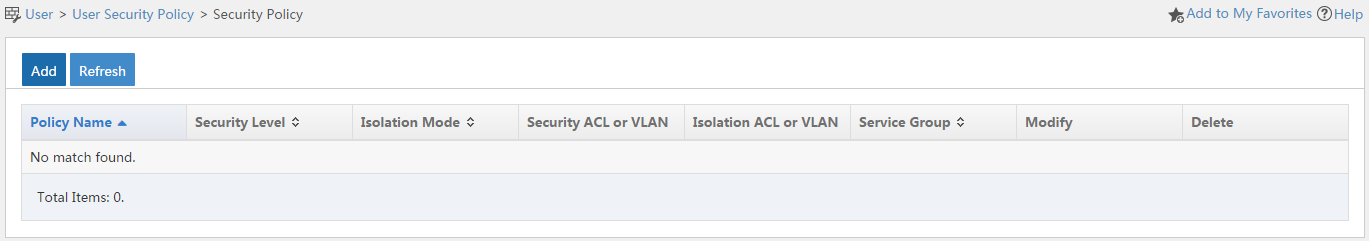

Configuring a security policy
1. Click the User tab.
2. From the navigation tree, select User Security Policy > Security Policy.
The security policy page opens, as shown in Figure 3.
3. Click Add.
The Add Security Policy page opens.
4. Configure security policy parameters, as shown in Figure 4:
a. In the Policy Name field, enter security policy01.
b. Select Monitor Mode from the Security Level list.
c. Select Configure Isolation Mode.
d. Select Deploy ACLs to Access Device.
e. Configure 3000 and 3001 for the Security ACL and Isolation ACL fields, respectively.
f. Use the default settings of other parameters.
g. Click OK.
Figure 4 Adding an security policy

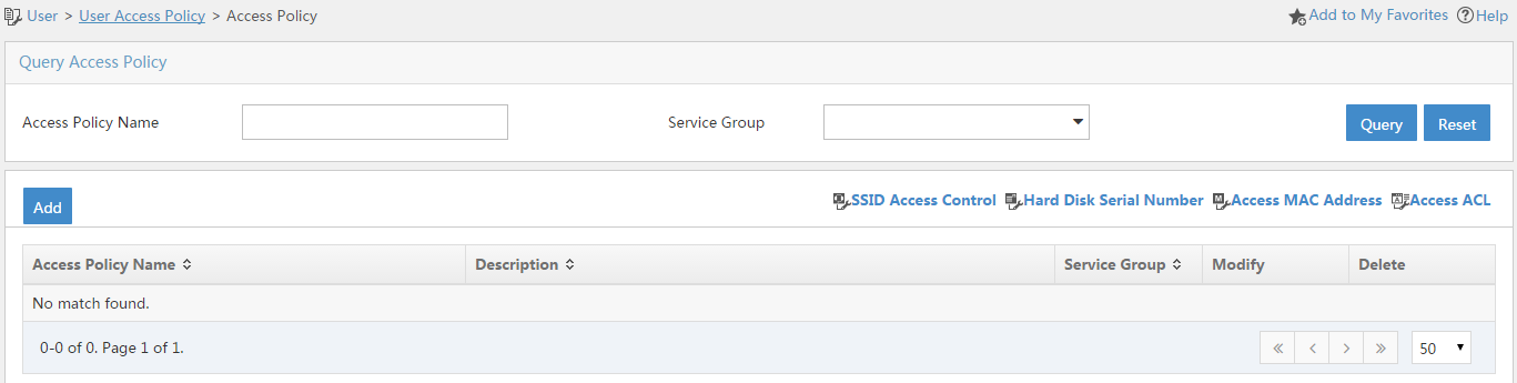

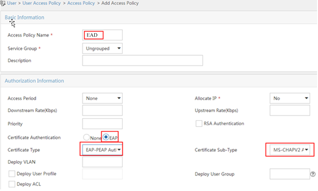

Configuring an access policy
2. From the navigation tree, select User Access Policy > Access Policy.
The Access Policy page opens, as shown in Figure 5.
3. Click Add.
The Add Access Policy page opens.
4. Configure access policy parameters, as shown in Figure 6:
a. In the Access Policy Name field, enter EAD.
b. Select EAP for the Certificate Authentication field.
c. Select EAP-PEAP Auth from the Certificate Type list, and select MS-CHAPV2 Auth from the Certificate Sub-Type list.
d. Use the default settings of other parameters.
e. Click OK.
Figure 6 Adding an access policy

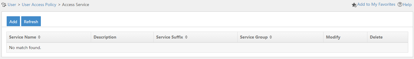

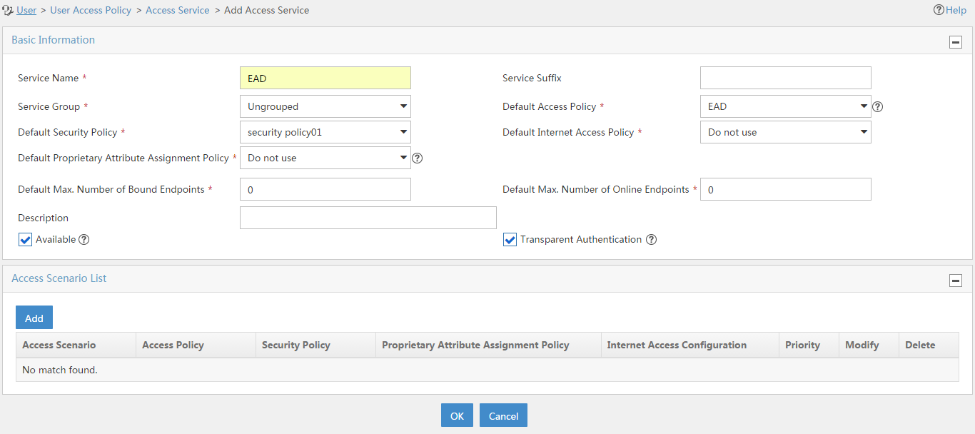

Adding an access service
2. From the navigation tree, select User Access Policy > Access Service.
The Access Service page opens, as shown in Figure 7.
3. Click Add.
The Add Access Service page opens.
4. Configure access service parameters, as shown in Figure 8:
a. Enter EAD in the Service Name field.
b. Select security policy01 from the Default Security Policy list.
c. Select EAD from the Default Access Policy list.
e. Click OK.
Figure 8 Adding an access service

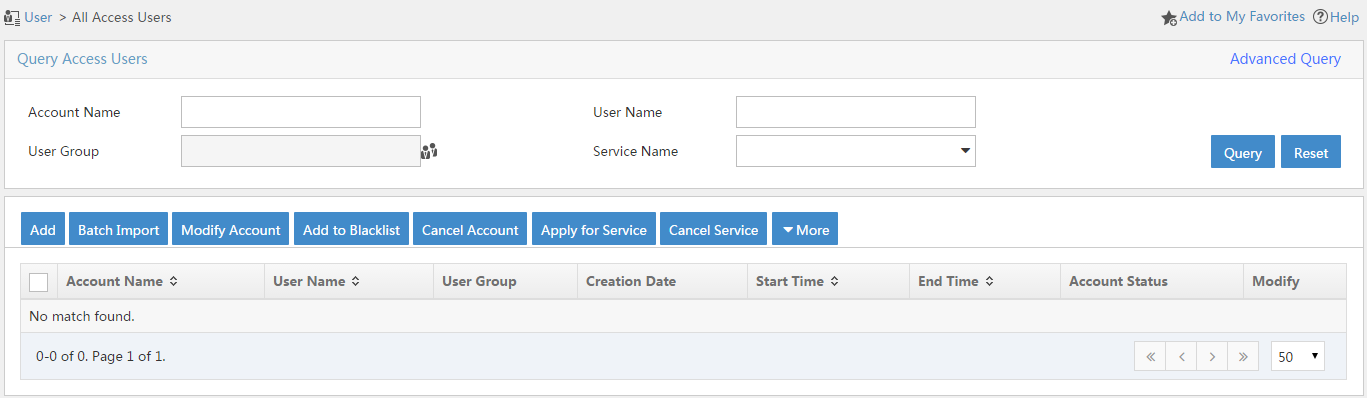

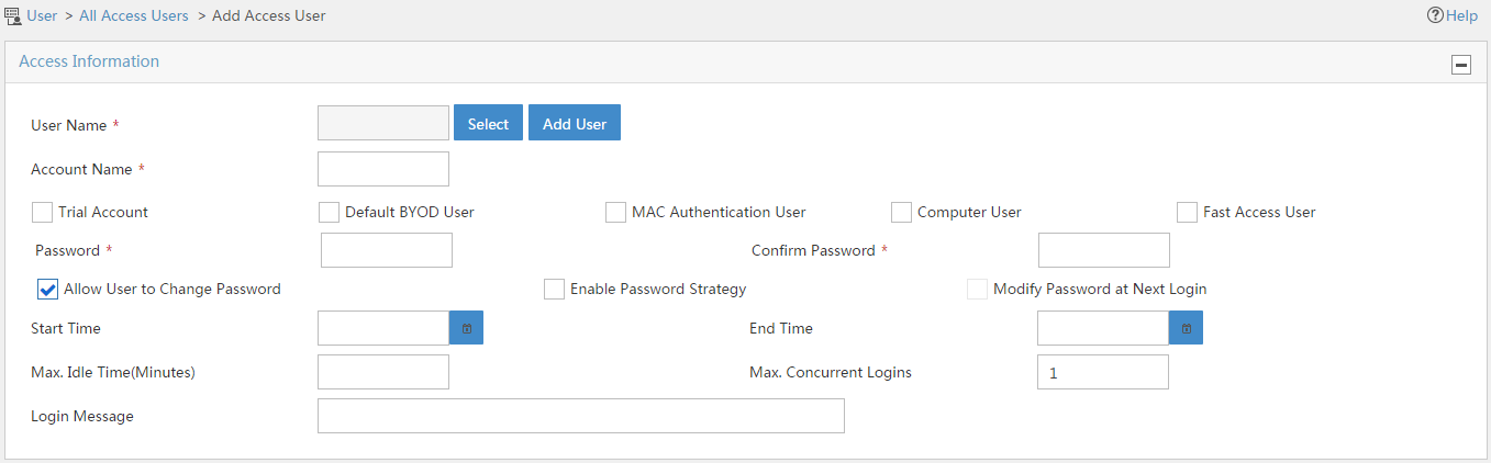

Adding an access user account
2. From the navigation tree, select Access User > Access User.
The All Access Users page opens, as shown in Figure 9.
Figure 9 All Access Users page

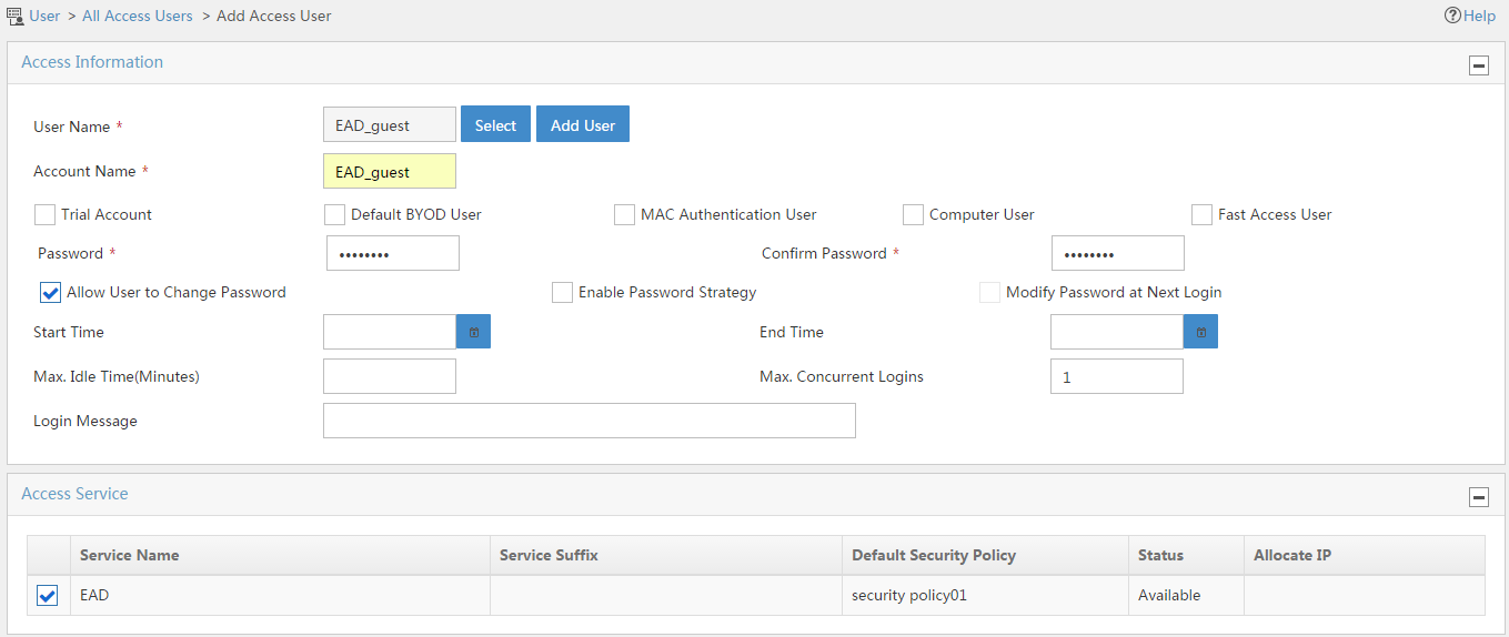

3. Click Add.
The Add Access User page opens, as shown in Figure 10.
Figure 10 Add Access User page

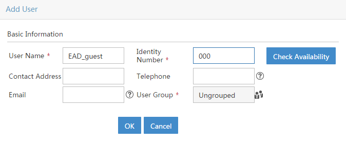

4. Configure access user parameters, as shown in Figure 11:
a. Click Add User next to the User Name field. On the Add User page that opens, enter EAD_guest in the User Name field, enter an ID number in the Identity Number field, and then click OK, as shown in Figure 12.
b. Enter EAD_guest in the Account Name field.
c. Enter 12345678 in the Password and Confirm Password fields.
d. In the access service list, select EAD.
e. Use the default settings of other parameters.
f. Click OK.
Figure 11 Adding an access user account
