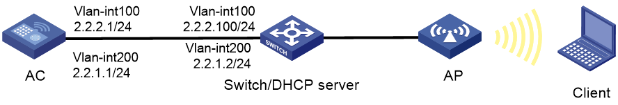

As shown in Figure 1, the switch acts as a DHCP server to assign IP addresses to the AP and the client.
Configure the AC to meet the following requirements:
· Perform local 802.1X authentication to control the network access of the client.
· Use open system authentication to authenticate the client at the data link layer. This is the default authentication method.

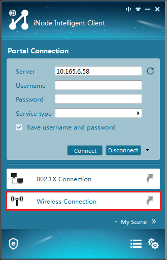

Connecting to the wireless network
1. Run the iNode client, and then click Wireless Connection, as shown in Figure 2.

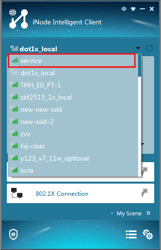

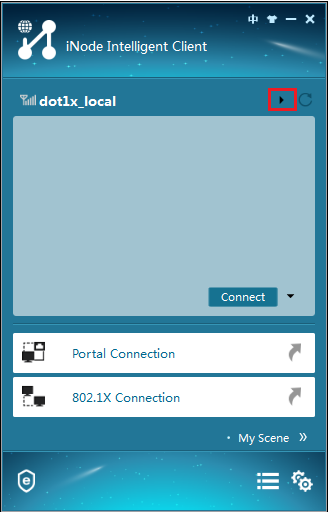

2. Click triangle icon in the wireless connection title bar, as shown in Figure 3.
3. Double-click the wireless service with SSID service, as shown in Figure 4.
Figure 4 Selecting a wireless service

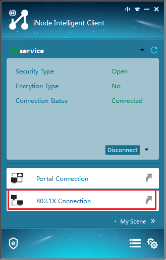

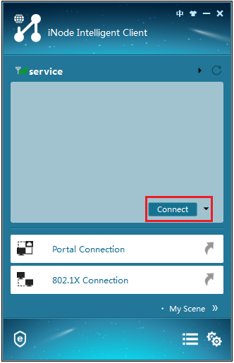

4. Click Connect, as shown in Figure 5.
Figure 5 Connecting to the wireless network

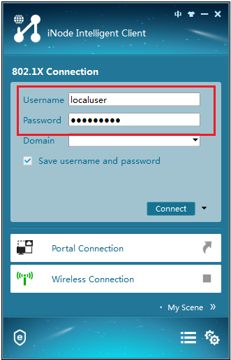

Configuring 802.1X authentication
1. Click 802.1X Connection, as shown in Figure 6.
2. Enter username localuser and password localpass, as shown in Figure 7.
Figure 7 Entering the username and password

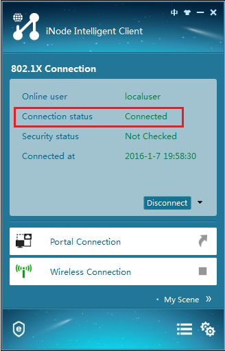

6. Click Connect.
The iNode client displays the connection state as shown in Figure 8.
Figure 8 Successful 802.1X authentication
