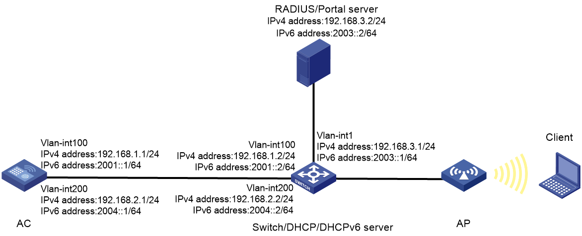

As shown in Figure 1, the switch acts as both a DHCP server and a DHCPv6 server. The AP and the client obtain IPv4 and IPv6 addresses from the switch.
To implement remote portal authentication, perform the following tasks:
· Configure direct portal authentication.
· Configure a portal authentication server and a portal Web server on IMC.
· Configure a RADIUS server as the authentication server and accounting server.

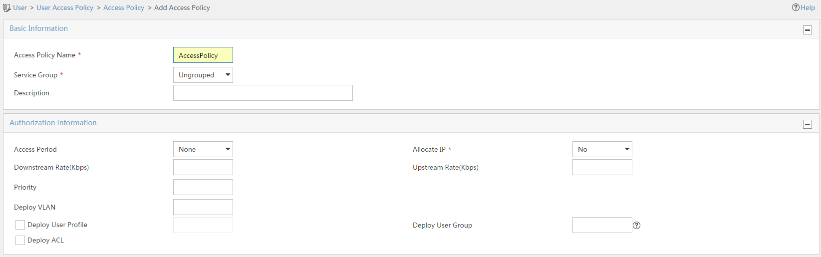

2. Add an access policy.
a. From the navigation tree, select User Access Policy > Access Policy.
b. Click Add.
The Add Access Policy page opens.
c. Enter the access policy name.
d. Select a service group. This example uses the default group (Ungrouped).
e. Use the default settings for other parameters.
f. Click OK.
Figure 3 Adding an access policy

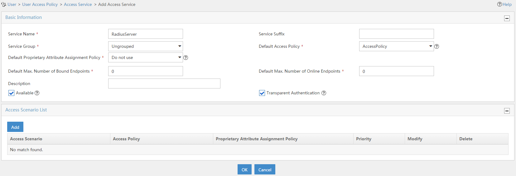

3. Add an access service.
a. From the navigation tree, select User Access Policy > Access Service.
b. Click Add.
The Add Access Service page opens.
c. Enter the service name.
d. Select the access policy configured in the previous step as the default access policy.
f. Click OK.
Figure 4 Adding an access service

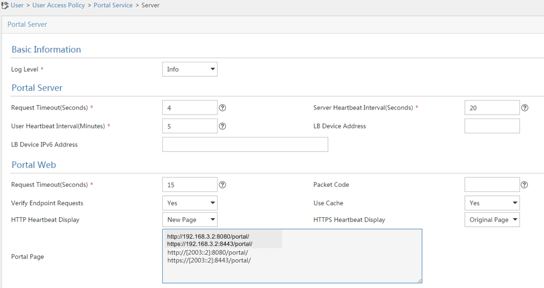

Configuring the portal server
1. Configure the portal authentication server:
a. From the navigation tree, select User Access Policy > Portal Service > Server to open the portal server configuration page, as shown in Figure 6.
b. Configure the portal server parameters as needed.
This example uses the default settings.
c. Click OK.
Figure 6 Configuring the portal server

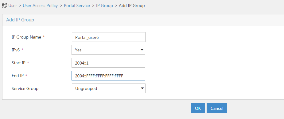

2. Configure IP address groups:
a. From the navigation tree, select User Access Policy > Portal Service > IP Group.
b. Click Add.
The Add IP Group page opens.
c. Enter an IP group name.
d. Select No from the IPv6 field for an IPv4 address group and Yes for an IPv6 address group.
e. Enter the start IP address and end IP address of the IP group.
Make sure the client IP address is in the IP group.
f. Select a service group.
This example uses the default group Ungrouped.
g. Select Normal from the Action list.
This step is required only for adding an IPv4 address group.
h. Click OK.
Figure 7 Adding an IPv4 address group
Figure 8 Adding an IPv6 address group

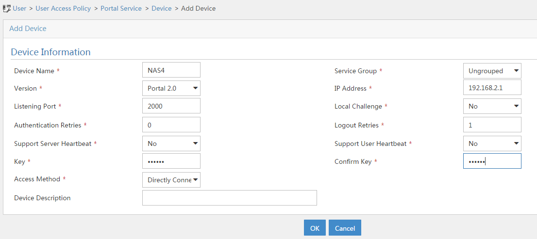

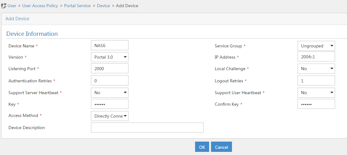

3. Add portal devices:
a. From the navigation tree, select User Access Policy > Portal Service > Device.
b. Click Add.
The Add Device page opens.
c. Enter a device name.
d. Select a portal version.
For adding an IPv4 portal device, select Portal 2.0. For adding an IPv6 portal device, select Portal 3.0.
e. Enter the IP address of the AC's interface connected to the client.
f. Set whether to support the portal server heartbeat and user heartbeat functions.
In this example, select No for both Support Server Heartbeat and Support User Heartbeat.
g. Enter the key, which must be the same as that configured on the AC.
h. Select Directly Connected for Access Method.
i. Use the default settings for other parameters.
j. Click OK.
Figure 9 Adding an IPv4 portal device
Figure 10 Adding an IPv6 portal device

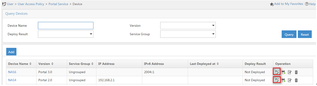

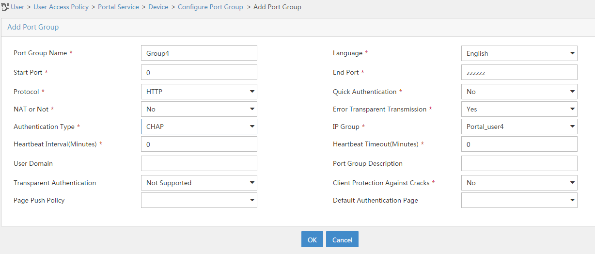

4. Associate the portal devices with the IP address groups:
a. Click the Port Group icon in the Operation field of devices NAS4 and NAS6, as shown in Figure 11.
b. Click Add to open the Add Port Group page.
c. Enter the port group name.
d. Select the configured IP address group.
The IP address used by the user to access the network must be within this IP address group.
f. Click OK.
Figure 12 Adding an IPv4 port group
Figure 13 Adding an IPv6 port group
