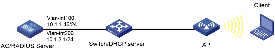

Example: Configuring local RADIUS-based 802.1X authentication in EAP relay mode
· The switch acts as a DHCP server to assign IP addresses to the AP and the client.
· The AC acts as both the access device and RADIUS server for the client.
· When the client accesses a wireless service, it must pass 802.1X EAP-PEAP authentication and obtain the required authorization information.
Configure the AC to meet the following requirements:
· Use the local RADIUS server to perform authentication and authorization for wireless 802.1X users.
· Use open system authentication to authenticate the client at the data link layer. This is the default authentication method.
· Use the 802.1X AKM mode to secure data transmission between the client and the AP.
· Use CCMP as the cipher suite.
Use the serial ID labeled on the AP's rear panel to specify an AP.
