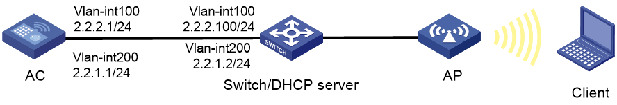

As shown in Figure 1, an AP is attached to a PoE port on a switch, which acts as a DHCP server to assign IP addresses to the AP and the client.
Configure the AC to meet the following requirements:
· The AC first performs local MAC authentication for the client.
¡ If the client fails the MAC authentication, the AC stops authenticating the client.
¡ If the client passes the MAC authentication, the AC performs local 802.1X authentication for the client.
The client can access the network only after it passes both MAC authentication and 802.1X authentication.
· The AC uses open system authentication to authenticate the client at the data link layer. This is the default authentication method.

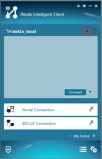

Configuring the iNode client

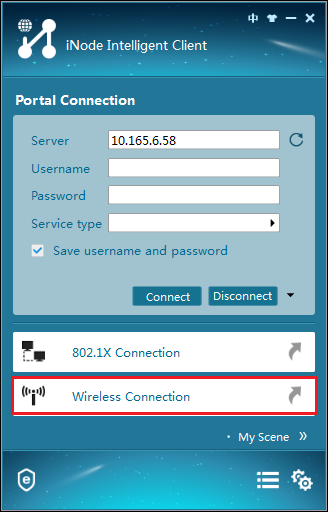

1. Run the iNode client and click Wireless Connection, as shown in Figure 2. In this example, the client version is iNode PC 7.1.

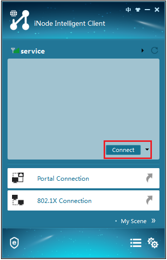

2. Click the inverted triangle icon at the upper right corner of the page, as shown in Figure 3.

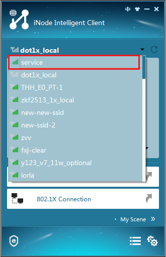

3. Double-click the wireless service with the SSID of service, as shown in Figure 4.
Figure 4 Selecting an wireless service

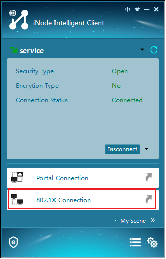

4. Click Connect as shown in Figure 5.
Figure 5 Connecting to the wireless network
5. Click 802.1X Connection as shown in Figure 6.

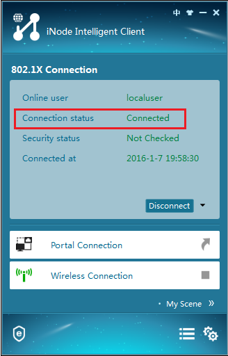

6. Enter a username and password as shown in Figure 7. In this example, the username is localuser and the password is localpass.
Figure 7 Entering the username and password

9. Return to the iNode 802.1X connection page.
10. Click Connect.
The iNode client displays the connection state as shown in Figure 8.
Figure 8 Successful 802.1X authentication
# Use a client with a MAC address other than 3ca9f4144c20 to visit the Internet. Verify the following items:
· The client cannot pass MAC authentication.
· The AC does not perform 802.1X authentication for the client after the client fails MAC authentication.
· The client cannot visit the Internet.
# Use the client with MAC address 3ca9f4144c20 to visit the Internet. Verify that the client can access the Internet after it passes both MAC authentication and 802.1X authentication. (Details not shown.)
# On the AC, display online 802.1X user information to verify that the 802.1X user has come online.
[AC] display dot1x connection
User MAC address : 0015-00bf-e84d
AP name : office
Radio ID : 1
SSID : service
BSSID : 741f-4ad4-1fe0
Username : localuser
Authentication domain : bbb
IPv4 address : 2.2.1.3
Authentication method : CHAP
Initial VLAN : 200
Authorization VLAN : 200
Authorization ACL number : N/A
Authorization user profile : N/A
Termination action : N/A
Session timeout period : N/A
Online from : 2019/12/04 17:37:55
