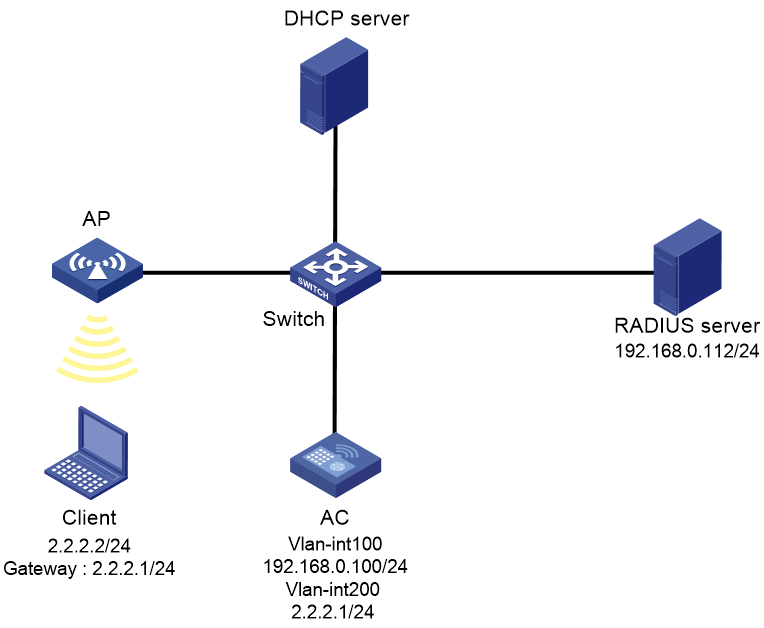

As shown in Figure 1, the AP and the client obtain IP addresses from the DHCP server.
·     Configure the access device AC to also act as the portal Web server and the portal authentication server.
·     Use the RADIUS server as both the authentication server and the authorization server.
·     Configure direct portal authentication on the AC.
Figure 1 Network diagram
