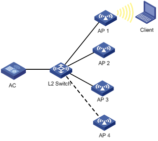

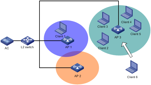

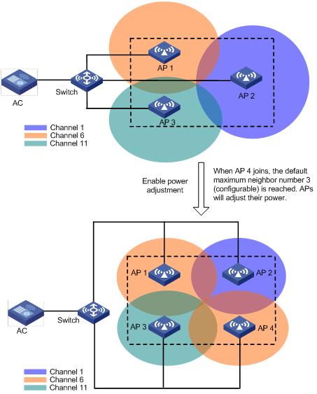

Transmit power control
Traditionally, an AP uses the maximum power to cover an area as large as possible. This method, however, affects the operation of surrounding wireless devices. Transmit power control (TPC) is used to select a proper transmission power for each AP to satisfy both coverage and usage requirements.
Whether the transmission power of an AP is increased or decreased is determined by these factors: the maximum number of neighbors (detected neighbors that are managed by the same AC), the neighbor AP that performs power detection, and the power adjustment threshold.
As shown in Figure 1, APs 1, 2 and 3 cover an area. When AP 4 joins, the default maximum neighbor number 3 (configurable) is reached. Among all the neighbors AP 2, AP 3, and AP 4 of AP 1, the signal strength of AP 4 is the third, so AP 4 becomes the AP that performs power detection. If AP 4 detects that the power of AP 1 is –90 dBm, which is lower than the default power adjustment threshold –80 dBm (configurable), AP 1 will increase its transmission power. If AP 4 detects that the power of AP 1 is –70 dBm, which is higher than the power adjustment threshold –80 dBm, AP 1 will decrease its transmission power.
·     The maximum number of neighbors and the neighbor AP that performs power detection are configured with the dot11a adjacency-factor and dot11bg adjacency-factor commands.
·     The adjusted transmission power cannot be smaller than the minimum transmission power.
Figure 1 Power reduction

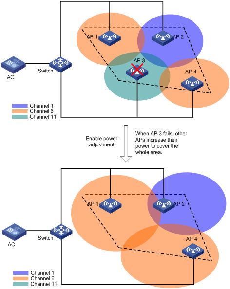

As shown in Figure 2, when AP 3 fails or goes offline, the other APs increase their transmission power to cover the signal blackhole.
Figure 2 Power increasing

Configuring TPC
·     Make sure the power is not locked (with the power lock command) before enabling TPC. Otherwise TPC does not work.
·     If you enable TPC, and then configure the power lock command, the last selected power is locked.
·     For more information about the power lock command, see WLAN Command Reference.

3.     Configure the maximum number of neighbors and specify the neighbor AP that performs power detection.
dot11a adjacency-factor neighbor
Optional.
By default, the maximum number of neighbors is 3, and the neighbor AP that performs power detection is the AP whose signal strength is the third among all neighbors.
dot11bg adjacency-factor neighbor

Load balancing dynamically adjusts loads among APs to ensure adequate bandwidth for clients. It is mainly used in high-density WLAN networks.
Requirement of load-balancing implementation

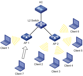

As shown in Figure 3, Client 6 wants to associate with AP 3. AP 3 has reached its maximum load, so it rejects the association request. Then, Client 6 tries to associate with AP 1 or AP 2, but it cannot receive signals from these two APs, so it has to resend an association request to AP 3.
Therefore, to implement load-balancing, the APs must be managed by the same AC, and the clients can find the APs.
Figure 3 Requirement of load-balancing implementation
Load-balancing modes
The AC supports two load balancing modes, session mode and traffic mode.
·     Session mode load-balancing:
Session-mode load balancing is based on the number of clients associated with the AP/radio.
As shown in Figure 4, Client 1 is associated with AP 1, and Client 2 through Client 6 are associated with AP 2. The AC has session-mode load balancing configured: the maximum number of sessions is 5 and the maximum session gap is 4. Then, Client 7 sends an association request to AP 2. The maximum session threshold and session gap have been reached on AP 2, so it rejects the request. At last, Client 7 associates with AP 1.
Figure 4 Network diagram for session-mode load balancing

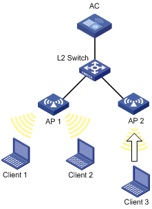

·     Traffic mode load-balancing:
Traffic snapshot is considered for traffic mode load balancing.

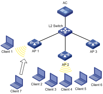

As shown in Figure 5, Client 1 and Client 2 that run 802.11g are associated with AP 1. The AC has traffic-mode load balancing configured: the maximum traffic threshold is 10% and the maximum traffic gap is 20%. Then, Client 3 wants to access the WLAN through AP 1. The maximum traffic threshold and traffic gap (between AP 1 and AP 2) have been reached on AP 1, so it rejects the request. At last, Client 3 associates with AP 2.
Figure 5 Network diagram for traffic-mode load balancing

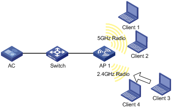

Configuring band navigation
Band navigation enables APs to prefer accepting dual-band (2.4 GHz and 5 GHz) clients on their 5 GHz radio because the 2.4 GHz band is often congested, increasing overall network performance.
When band navigation is enabled, the AP directs clients to its 2.4 GHz or 5 GHz radio by following these principles:
·     The AP associates to a 2.4 GHz client on its 2.4 GHz radio after rejecting it several times.
·     The AP directs a dual-band client to its 5 GHz radio.
·     The AP associates to a 5 GHz- client on its 5 GHz radio.
The AP checks the RSSI of a dual-band client before directing the client to the 5 GHz radio. If the RSSI is lower than the value specified by the command band-navigation rssi-threshold, the AP does not direct the client to the 5 GHz band.
If the number of clients on the 5 GHz radio has reached the upper limit, and the gap between the number of clients on the 5 GHz radio and that on the 2.4 GHz radio has reached the upper limit (the two thresholds are specified by the command band-navigation balance session session [ gap gap ]), the AP denies the client’s association to the 5 GHz radio, and allows new clients to associate to the 2.4 GHz radio. If a client has been denied more than the maximum times on the 5 GHz radio (specified by the command band-navigation balance access-denial), the AP considers that the client is unable to associate to any other AP, and allows the 5 GHz radio to accept the client.

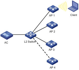

Configuring auto DFS
Network requirements
As shown in Figure 6, configure auto DFS on AC, so that AC can perform channel adjustment when the channel of AP1 is unavailable.
Figure 6 Network diagram
Configuration procedure

Configuring mesh auto DFS
As shown in Figure 7, configure mesh auto DFS on the AC, so that the AC can perform channel adjustment when the mesh channel between AP 1 and AP 2 is unavailable.
Figure 7 Network diagram

Configuring auto TPC
As shown in Figure 8, AP 1 through AP 3 are connected to AC. It is required to configure auto TPC and Specify the maximum number of neighbors as 3 on AC. In this way, when AP4 joins, AC will perform auto TPC.
Figure 8 Network diagram
# Create a WLAN ESS interface.
<AC> system-view
[AC] interface wlan-ess 1
[AC-WLAN-ESS1] quit
# Create service template 1 of clear type, configure its SSID as power-adjust, and bind WLAN-ESS1 to power-adjust.
[AC] wlan service-template 1 clear
[AC-wlan-st-1] ssid power-adjust
[AC-wlan-st-1] bind wlan-ess 1
[AC-wlan-st-1] authentication-method open-system
[AC-wlan-st-1] service-template enable
[AC-wlan-st-1] quit
# Create an AP template named ap1 and its model is WA2100, and configure the serial ID of AP 1 as 210235A045B05B1236548.
[AC] wlan ap ap1 model WA2100
[AC-wlan-ap-ap1] serial-id 210235A045B05B1236548
[AC-wlan-ap-ap1] radio 1 type dot11g
# Bind service template 1 to radio 1 of AP 1.
[AC-wlan-ap-ap1-radio-1] service-template 1
[AC-wlan-ap-ap1-radio-1] radio enable
[AC-wlan-ap-ap1-radio-1] quit
[AC-wlan-ap-ap1] quit
Configurations of other APs are similar to AP 1, and are omitted.
# Enable auto TPC.
[AC] wlan rrm
[AC-wlan-rrm] dot11bg calibrate-power self-decisive
# Specify the maximum number of neighbors, the power adjustment threshold, and the calibration interval.
[AC-wlan-rrm] dot11bg adjacency-factor 3
[AC-wlan-rrm] dot11bg calibrate-power threshold 65
[AC-wlan-rrm] dot11bg calibrate-power min 1
When AP4 joins, the number of neighbors reaches 3. Assume the signal strength of AP 4 is the third among all neighbors (AP 2, AP 3, and AP 4). AP 4 thus becomes the neighbor AP that perform power detection.. If AP 4 detects that the power of AP 1 is –90 dBm, which is lower than the power adjustment threshold –80 dBm, AP 1 will increase its transmission power. If AP 4 detects that the power of AP 1 is –70 dBm, which is higher than the power adjustment threshold –80 dBm, AP 1 will decrease its transmission power. You can use the display wlan ap { all | name apname } rrm-status command to check the adjusted power (TxPower).
The adjusted power of AP 1 cannot be lower than the minimum transmission power (1 dBm in this example).

Configuring session-mode load balancing
·     As shown in Figure 10, all APs operate in 802.11g mode. Client 1 is associated with AP 1. Client 2 through Client 6 are associated with AP 2.
·     Configure session-mode load balancing on AC. The threshold, or, the maximum number of sessions is 5 and the maximum load gap is 4.
Figure 10 Network diagram
# Enable session-mode load balancing, and configure the maximum number of sessions and the maximum load gap as 5 and 4 respectively.
<AC> system-view
[AC] wlan rrm
[AC-wlan-rrm] load-balance session 5 gap 4
[AC-wlan-rrm] quit
[AC-WLAN-ESS1] quit
# Create service template 1 of clear type, configure its SSID as session-balance, and bind WLAN-ESS1 to session-balance.
[AC-wlan-st-1] ssid session-balance
[AC-wlan-st-1] quit
# Create an AP template named ap1 and its model is WA2100, and configure the serial ID of AP 1 as 210235A29G007C000020.
[AC-wlan-ap-ap1] serial-id 210235A29G007C000020
[AC-wlan-ap-ap1-radio-1] return
# Create an AP template named ap2 and its model is WA2100, and configure the serial ID of AP 2 as 210235A29G007C000021.
<AC> system-view
[AC] wlan ap ap2 model WA2100
[AC-wlan-ap-ap2] serial-id 210235A29G007C000021
[AC-wlan-ap-ap2] radio 1 type dot11g
# Bind service template 1 to radio 1 of AP 2.
[AC-wlan-ap-ap2-radio-1] channel 1
[AC-wlan-ap-ap2-radio-1] service-template 1
[AC-wlan-ap-ap2-radio-1] radio enable
[AC-wlan-ap-ap2-radio-1] return
Client 1 is associated with AP 1, and Client 2 through Client 6 are associated with AP 2. The number of clients associated with AP 2 reaches 5, and the load gap between AP 2 and AP 1 reaches 4, so Client 7 is associated with AP 1.
Configuring traffic-mode load balancing
·     As shown in Figure 11, all APs operate in 802.11g mode. Client 1 and Client 2 are associated with AP1, and no client is associated with AP 2.
·     Configure traffic-mode load balancing on the AC. The traffic threshold is 10% and the maximum load gap is 40%.
Figure 11 Network diagram
# Enable traffic-mode load balancing and configure the traffic threshold and the maximum load gap as 10% and 40% respectively.
<AC> system-view
[AC] wlan rrm
[AC-wlan-rrm] load-balance traffic 10 gap 40
[AC-wlan-rrm] quit
# Create interface WLAN-ESS 1.
[AC-WLAN-ESS1] quit
# Create service template 1 of clear type, configure its SSID as traffic-balance, and bind WLAN-ESS1 to traffic-balance.
[AC-wlan-st-1] ssid traffic-balance
[AC-wlan-st-1] quit
<AC> system-view
Client 1 and Client 2 are associated with AP 1. When the maximum traffic threshold and load gap are reached on AP 1, Client 3 is associated with AP 2.

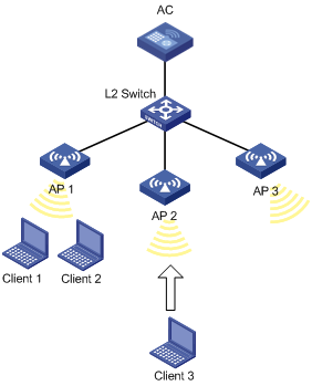

·     As shown in Figure 12, all APs operate in 802.11g mode. Client 1 is associated with AP 1. Client 2 through Client 6 are associated with AP 2, and no client is associated with AP 3.
·     Configure session-mode load balancing on the AC. The maximum number of sessions is 5 and the maximum session gap is 4.
·     Session-mode load balancing is required on only radio 1 of AP 1 and radio 1 of AP 2. Therefore, add them into a load balancing group.
Figure 12 Network diagram
1.     Configure APs on the AC:
<AC> system-view
[AC-WLAN-ESS1] quit
# Create service template 1 of clear type, configure its SSID as session-balance, and bind WLAN-ESS1 to the service template.
[AC-wlan-st-1] quit
# Create an AP template named ap1, and specify its model as WA2100, and serial ID as 210235A29G007C000020.
# Create an AP template named ap2 and specify its model as WA2100, and configure the serial ID as 210235A29G007C000021.
<AC> system-view
# Create an AP template named ap3, and specify its model as WA2100, and serial ID as 210235A29G007C000022.
<AC> system-view
[AC] wlan ap ap3 model WA2100
[AC-wlan-ap-ap3] serial-id 210235A29G007C000022
[AC-wlan-ap-ap3] radio 1 type dot11g
# Bind service template 1 to radio 1 of AP 3.
[AC-wlan-ap-ap3-radio-1] service-template 1
[AC-wlan-ap-ap3-radio-1] radio enable
[AC-wlan-ap-ap3-radio-1] quit
[AC-wlan-ap-ap3] quit
2.     Configure the load balancing mode:
[AC] wlan rrm
[AC-wlan-rrm] quit
3.     Configure group-based session-mode load balancing:
# Create load balancing group 1.
[AC] wlan load-balance-group 1
# Add radio 1 of AP 1 and radio 1 of AP 2 to the load balancing group.
[AC-wlan-lb-group-1] ap ap1 radio 1
[AC-wlan-lb-group-1] ap ap2 radio 1
·     Radio 1 of AP 1 and radio 1 of AP 2 are in the same load balancing group, and the radio of AP 3 does not belong to any load balancing group. Load balancing takes effect on only radios in a load balancing group, so AP 3 does not take part in load balancing.
·     Assume Client 7 wants to associate with AP 2. The number of clients associated with radio 1 on AP 2 reaches 5, and the load gap between AP 2 and AP 1 reaches 4, so Client 7 is associated with AP 1.

·     As shown in Figure 13, all APs operate in 802.11g mode. Client 1 and Client 2 are associated with AP 1, and no client is associated with AP 2 and AP 3.
·     Configure traffic-mode load balancing on the AC. The traffic threshold is 10% and the maximum traffic gap is 40%.
·     Traffic-mode load balancing is required on only radio 1 of AP 1 and radio 1 of AP 2.
Figure 13 Network diagram
<AC> system-view
[AC-WLAN-ESS1] quit
# Create service template 1 of clear type, configure its SSID as traffic-balance, and bind WLAN-ESS1 to the service template.
[AC-wlan-st-1] quit
# Create an AP template named ap2 and specify its model as WA2100, and serial ID as 210235A29G007C000021.
<AC> system-view
[AC-wlan-ap-ap2-radio-1] quit
[AC-wlan-ap-ap2] quit
<AC> system-view
[AC] wlan rrm
[AC-wlan-rrm] quit
3.     Configure group-based traffic-mode load balancing:
·     Assume Client 3 wants to associate with AP 1. When the maximum traffic threshold and load gap are reached on radio 1 of AP 1, Client 3 is associated with AP 2.
Band navigation configuration example
As shown in Figure 14, Client 1 through Client 4 try to associate to AP 1, and the two radios of AP 1 operate at 5 GHz and 2.4 GHz respectively. Client 1, Client 2, and Client 3 are dual-band clients, and Client 4 is a single-band (2.4 GHz) client. Configure band navigation to direct clients to different radios of the AP.
Figure 14 Network diagram
# Enable band navigation on the AC.
<AC> system-view
[AC] wlan rrm
[AC-wlan-rrm] band-navigation enable
[AC-wlan-rrm] quit
# Create a WLAN-ESS interface.
[AC-WLAN-ESS1] quit
# Create service template 1 of clear type, configure its SSID as band-navigation, and bind the WLAN-ESS interface with the service template.
[AC-wlan-st-1] ssid band-navigation
# Disable fast association (Optional. By default, fast association is disabled.)
[AC-wlan-st-1] undo fast-association enable
[AC-wlan-st-1] quit
# Create an AP template named ap1, and specify its model as WA2620E-AGN, and serial ID as 260235A29G007C000020.
[AC] wlan ap ap1 model WA2620E-AGN
# Enable band navigation for AP 1 (Optional. By default, band navigation is enabled.).
[AC-wlan-ap-ap1] band-navigation enable
[AC-wlan-ap-ap1] radio 1 type dot11an
# Bind service template 1 to radio 2 of AP 1.
[AC-wlan-ap-ap1] radio 2 type dot11gn
[AC-wlan-ap-ap1-radio-2] service-template 1
[AC-wlan-ap-ap1-radio-2] radio enable
[AC-wlan-ap-ap1-radio-2] return
# Configure the band navigation load balancing session threshold as 2, and session gap as 1.
<AC> system-view
[AC] wlan rrm
[AC-wlan-rrm] band-navigation balance session 2 gap 1
Client 1 and Client 2 are associated to the 5 GHz radio of AP 1, and Client 4 can only be associated to the 2.4 GHz radio of AP 1. Because the number of clients on the 5 GHz radio has reached the upper limit 2, and the gap between the number of clients on the 5 GHz radio and 2.4 GHz radio has reached the session gap 1, Client 3 is associated to the 2.4 GHz radio of AP 1.
