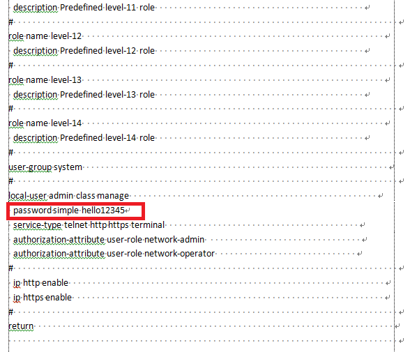

6.     View the content of the startup configuration file. The file-name argument specifies the name of the startup configuration file.
<Sysname> more startup.cfg
7.     Select all command lines in the startup configuration file, copy them, and save them to a local file in TXT format, as shown in Figure 11 and Figure 12.
Figure 11 Copying the content in the startup configuration file

8.     Modify the startup configuration file and delete the password or specify a new password, as shown in Figure 13. In this example, the new password is hello12345.
IMPORTANT
IMPORTANT:
The password for password authentication is configured in AUX line view. The password for scheme authentication is configured in local user view. This example modifies the password for scheme authentication.
Figure 13 Configuring a new password
