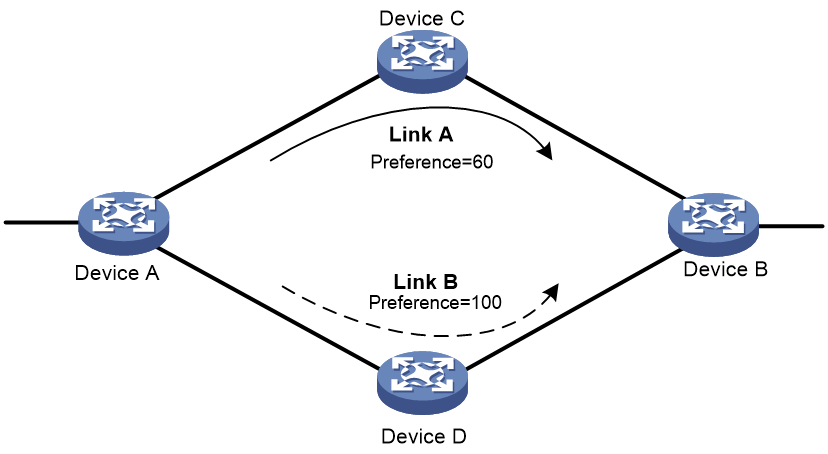

When an IPv6 static or dynamic route to a destination address already exists on the device, you configure another IPv6 static route with a lower priority as the backup route to improve the network reliability. This backup IPv6 static route is called an IPv6 floating static route, and it is activated only when the primary route fails. After the primary route recovers from failure, the IPv6 floating static route becomes inactive, and data forwarding switches back to the primary route.
As shown in Figure 1, two links exist between Device A and Device B. On device A, configure a static route with next hop Device C and preference 60, and configure a static route with next hop Device D and preference 100. The static route with next hop Device D automatically becomes a floating static route.
Figure 1 Configuring a floating static route
You can configure an IPv6 floating static route in either of the following ways
· Configure different priorities for multiple IPv6 static routes to the same destination address. The route with lower priority automatically becomes the IPv6 floating static route.
· When an IPv6 route to a destination address already exists on the device, configure an IPv6 static route with a lower priority to the same destination address.
When you configure an IPv6 floating static route, the priority value of the route must be larger than then priority value of the primary route. For more information, see "Configuring an IPv6 static route."
