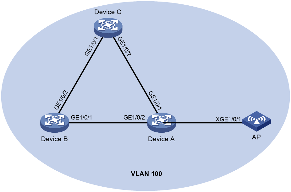

Example: Configuring basic loop detection functions
As shown in Figure 3, the AP is attached to a a ring network. To avoid loops, configure loop detection on the AP to automatically shut down the port attached to the network when a loop occurs in addition to log the event.
1. Configure the AP:
# Configure Ten-GigabitEthernet 1/0/1 as a trunk port, and assign it to VLAN 100.
<AP> system-view
[AP] vlan 100
[AP-vlan100] quit
[AP] interface ten-gigabitethernet 1/0/1
[AP-Ten-GigabitEthernet1/0/1] port link-type trunk
[AP-Ten-GigabitEthernet1/0/1] port trunk permit vlan 100
# Enable loop detection on GigabitEthernet 1/0/1.
[AP-Ten-GigabitEthernet1/0/1] loopback-detection enable vlan 100
# Set the loop protection action to shutdown.
[AP-Ten-GigabitEthernet1/0/1] loopback-detection action shutdown
[AP-Ten-GigabitEthernet1/0/1] quit
# Set the loop detection interval to 35 seconds.
[AP] loopback-detection interval-time 35
2. Configure Switch A:
# Create VLAN 100.
<SwitchA> system-view
[SwitchA] vlan 100
[SwitchA–vlan100] quit
# Configure GigabitEthernet 1/0/2 and GigabitEthernet 1/0/3 as trunk ports, and assign them to VLAN 100.
[SwitchA] interface gigabitethernet 1/0/2
[SwitchA-GigabitEthernet1/0/2] port link-type trunk
[SwitchA-GigabitEthernet1/0/2] port trunk permit vlan 100
[SwitchA-GigabitEthernet1/0/2] quit
[SwitchA] interface gigabitethernet 1/0/3
[SwitchA-GigabitEthernet1/0/3] port link-type trunk
[SwitchA-GigabitEthernet1/0/3] port trunk permit vlan 100
[SwitchA-GigabitEthernet1/0/3] quit
3. Configure Switch B:
# Create VLAN 100.
<SwitchB> system-view
[SwitchB] vlan 100
[SwitchB–vlan100] quit
# Configure GigabitEthernet 1/0/1 and GigabitEthernet 1/0/2 as trunk ports, and assign them to VLAN 100.
[SwitchB] interface gigabitethernet1/0/1
[SwitchB-GigabitEthernet1/0/1] port link-type trunk
[SwitchB-GigabitEthernet1/0/1] port trunk permit vlan 100
[SwitchB-GigabitEthernet1/0/1] quit
[SwitchB] interface gigabitethernet 1/0/2
[SwitchB-GigabitEthernet1/0/2] port link-type trunk
[SwitchB-GigabitEthernet1/0/2] port trunk permit vlan 100
[SwitchB-GigabitEthernet1/0/2] quit
4. Configure Switch C:
# Create VLAN 100.
<SwitchC> system-view
[SwitchC] vlan 100
[SwitchC–vlan100] quit
[SwitchC] interface gigabitethernet 1/0/1
[SwitchC-GigabitEthernet1/0/1] port link-type trunk
[SwitchC-GigabitEthernet1/0/1] port trunk permit vlan 100
[SwitchC-GigabitEthernet1/0/1] quit
[SwitchC] interface gigabitethernet 1/0/2
[SwitchC-GigabitEthernet1/0/2] port link-type trunk
[SwitchC-GigabitEthernet1/0/2] port trunk permit vlan 100
[SwitchC-GigabitEthernet1/0/2] quit
5. Shut down GigabitEthernet 1/0/1 on Switch B to prevent loops.
[SwitchB] interface gigabitethernet 1/0/1
[SwitchB-GigabitEthernet1/0/1] shutdown
# Verify that no loops exist.
[AP] display loopback-detection
Loopback-detection is enabled.
Loopback detection interval is 35 second(s).
No loopback is detected.
# Verify that loop detection is disabled on Switch A, Switch B, and Switch C.
[SwitchA] display loopback-detection
Loopback-detection is disabled.
[SwitchB] display loopback-detection
[SwitchC] display loopback-detection
# Bring up GigabitEthernet 1/0/1 on Switch B to create a loop. (Details not shown.)
# Verify that the AP has detected and removed a loop on the interface attached to the ring network.
%Feb 24 15:04:29:663 2013 AP LPDT/4/LPDT_LOOPED: Loopback exists on GigabitEthernet1/0/1.
%Feb 24 15:04:44:243 2013 AP LPDT/4/LPDT_RECOVERED: Loopback on GigabitEthernet1/0/1 recovered.
Loopback is detected on following interfaces:
Interface Action mode
Ten-GigabitEthernet1/0/1 Shutdown
