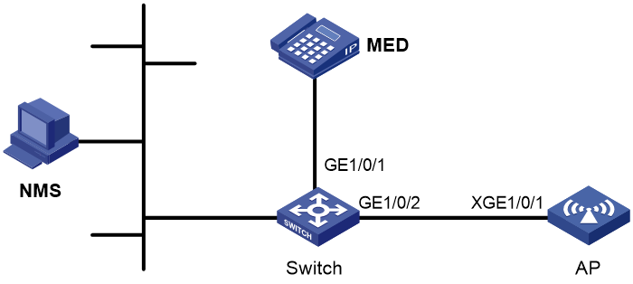

LLDP exchanges packets between neighbor agents and creates and maintains neighbor information for them. Figure 1 shows the neighbor relationships for these LLDP agents.
Figure 1 LLDP neighbor relationships
The types of supported LLDP agents vary with the bridge mode in which LLDP operates. LLDP supports the following bridge modes: customer bridge (CB) and service bridge (SB).
·     Customer bridge mode—LLDP supports nearest bridge agent, nearest non-TPMR bridge agent, and nearest customer bridge agent. LLDP processes the LLDP frames with destination MAC addresses for these agents and transparently transmits the LLDP frames with other destination MAC addresses in VLANs.
·     Service bridge mode—LLDP supports nearest bridge agent and nearest non-TPMR bridge agent. LLDP processes the LLDP frames with destination MAC addresses for these agents and transparently transmits the LLDP frames with other destination MAC addresses in VLANs.

LLDP configuration examples
Example: Configuring basic LLDP functions‌
As shown in Figure 5, enable LLDP globally on the switch and the AP to perform the following tasks:
·     Monitor the link between the switch and the MED on the NMS.
·     Monitor the link between the switch and the AP on the NMS.
Figure 5 Network diagram
1.     Configure the switch:
# Enable LLDP globally.
<Switch> system-view
[Switch] lldp global enable
# Enable LLDP on Ten-GigabitEthernet 1/0/1. By default, LLDP is enabled on all ports.
[Switch] interface ten-gigabitethernet 1/0/1
[Switch-Ten-GigabitEthernet1/0/1] lldp enable
# Set the LLDP operating mode to Rx on Ten-GigabitEthernet 1/0/1.
[Switch-Ten-GigabitEthernet1/0/1] lldp admin-status rx
[Switch-Ten-GigabitEthernet1/0/1] quit
# Enable LLDP on GigabitEthernet 1/0/2. By default, LLDP is enabled on all ports.
[Switch] interface gigabitethernet 1/0/2
[Switch-GigabitEthernet1/0/2] lldp enable
# Set the LLDP operating mode to Rx on GigabitEthernet 1/0/2.
[Switch-GigabitEthernet1/0/2] lldp admin-status rx
[Switch-GigabitEthernet1/0/2] quit
2.     Configure the AP:
<AP> system-view
[AP] lldp global enable
[AP] interface ten-gigabitethernet 1/0/1
[AP-Ten-GigabitEthernet1/0/1] lldp enable
# Set the LLDP operating mode to Tx on Ten-GigabitEthernet 1/0/1.
[AP-Ten-GigabitEthernet1/0/1] lldp admin-status tx
[AP-Ten-GigabitEthernet1/0/1] quit
# Verify the following items on the switch:
·     Ten-GigabitEthernet 1/0/1 connects to a MED device.
·     GigabitEthernet 1/0/2 connects to a non-MED device.
·     Both ports operate in Rx mode, and they can receive LLDP frames but cannot send LLDP frames.
