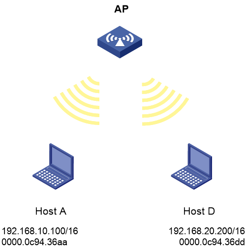

ARP operating mechanism
As shown in Figure 2, Host A and Host B are on the same subnet. Host A sends a packet to Host B as follows:
1.     Host A looks through the ARP table for an ARP entry for Host B. If one entry is found, Host A uses the MAC address in the entry to encapsulate the IP packet into a data link layer frame. Then Host A sends the frame to Host B.
2.     If Host A finds no entry for Host B, Host A buffers the packet and broadcasts an ARP request. The payload of the ARP request contains the following information:
¡     Sender IP address and sender MAC address—Host A's IP address and MAC address.
¡     Target IP address—Host B's IP address.
¡     Target MAC address—An all-zero MAC address.
All hosts on this subnet can receive the broadcast request, but only the requested host (Host B) processes the request.
3.     Host B compares its own IP address with the target IP address in the ARP request. If they are the same, Host B operates as follows:
a.     Adds the sender IP address and sender MAC address into its ARP table.
b.     Encapsulates its MAC address into an ARP reply.
c.     Unicasts the ARP reply to Host A.
4.     After receiving the ARP reply, Host A operates as follows:
a.     Adds the MAC address of Host B into its ARP table.
b.     Encapsulates the MAC address into the packet and sends the packet to Host B.
Figure 2 ARP address resolution process

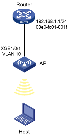

Example: Configuring a static ARP entry
As shown in Figure 3, the host is connected to the AP. The AP is connected to the router through Ten-GigabitEthernet 1/0/1 in VLAN 10.
To ensure secure communications between the AP and the router, configure a static ARP entry for the router on the AP.
Figure 3 Network diagram
# Configure the wireless service on the AP. For more information, see WLAN access configuration in WLAN Access Configuration Guide.
# Create VLAN 10.
<AP> system-view
[AP] vlan 10
[AP-vlan10] quit
# Add Ten-GigabitEthernet 1/0/1 to VLAN 10.
[AP] interface ten-gigabitethernet 1/0/1
[AP-Ten-GigabitEthernet1/0/1] port access vlan 10
[AP-Ten-GigabitEthernet1/0/1] quit
# Create VLAN-interface 10 and configure its IP address.
[AP] interface vlan-interface 10
[AP-vlan-interface10] ip address 192.168.1.2 8
[AP-vlan-interface10] quit
# Configure a static ARP entry that has IP address 192.168.1.1, MAC address 00e0-fc01-0000, and output interface Ten-GigabitEthernet 1/0/1 in VLAN 10.
[AP] arp static 192.168.1.1 00e0-fc01-0000 10 ten-gigabitethernet 1/0/1
# Verify that the AP has a static ARP entry for the router.
[AP] display arp static
  Type: S-Static   D-Dynamic   O-Openflow   R-Rule          I-Invalid
IP address      MAC address    VLAN/VSI name Interface/Link ID        Aging Type
192.168.1.1     00e0-fc01-0000 10            XGE1/0/1                  --   S

Example: Configuring common proxy ARP
As shown in Figure 4, Host A and Host D have the same IP prefix and mask, but they are located on different subnets separated by the AP. Host A belongs to VLAN 1, and Host D belongs to VLAN 2. No default gateway is configured on Host A and Host D.
Configure common proxy ARP on the AP to enable communication between the two hosts.
Figure 4 Network diagram
# Create VLAN 2.
<AP> system-view
[AP] vlan 2
[AP-vlan2] quit
# Configure the IP address of VLAN-interface 1.
[AP-Vlan-interface1] ip address 192.168.10.99 255.255.255.0
# Enable common proxy ARP on VLAN-interface 1.
[AP-Vlan-interface1] proxy-arp enable
[AP-Vlan-interface1] quit
# Configure the IP address of VLAN-interface 2.
[AP] interface vlan-interface 2
[AP-Vlan-interface2] ip address 192.168.20.99 255.255.255.0
# Enable common proxy ARP on VLAN-interface 2.
[AP-Vlan-interface2] proxy-arp enable
# Verify that Host A and Host D can ping each other.
