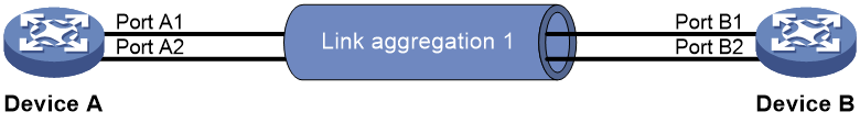

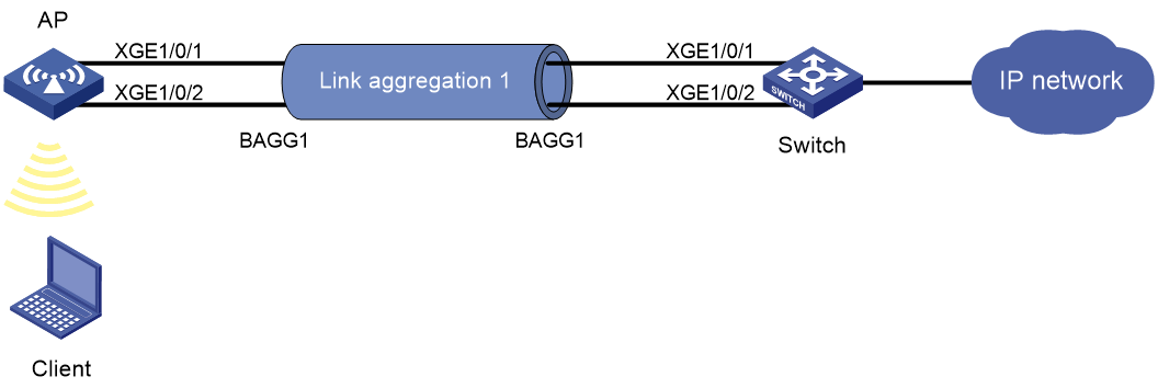

Ethernet link aggregation application scenario
As shown in Figure 1, Device A and Device B are connected by two physical Ethernet links. Both physical Ethernet links are combined into an aggregate link called link aggregation 1. The bandwidth of this aggregate link can reach up to the total bandwidth of the two physical Ethernet links. At the same time, the two Ethernet links back up one another. When a physical Ethernet link fails, the traffic transmitted on the failed link is switched to another link.
Figure 1 Ethernet link aggregation diagram

Example: Configuring a Layer 2 static aggregation group
On the network shown in Figure 4, perform the following tasks:
·     Configure a Layer 2 static aggregation group on both the AP and the switch.
·     Configure the aggregation group to distribute traffic based on the source and destination MAC addresses.
Figure 4 Network diagram

Example: Configuring a Layer 2 dynamic aggregation group
On the network shown in Figure 5, perform the following tasks:
·     Configure a Layer 2 dynamic aggregation group on both the AP and the switch.
Figure 5 Network diagram
