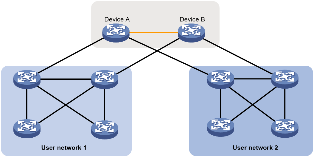

Configuring TC Snooping
As shown in Figure 17, Device A and Device B connect to two user networks through double links.
·     The spanning tree feature is disabled on Device A and Device B and enabled on all devices in user network 1 and user network 2.
·     Device A and Device B transparently transmit BPDUs for both user networks and are not involved in the calculation of spanning trees.
When the network topology changes, it takes time for Device A and Device B to update their MAC address table and ARP table. During this period, traffic in the network might be interrupted.
Figure 17 TC Snooping application scenario
To avoid traffic interruption, you can enable TC Snooping on Device A and Device B. After receiving a TC-BPDU through a port, Device A or Device B updates MAC address table and ARP table entries associated with the port's VLAN. In this way, TC Snooping prevents topology change from interrupting traffic forwarding in the network. For more information about the MAC address table and the ARP table, see "Configuring the MAC address table" and "Configuring ARP."
·     TC Snooping and the spanning tree feature are mutually exclusive. You must globally disable the spanning tree feature before enabling TC Snooping.
2.     Globally disable the spanning tree feature.
undo stp global enable
By default, the spanning tree feature is disabled globally.
3.     Enable TC Snooping.
stp tc-snooping
By default, TC Snooping is disabled.
