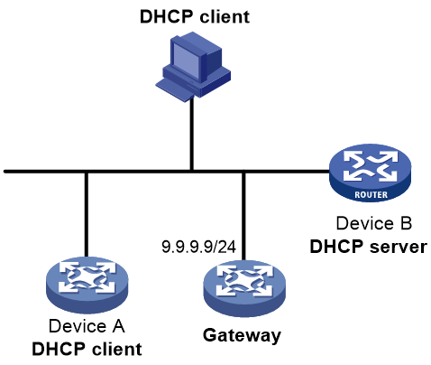

Configuring the DHCP-designated default router as the next hop of a static route
After an interface obtains an IP address and gateway address through DHCP, the device automatically generates a static route with the interface as the output interface. The destination address of the static route is 0.0.0.0/0 and the next hop of the static route is the default router (the gateway address designated by the DHCP server). This static route cannot form ECMP routes with manually configured static routes. The device uses this static route to guide traffic forwarding only after the manually configured static routes become invalid.
Perform this task to use both the automatically generated static route and the manually configured static routes to guide traffic forwarding. The task is applicable when the device has dual egress WAN links.
This task enables the device to automatically generate a static route destined for the specified network with the DHCP-designated default router of the output interface as the next hop. This static route takes effect only after the output interface obtains an IP address and gateway address through DHCP, and becomes invalid upon the DHCP lease expiration. The next hop of this static route changes as the gateway address of the output interface changes. In addition, this static route can form ECMP routes with manually configured static routes.
As shown in Figure 1, Device A acts as the DHCP client, and Device B acts as the DHCP server. Device A automatically obtains IP address and gateway address 9.9.9.9/24 from Device B. After you configure a static route on Device A whose next hop is the DHCP-designated gateway, Device A will generate a static route with gateway address 9.9.9.9/24 as its next hop address. If the gateway address changes, the next hop address of the static route will change to the new gateway address accordingly.
Figure 1 Configuring the DHCP-designated default router as the next hop of a static route
For more information about DHCP, see DHCP in Network Connectivity Configuration Guide.
When you configure the next hop of a static route as the DHCP-designated default router, make sure the output interface of the static route is a broadcast interface.

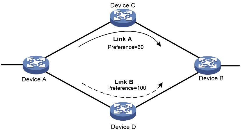

Configuring a floating static route
Perform this task to implement route backup and improve network reliability.
When a static or dynamic route to a destination address already exists on the device, you can configure another static route with a lower priority as the backup route to improve the network reliability. This backup static route is called a floating static route, and it is activated only when the primary route fails. After the primary route recovers from failure, the floating static route becomes inactive, and data forwarding switches back to the primary route.
As shown in Figure 2, two links exist between Device A and Device B. On device A, configure a static route with next hop Device C and preference 60, and configure a static route with next hop Device D and preference 100. The static route with next hop Device D automatically becomes a floating static route.
Figure 2 Configuring a floating static route
You can configure a floating static route in either of the following ways:
·     Configure different priorities for multiple static routes to the same destination address. The route with lower priority automatically becomes the floating static route.
·     When a route to a destination address already exists on the device, configure a static route with a lower priority to the same destination address.
When you configure a floating static route, the priority value of the route must be larger than the priority value of the primary route. For more information, see "Configuring a static route."
