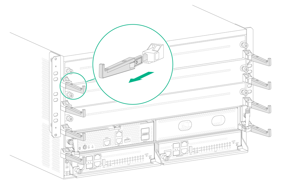

1.     Prepare the packing bag of the cable management brackets. Make sure the bag is clean, dry, and not damaged.
2.     Use a Phillips screwdriver to loosen the screws that attach the cable management brackets to the chassis, and then remove the cable management brackets.
3.     Put the cable management brackets into the bag.
Figure 1 Removing the cable management brackets

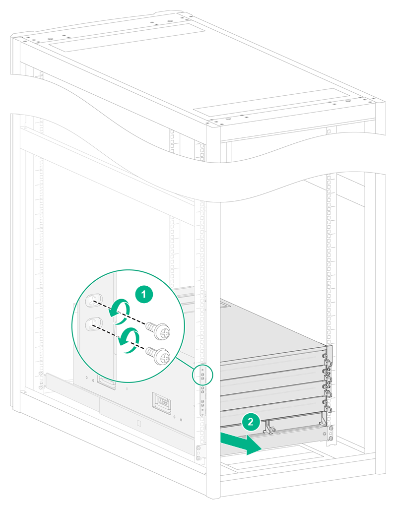

To remove the chassis from the rack:
1.     Prepare the wooden carton and packing bag of the chassis. Make sure the carton and bag are clean, dry, and not damaged.
2.     Remove the top cap and side panels from the wooden carton.
3.     Use a Phillips screwdriver to loosen the screws that attach the mounting brackets to the rack.
4.     Use at least four persons to slide the chassis outwards along the slide rails. When most part of the chassis is removed from the slide rails, lift up the chassis by holding the handles at the chassis sides to completely remove the chassis from the rack.
Figure 2 Removing the chassis from the rack (M9000-X06 as an example)

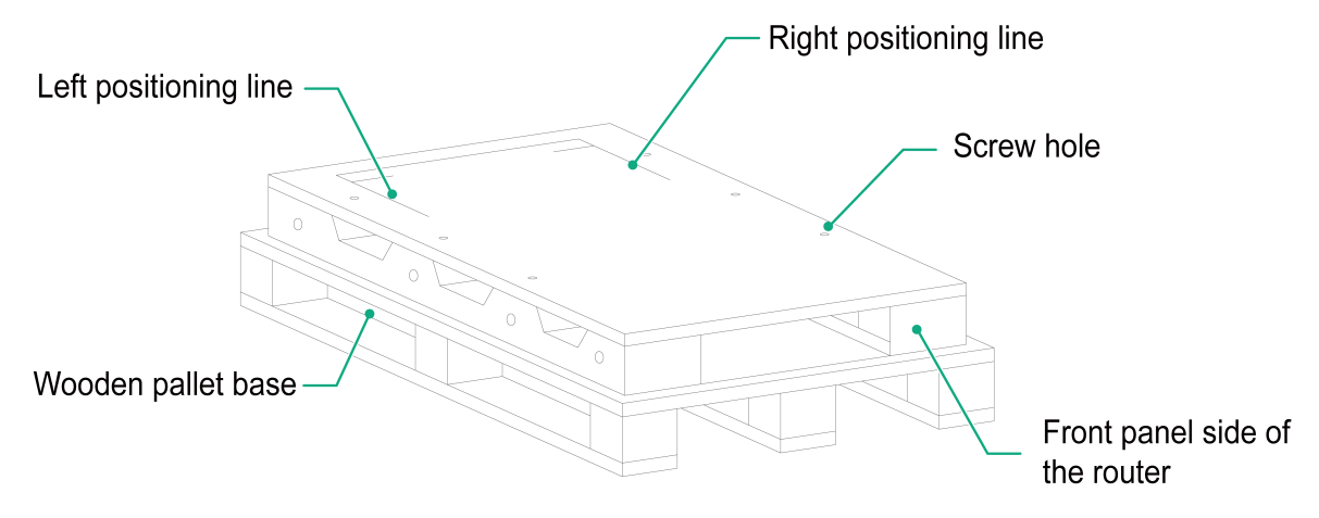

1.     Align the left and right edges of the chassis bottom with the left and right positioning lines respectively on the wooden pallet base. See Figure 3 for the wooden pallet base.
Figure 3 Wooden pallet base

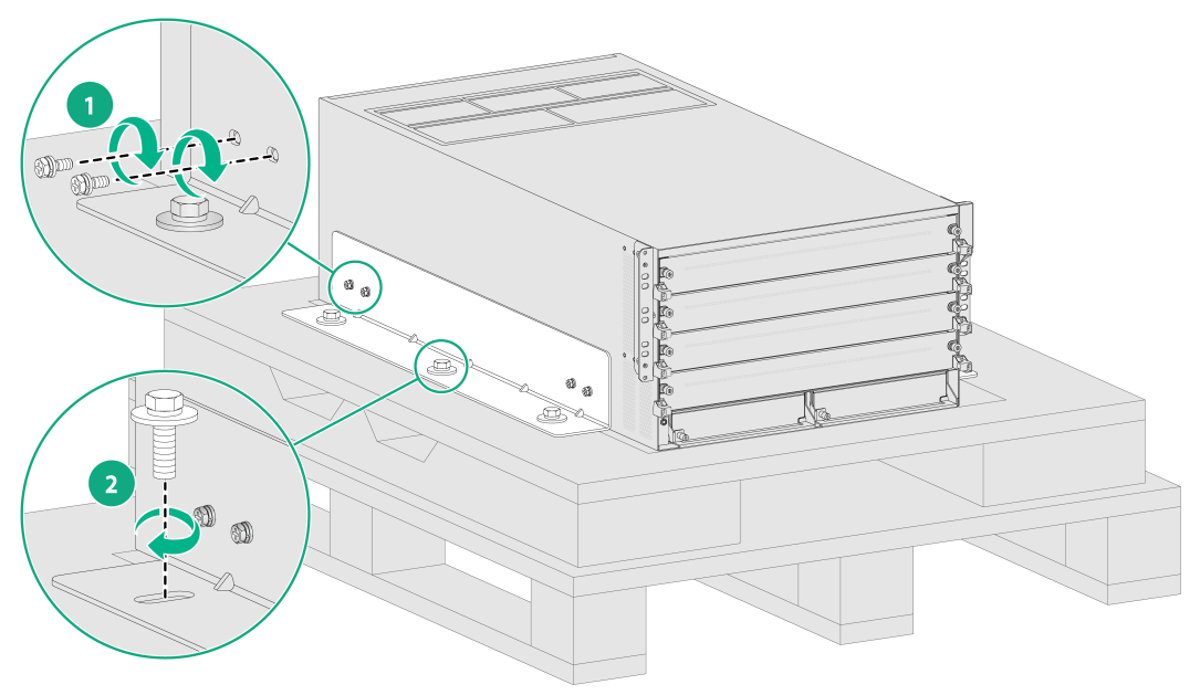

2.     Use screws to attach the L-type brackets to the chassis, as shown by callout 1 in Figure 4.
Figure 4 Attaching the L-type brackets to the pallet base (M9000-X06)
3.     Move the chassis so that the mounting holes on the horizontal ear of the L-type brackets align with the mounting holes on the wooden pallet base. Use screws to attach the L-type brackets to the wooden pallet base, as shown by callout 2 in Figure 4.

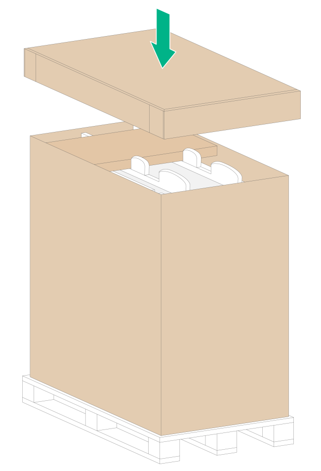

5.     Use the carton to cover the chassis from top down with the mark side aligning with the front panel of the chassis. Erect one paper angle bead along each vertical edge of the chassis.
6.     Put the foam cushion onto the chassis top, and make sure the mounting brackets seat into the internal notches of the foam cushion.
7.     Fit the accessory box into the notch of the foam cushion near to the rear end of the chassis. Then close the carton.
Figure 5 Closing the carton
