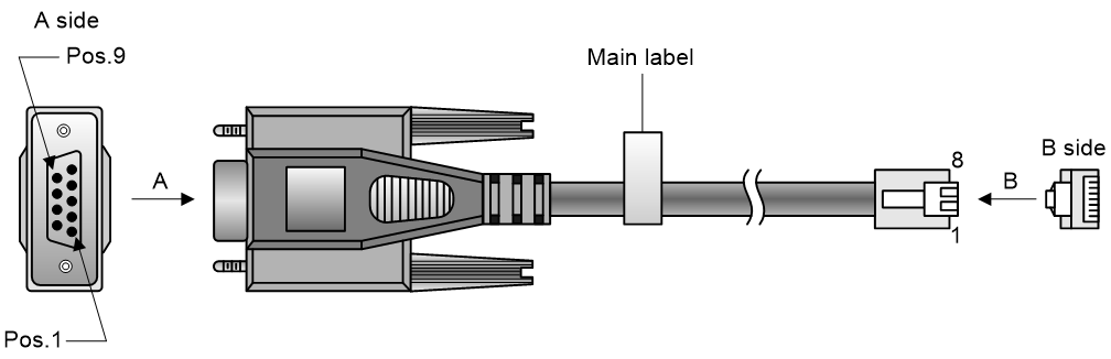

Console cable
A console cable is an 8-core shielded cable, with a crimped RJ-45 connector at one end for connecting to the console port of the gateway, and a DB-9 female connector or standard USB connector at the other end for connecting to the serial port or USB port on the console terminal.
Figure 1 Console cable (DB9-to-RJ45 console cable as an example)
Table 2 Console cable RJ-45 connector pinout
RJ-45
Signal
DB-9
Signal
1
RTS
8
CTS
2
DTR
6
DSR
3
TXD
2
RXD
4
SG
5
SG
5
SG
5
SG
6
RXD
3
TXD
7
DSR
4
DTR
8
CTS
7
RTS

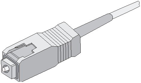

Fiber connector
Fiber connectors are indispensable passive components in an optical fiber communication system. They allow the removable connection between optical channels, which makes the optical system debugging and maintenance more convenient and the transit dispatching of the system more flexible.
Figure 5 SC connector
Figure 6 LC connector
Figure 7 MPO connector
