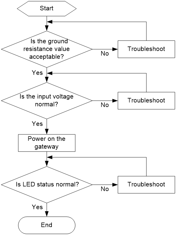

10.     Power-on check
The installation finishes if the gateway operates correctly.

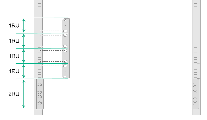

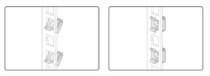

1.     Determine the cage nut installation holes according to the holes in the mounting brackets, as shown in Figure 2. Mark the cage nut installation holes on the front rack post.
The mounting brackets have been installed in the chassis. You can use other tools, such as a tape measure, to align the holes in the mounting brackets with the holes on the rack posts and mark the cage nut installation holes.
Figure 2 Marking cage nut installation holes
2.     Install cage nuts in the marked square holes on the front rack posts.
Figure 3 Installing the cage nuts

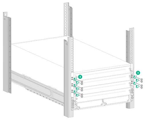

3.     Align the rear of the chassis with the front of the rack.
4.     Use multiple people to lift the gateway by holding the chassis handles. As a best practice, use a minimum of four people to lift an M9000-X10 gateway.
5.     Place the gateway on the slide rails from front of the rack. Slide the gateway along the guide rails until the mounting brackets on the gateway come into contact with the front rack posts.
6.     Use the provided M6 screws to secure the gateway to the rack posts.
Figure 4 Mounting the gateway in a rack (M9000-X06 gateway)

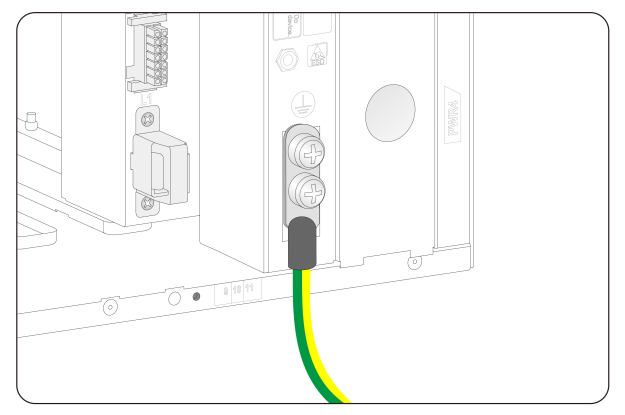

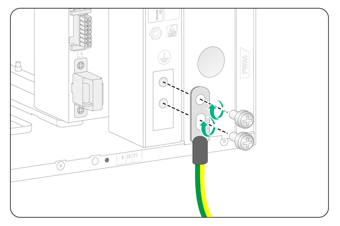

Grounding the gateway
CAUTION
CAUTION:
·     Reliably grounding the gateway is crucial to lightning protection and EMI protection. Ground the gateway reliably with the grounding cable provided with the gateway.
·     Connect the grounding cable to the earthing system in the equipment room. Do not connect it to a fire main or lightning rod.

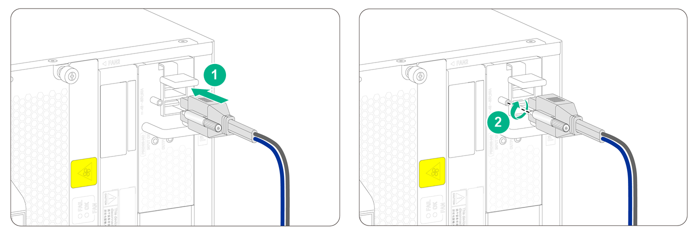

To ground the gateway:
1.     Remove the grounding screws from the grounding holes at the rear of the chassis.
2.     Use grounding screws to attach the two-hole grounding lug of the grounding cable to the chassis.
3.     Connect the ring terminal of the grounding cable to a grounding post of the grounding strip, and fasten the grounding cable to the grounding strip with the hex nut.
Figure 5 Connecting the grounding cable to the gateway

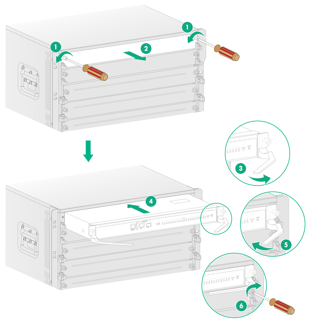

Installing a SEM for an M9000-X06 gateway
1.     Loosen the captive screw on the filler panel and pull the filler panel out of the target SEM slot.
2.     Correctly orient the SEM and then push the SEM steadily into the slot along the guide rails.
3.     Rotate the handle downward. Make sure the SEM makes close contact with the backplane.
4.     Fasten the captive screws on the SEM.
Figure 6 Installing a SEM for an M9000-X06 gateway

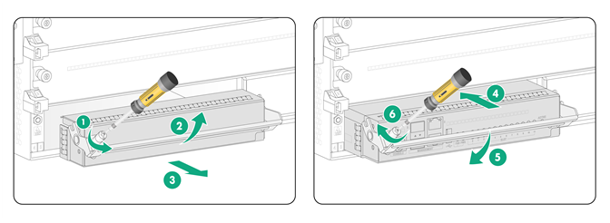

1.     Remove the filler panel from the target SEM slot. Keep the removed filler panel secure for future use.
2.     Correctly orient the SEM, insert it into the slot, and then push it steadily into the slot along the guide rails.
3.     Fully open the ejector levers of the SEM.
4.     Continue to push the SEM by its front panel until the ejector levers make close contact with the slot edges.
5.     Close the ejector levers until they come in close contact with the front panel.
6.     Fasten the captive screws on the SEM.
Figure 7 Installing a SEM for an M9000-X10 gateway

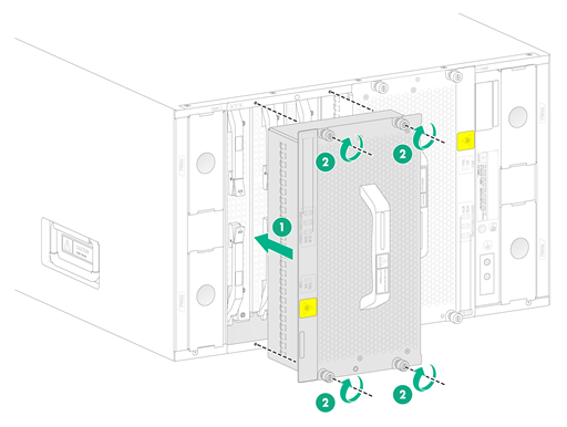

To install a switching fabric module:
1.     Face the rear panel of the gateway and remove the filler panel from the target slot. Keep the removed filler panel secure for future use.
2.     Press the locking tabs of the ejector levers to release the levers.
3.     Correctly orient the switching fabric module. Align the switching fabric module with the target slot and insert it into the slot along the guide rails. Then fully open the ejector levers.
4.     Continue to push the switching fabric module by its front panel until the ejector levers make close contact with the slot edges.
5.     Close the ejector levers until the locking tabs lock the ejector levers in place.
Figure 8 Installing a switching fabric module for an M9000-X06 gateway

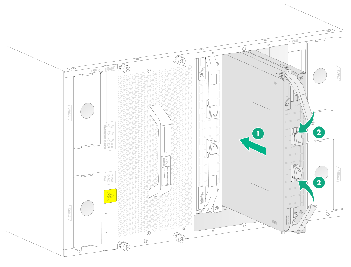

To install an interface module on an interface switch module:
1.     Wear an ESD wrist strap and make sure the wrist strap is reliably grounded.
2.     Remove the filler panel from the target slot. Put your forefinger and thumb into the hole of the filler panel, press the metal tab in the left hole, and then pull the filler panel out.
3.     Open the ejector lever on the interface module and then push the module slowly into the slot along the guide rails until you cannot push it any further.
4.     Close the ejector lever until the latch locks the ejector lever in place.
Figure 9 Installing an interface module on an interface switch module
5.     Install the interface switch module in the gateway. For more information about installing the interface switch module, see "Installing interface switch modules."

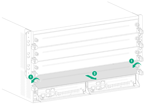

CAUTION
CAUTION:
·     The interface switch modules are hot swappable.
·     If you are not to install an interface switch module in an interface switch module slot, keep the filler panel in the slot.
To install an interface switch module:

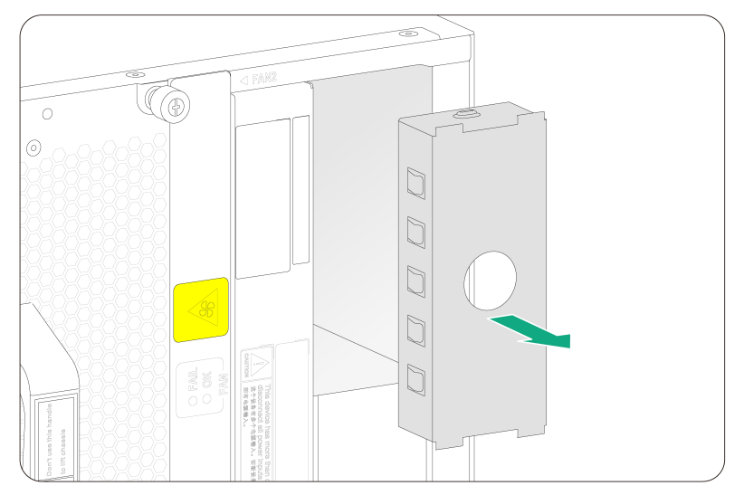

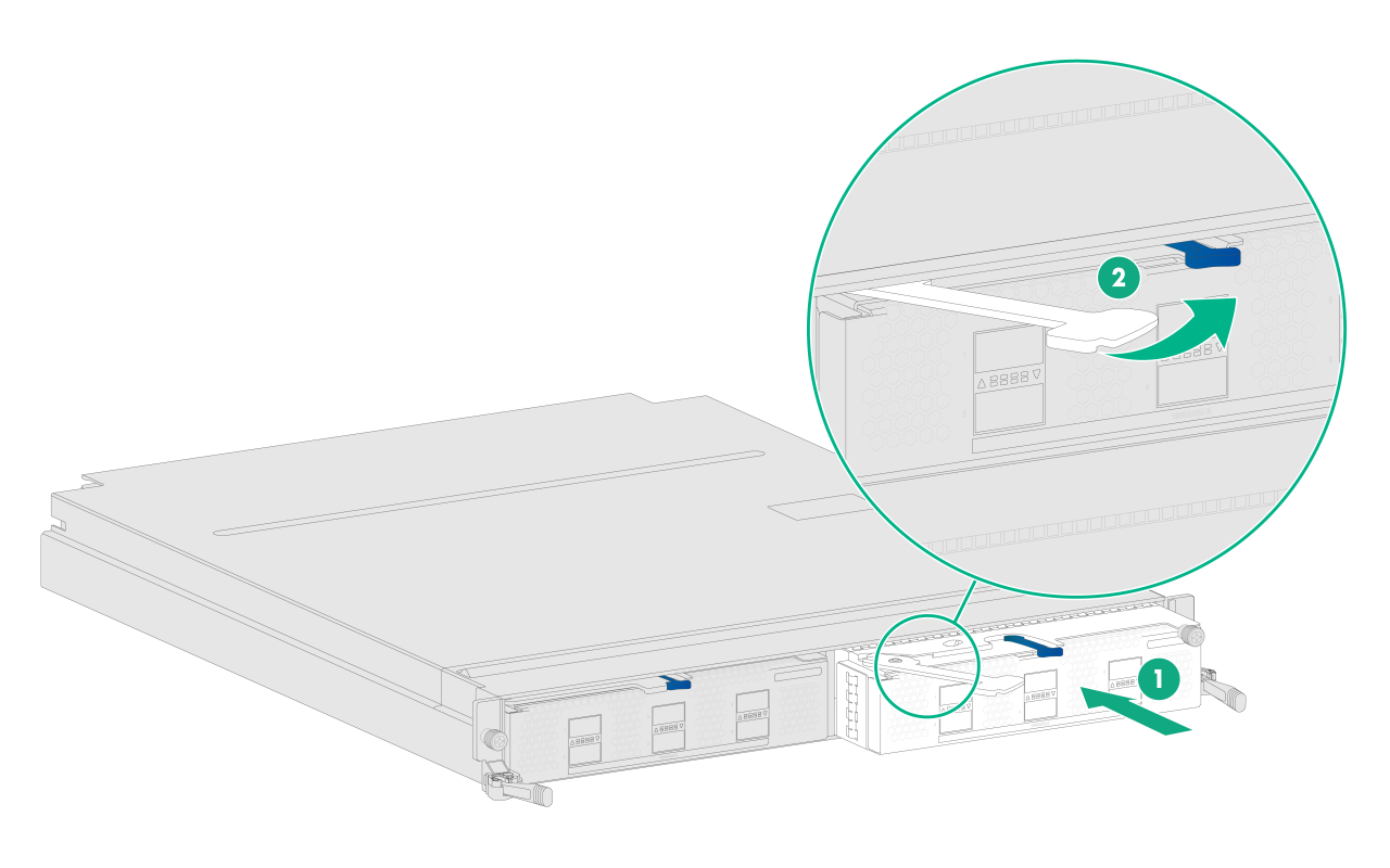

1.     Remove the filler panel from the target interface switch module slot (service module slot). Keep the removed filler panel secure for future use.
Figure 10 Removing the filler panel
2.     Pivot down and fully open the ejector levers of the module. Gently push the module into the slot along the guide rails.
3.     Continue to push the module by its front panel until you cannot push it any further. Then close the ejector levers.
4.     Use a Phillips screwdriver to fasten the captive screws on the module.
5.     Pivot up the ejector levers on the module.
Figure 11 Installing the interface switch module

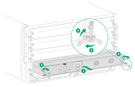

Installing fan trays
To install a fan tray in slot FAN1 on an M9000-X06 gateway, orient the fan tray with the LEDs to the left of the handle. To install a fan tray in slot FAN2, orient the fan tray with the LEDs to the right of the handle.
To install a fan tray on an M9000-X10 gateway, orient the fan tray with the LED above the handle.
The gateway has two fan tray slots. Install a fan tray in each fan tray slot.
To install a fan tray:
1.     Correctly orient the fan tray and align the fan tray with the fan tray slot.
2.     Holding the fan tray handles, steadily insert the fan tray into the slot. Keep the fan tray as steady as possible while inserting it into the slot.
3.     Fasten the captive screws on the fan tray.
Figure 12 Installing a fan tray

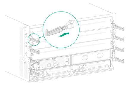

Installing cable management brackets
IMPORTANT
IMPORTANT:
To prevent the cable management brackets from blocking the mounting bracket installation holes on the rack posts, install cable management brackets after the gateway is mounted in the rack.
Cable management brackets are located on both sides of the chassis front panel. The installation procedure is similar for cable management brackets at both sides.
To install a cable management bracket, insert a cable guide to the cable guide hole in the pillow block.
Figure 13 Installing cable management brackets

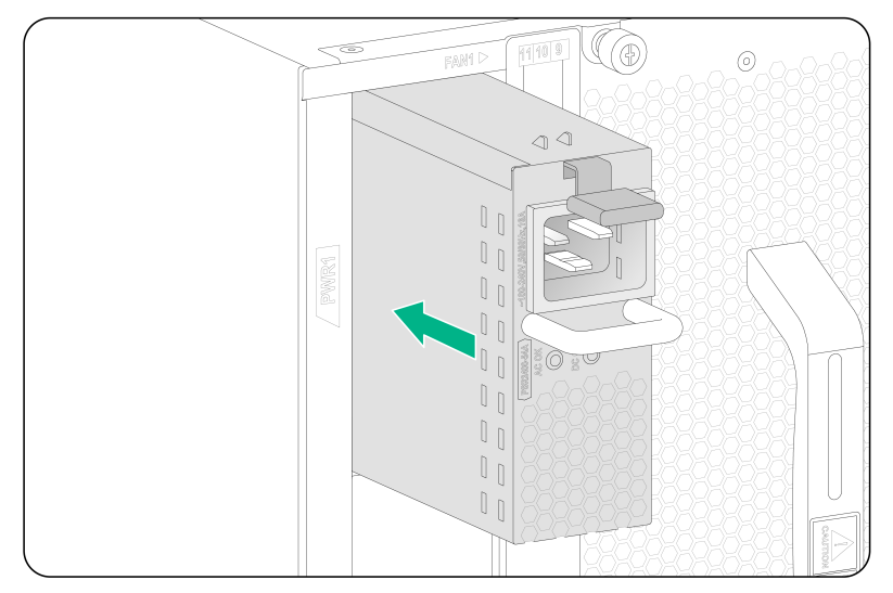

Installing power supplies
The gateway supports AC power supplies, DC power supplies, and HVDC power supplies.
The power supply slots are located on both sides of the chassis rear panel. To install the power supply in a left power supply slot, orient the power supply with the latch above the handle. To install the power supply in a right power supply slot, orient the power supply with the latch below the handle.
Installing AC power supplies
Available AC power supplies
The PSR2400-54A, PSR3000-54A, and PSR3000-54AHD AC power supplies are available for the gateway. Table 3, Table 4, and Table 5 describe the specifications of PSR2400-54A, PSR3000-54A , and PSR3000-54AHD AC power supplies, respectively.

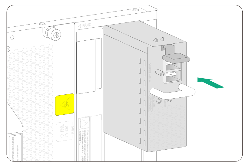

Installing an AC power supply
1.     Put your forefinger into the hole in the filler panel and pull out the filler panel along the guide rails.
Figure 14 Removing a filler panel
2.     Correctly orient the power supply.
3.     Align the power supply with the power supply slot. Then slide the power supply along the guide rails into the slot until the latch locks the power supply in place.
Figure 15 Installing an AC power supply

Connecting a DC power cord
WARNING
WARNING!
Before you connect a DC power cord, make sure the circuit breakers for both of the positive and negative power input wires are turned off.
To connect a DC power cord:
1.     Connect the DC power cord connector to the DC input receptacle of the power supply.
2.     Fasten the screw on the connector to secure the connector to the receptacle.
3.     Connect the other ends of the DC power cords to a DC power source, with the positive wire (+) to the positive terminal and the negative wire (-) to the negative terminal.
Figure 19 Connecting a DC power cord

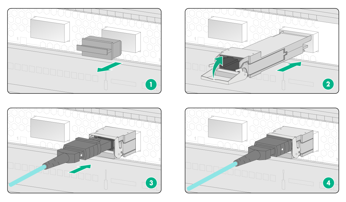

Installing transceiver modules and fiber cables
WARNING
WARNING!
Disconnected optical fibers or transceiver modules might emit invisible laser light. Do not stare into beams or view directly with optical instruments when the gateway is operating.
CAUTION
CAUTION:
·     Before installing a transceiver module, remove the fiber cables, if any, from it. For more information about installing transceiver modules, see the installation guide for the transceiver modules.
·     If you are not to use a fiber port or transceiver module, insert dust plugs into the port or module. If you are not to connect an optical fiber, install dust caps for the fiber connector.

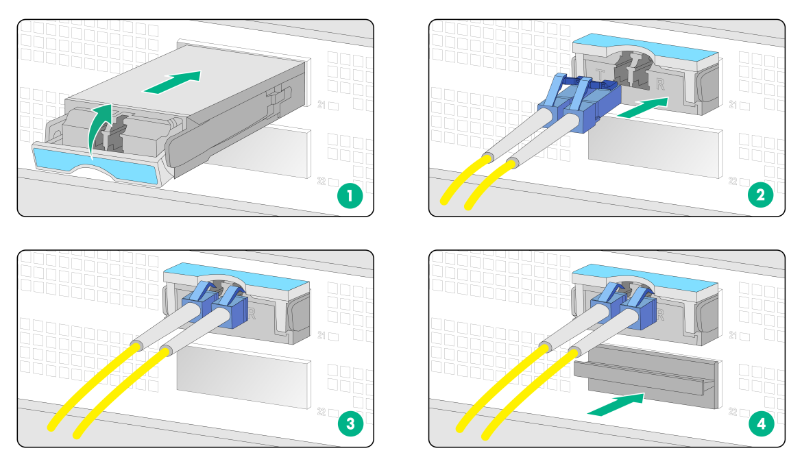

To install a transceiver module and fiber cable:
2.     Remove the dust plug from the target fiber port.
3.     Pull the bail latch on the transceiver module upwards.
Skip this step if the bail latch is plastic.
4.     Take the transceiver module by its two sides and push the end without the bail latch gently into the port until it is firmly seated in the fiber port.
5.     Remove the dust plug and dust cap from the transceiver module and fiber connector, respectively.
6.     Connect the fiber cable to the transceiver module.
¡     LC connector—Align the connector with the transceiver module and push it into the transceiver module slightly until it clicks into place.
¡     MPO connectorOrient the connector with the white spot on it facing right. Insert the MPO fiber connector horizontally into the transceiver module. Push the MPO fiber connector into the transceiver module slightly until it clicks into place.
7.     Use cable ties to bind fiber cables every 150 mm (5.91 in).
8.     Label fiber cables according to the cable labeling specifications.
Figure 20 Installing a transceiver module and fiber cable (with LC fiber connector)
Figure 21 Installing a transceiver module and fiber cable (with MPO fiber connector)

·     The gateway is grounded reliably with the provided grounding cable. Both ends of the grounding cable are securely connected.
·     No switch or fuse is installed on the grounding cable.

Power-on check
WARNING
WARNING!
Locate the emergency power-off switch in the room before power-on so you can quickly shut power off when an electrical accident occurs.
CAUTION
CAUTION:
Before powering on the gateway, make sure all fan trays are present.
Power-on check flowchart
Figure 22 Power-on check flowchart
The gateway provides LEDs for modules installed on the gateway to indicate their operating status. For more information about LEDs, see "Appendix C  LEDs."
