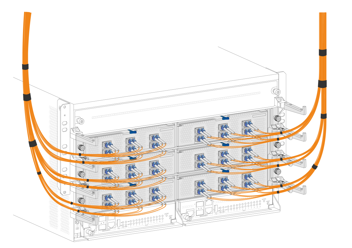

The cable management brackets are installed on the two sides of the front panel of the gateway. As a best practice, route cables from the left and right sides of the gateway, as shown in Figure 1.
Figure 1 Routing cables (M9000-X06)

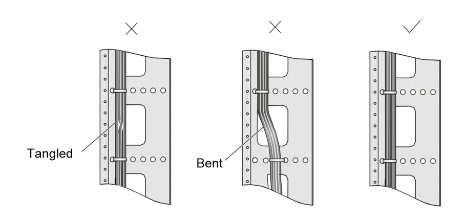

·     Bind and route the cables neatly inside the rack, and make sure they are not kinked or bent.
Figure 2 Correct and incorrect cable binding

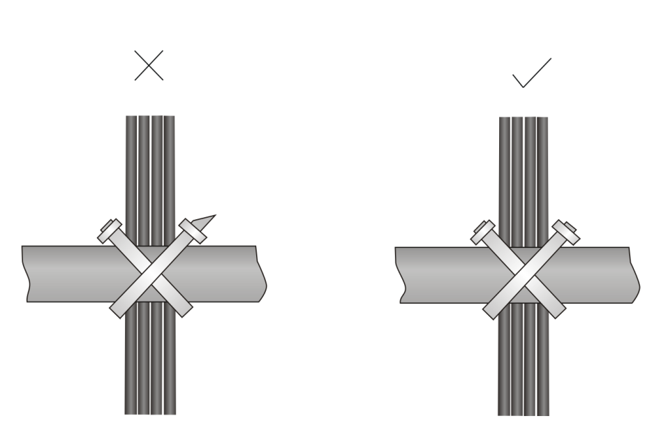

·     After binding the cables, cut the excess from the ties, leaving no sharp or angular tips. See Figure 3.
Figure 3 Cutting cable ties

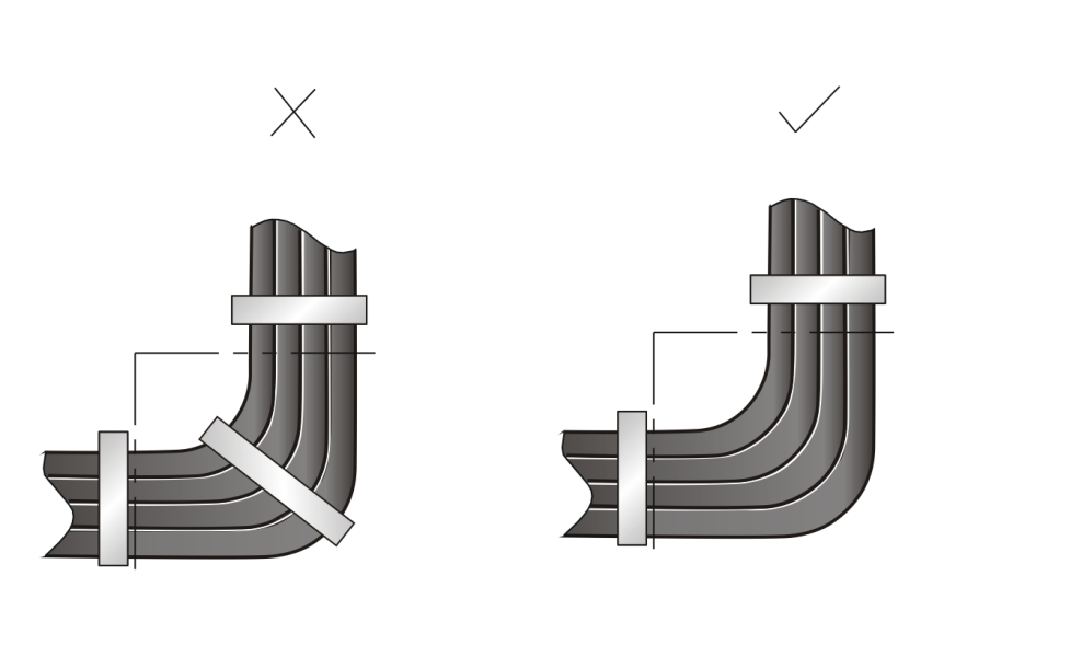

·     When you bend cables, bind them as shown in Figure 4. To avoid excessive stress causing cable core break, do not tie up the cables in the bending area.
Figure 4 Binding cables where they must be bent

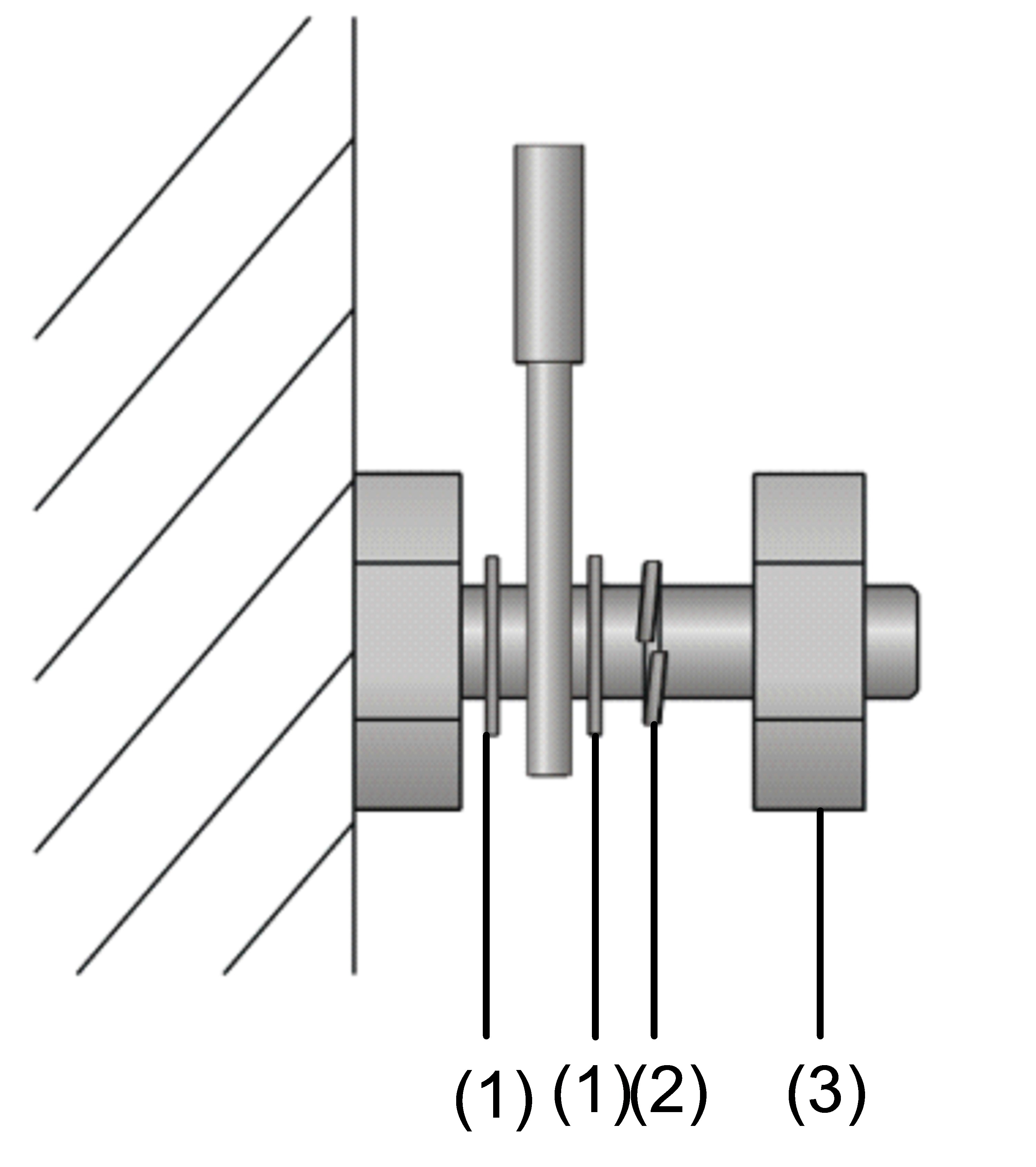

·     Securely fasten cables and take adequate measures to prevent loose connections.
Figure 5 Securely fastening cables
(1) Flat washer
(2) Spring washer
(3) Nut
