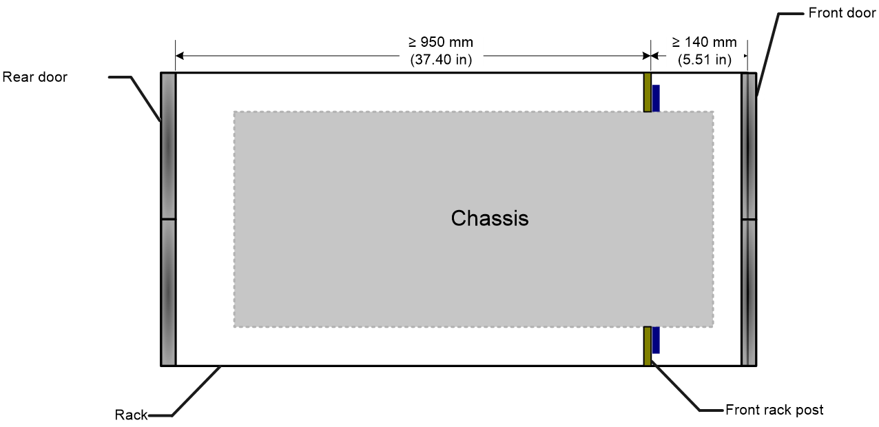

¡     857 mm (33.74 in) for the chassis
¡     102 mm (4.02 in) from the rack-facing surface of the mounting brackets to the front ends of the cable management brackets
¡     875 mm (34.45 in) from the rack-facing surface of the mounting brackets to the fan tray handles at the chassis rear
·     A minimum of 1.1 m (3.61 ft) in depth (recommended).
·     A minimum of 140 mm (5.51 in) between the front rack posts and the front door.
·     A minimum of 950 mm (37.40 in) between the front rack posts and the rear door.
M9000-X10
·     Height—529.6 mm (20.85 in)
·     Width—440 mm (17.32 in)
·     Depth—977 mm (38.46 in)
Figure 1 Rack dimensions

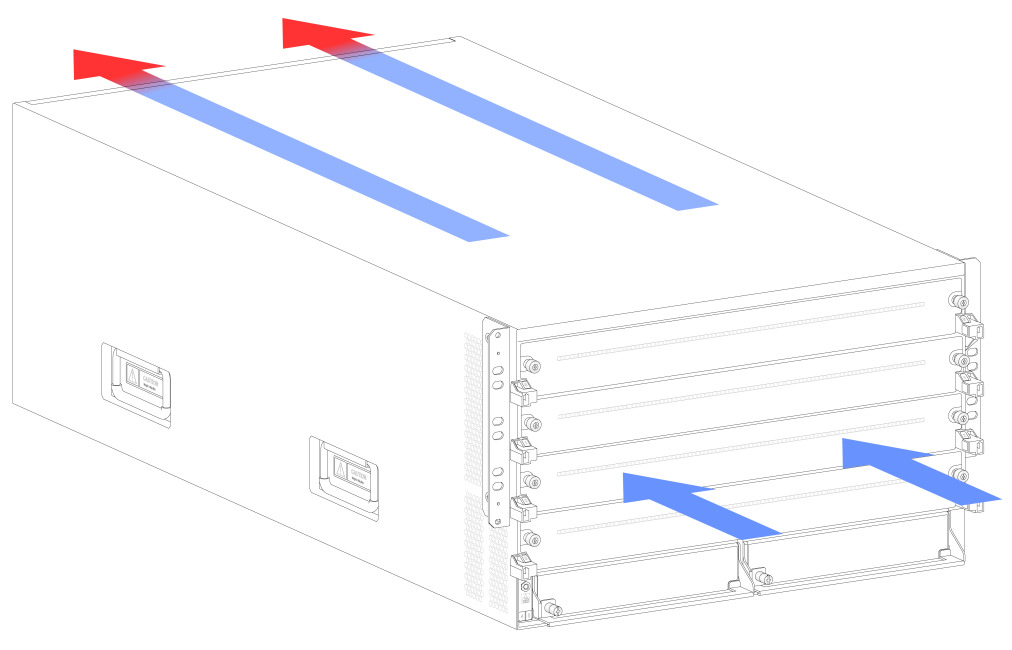

Cooling
The gateway uses front-to-rear airflow for heat dissipation. Plan the installation site for the gateway based on its airflow direction for adequate ventilation. Make sure the following requirements are met:
·     The installation site has a good cooling system.
·     The rack for the gateway has a good cooling system.
·     Leave a minimum clearance of 300 mm (11.81 in) around the inlet and outlet air vents.
Figure 2 Airflow through the chassis (M9000-X06 gateway)
