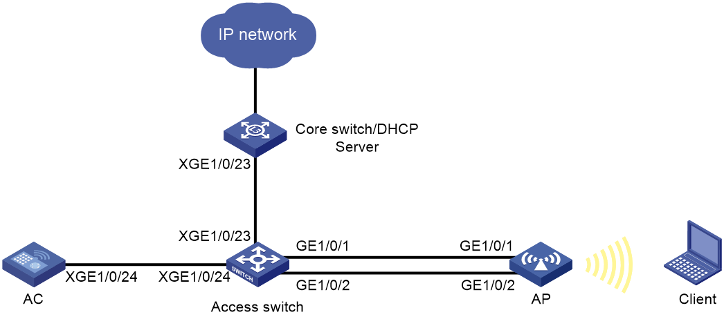

As shown in Figure 1, in centralized forwarding mode, the AC is connected to the access switch in hair-pin mode. The DHCP server assigns IP addresses to the AP and the client.
·     Configure the client to come online in VLAN 200.
·     Assign the AC to VLAN 100, and configure the AC and the AP to establish connections at Layer 2.
·     Configure Layer 2 static link aggregation for the two uplink interfaces connecting the AP and the access switch. Configure load balancing based on source and destination MAC addresses for data traffic to be load balanced among different member ports of the aggregation.
You can configure the load balancing mode as needed. This example is for illustration only.
Figure 1 Network diagram
Analysis
·     Enable the DHCP server feature on the core switch for the core switch to act as the DHCP server.
·     Enable PoE on the access switch to supply power to the AP.
·     Configure wireless services on the AC for the client to access the network wirelessly.
·     Use the actual serial ID of an AP to uniquely identify that AP.
·     Forbids VLAN 1 traffic to be transmitted out of trunk ports to prevent packet accumulation in VLAN 1.
·     As a best practice, use AP uplink interfaces that have the same port rate for link aggregation, and make sure the two peer interfaces on the switch also use the port rate. If the AP uplink interfaces use different port rates, only one interface can forward packets at a time, which increases link availability but disables load balancing.

 network 192.168.20.0 mask 255.255.255.0
 dns-list 192.168.20.1
interface Vlan-interface100
 ip address 192.168.10.1 255.255.255.0
interface Vlan-interface200
 ip address 192.168.20.1 255.255.255.0
interface Ten-GigabitEthernet1/0/23
 port link-type trunk
 undo port trunk permit vlan 1
 port trunk permit vlan 100 200
·     AC:
vlan 100
vlan 200
wlan service-template 1
 ssid service
 client forwarding-location ac
 akm mode psk
 preshared-key pass-phrase cipher $c$3$N//5BVbsOqdBTxi+7MJZKT6Zqh5MAmYs2ZzM
 cipher-suite ccmp
 security-ie rsn
 service-template enable
 ip address 192.168.10.2 255.255.255.0
interface Ten-GigabitEthernet1/0/24
wlan ap-group group1
 ap officeap
 ap-model WA6320
 map-configuration map.txt
  radio 1
   service-template 1 vlan 200
   radio enable
wlan ap officeap model WA6320
 serial-id 219801A28N819CE0002T
·     Access switch:
 link-aggregation global load-sharing mode destination-mac source-mac
vlan 100
vlan 200
 port link-aggregation group 1
 poe enable
 poe enable
interface bridge-aggregation 1
 port access vlan 100
