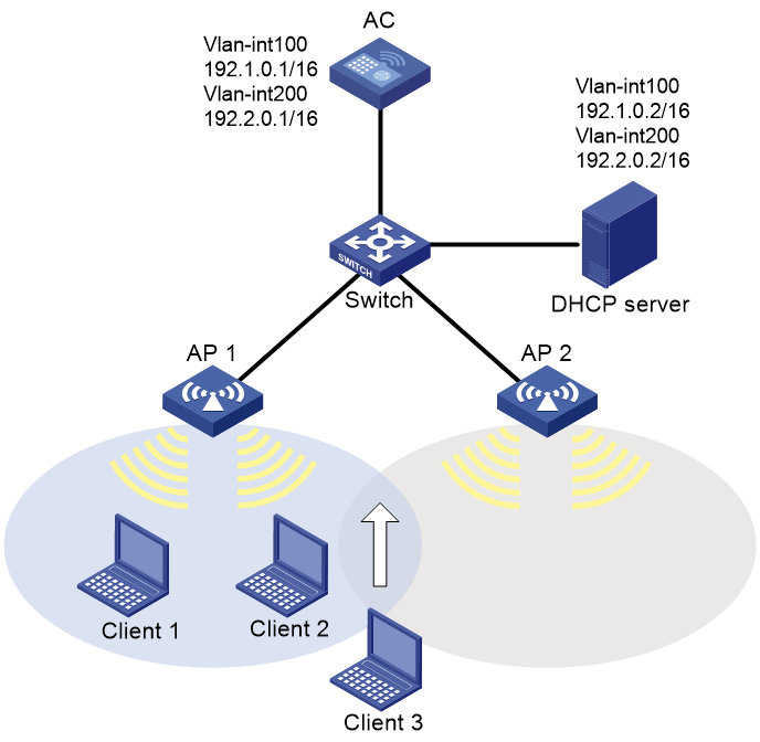

As shown in Figure 1, the DHCP server assigns IP addresses to the APs and clients. AP 1 and AP 2 are managed by the AC and the clients can discover the APs.
Configure the AC to perform session-based load balancing on radio 2 of AP 1 and AP 2 when the following conditions are met:
·     The number of sessions on one radio reaches 2.
·     The session gap between the radios reaches 1.
Figure 1 Network diagram
When you configure WLAN load balancing, follow these restrictions and guidelines:
·     Bind the same service template to the relevant APs.
·     Configure the interface that the AC uses to connect to the network as a trunk port so the port can forward traffic from multiple VLANs.
·     Use the serial ID labeled on the AP's rear panel to specify an AP.
Configuration procedures
Configuring the AC
