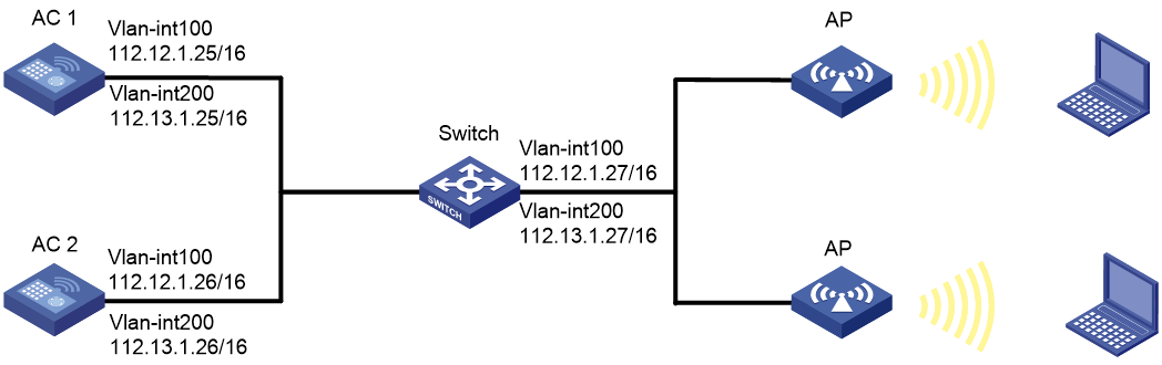

Network requirements
As shown in Figure 1, the APs connect to AC 1 and AC 2 through the switch and the APs provide wireless service for clients. Set the SSID to service and enable AP license synchronization on AC 1 and AC 2. The two ACs back up licenses for each other.
Figure 1 Network diagram
When the master AC fails, the backup AC will take over and becomes the new master AC. The licenses synchronized to the new master AC will be valid for a 30-day grace period.
