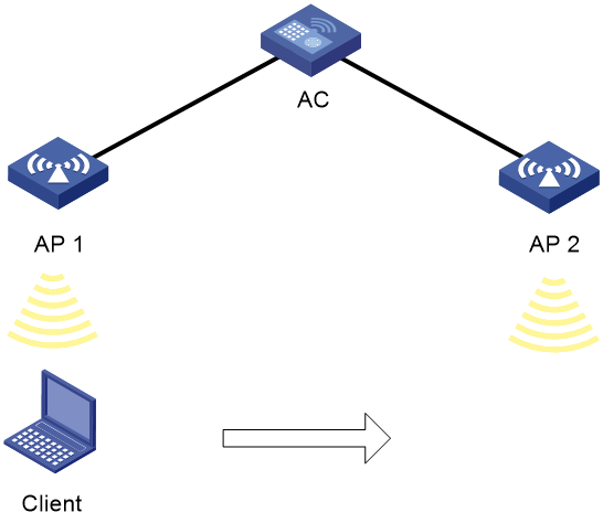

As shown in Figure 1, the AC manages AP 1 and AP 2 and an 802.11v client accesses the wireless network through AP 1.
Configure cooperative roaming on the AC to guide the client to roam to AP 2 when the RSSI is lower than 25 dBm.
