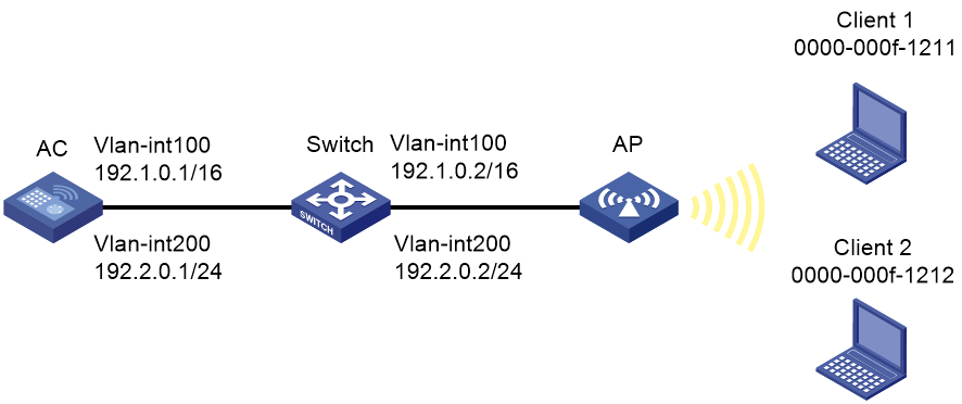

As shown in Figure 1, the switch acts as a DHCP server to assign IP addresses to the AP and the clients, and the AC forwards client traffic. Client 1 is a rogue client. Configure the static blacklist to deny Client 1's access to the WLAN.
Figure 1 Network diagram
Use the serial ID labeled on the AP's rear panel to specify an AP.
