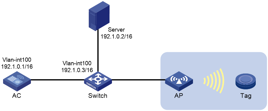

As shown in Figure 1, configure the AP to collect medical RFID tag information and send the information to the location server for calculation. Then, users can obtain tag information in various forms such as maps, tables, or reports.
When you configure medical RFID tag management, follow these restrictions and guidelines:
· Use the actual serial ID of an AP to uniquely identify that AP.
· The port number of the location server configured on the AC must be the same as the port number specified on the location server.

# Verify that the type of module 1 is RFID and the module is enabled.
[AC] display wlan module-information ap ap1 module 1
Module administrative type : RFID
Module physical type : IOT
Model : RFID
HW version : 12090031
SW version : 12090202
Serial ID : 0000051700000042
Module MAC : d461-fefd-0368
Module physical status : Normal
Module administrative status : Enabled
Description :Not configured
# Verify that you can view tag information collected by the AP on the location server.
