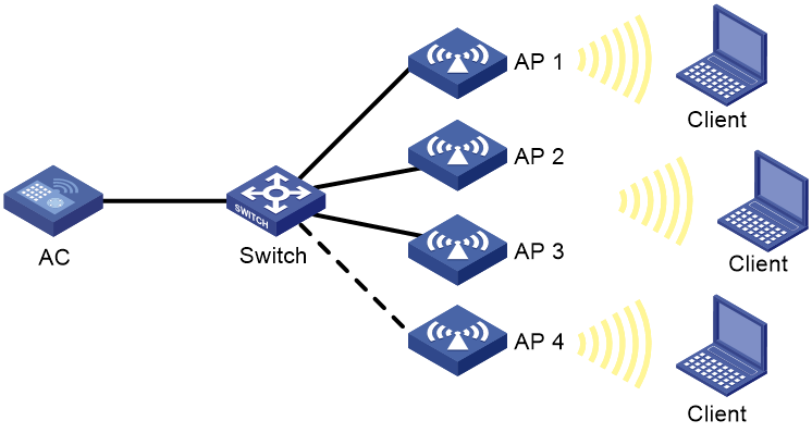

As shown in Figure 1, in centralized forwarding mode, the AC is connected to the switch, and the switch assigns an IP address to the AP and clients as a DHCP server. Configure auto-DFS and auto-TPC for the AP to change the working channel and transmit power automatically based on the wireless environment.
Figure 1 Network diagram

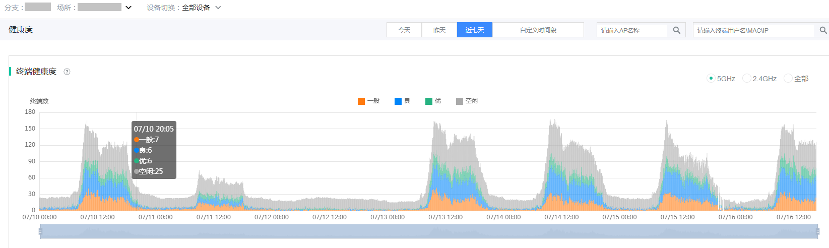

# View the health status of clients to identify whether the number of clients with a health score of excellent and good has increased.
Figure 2 Client health status

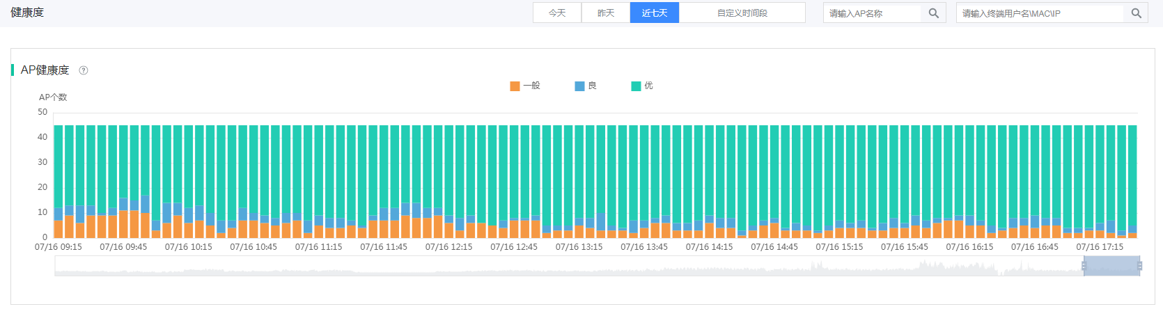

# View the health status of APs to identify whether the number of APs with a health score of excellent and good has increased.
Figure 3 AP health status
