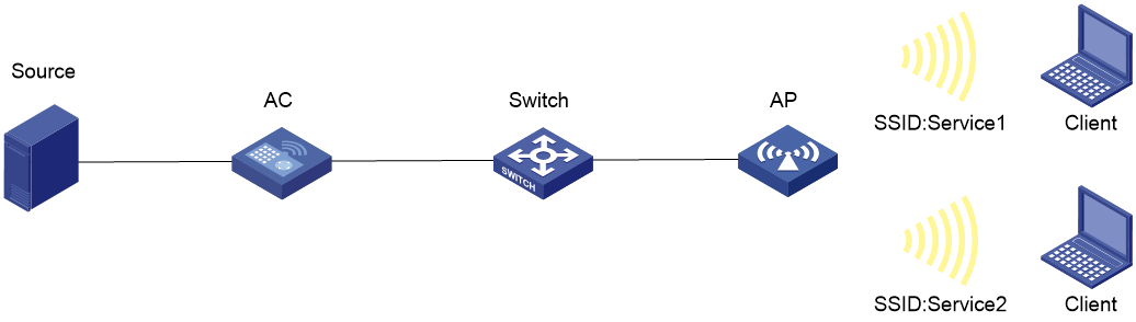

As shown in Figure 1:
· The AC acts as a DHCP server to assign IP addresses to the AP and clients.
· The AP provides wireless services service1 and service2 for Client 1 and Client 2, respectively.
· The AC forwards client traffic.
Configure multicast optimization so that Client 1 can receive video stream for multicast group 224.1.1.1 and Client 2 cannot receive the video stream.
