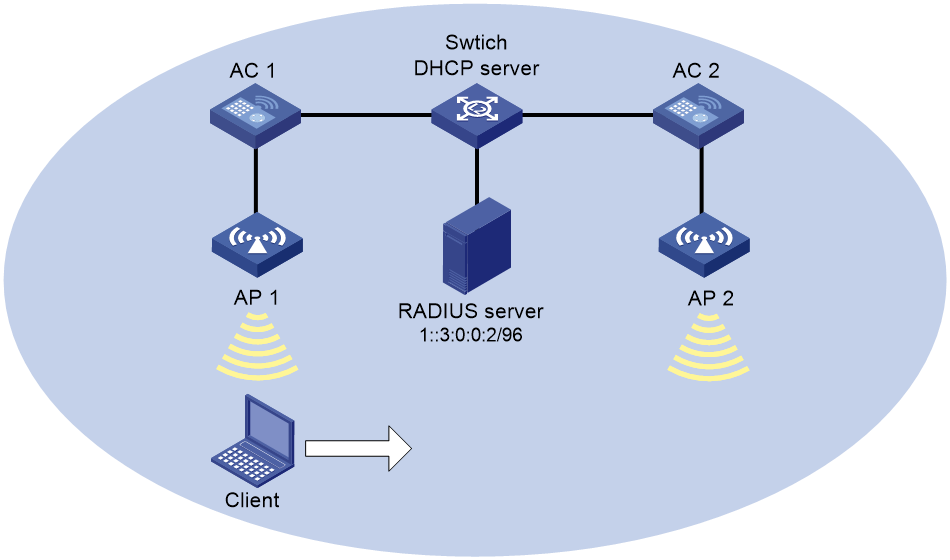

As shown in Figure 1, AP 1 and AP 2 are managed by AC 1 and AC 2, respectively. Clients associated with AC 1 belong to VLAN 200. Clients associated with AC 2 belong to VLAN 400.
Complete the following tasks:
·     Configure all devices to use IPv6 addresses.
·     Configure inter-AC roaming to enable clients to roam between AP 1 and AP 2.
·     Configure VLAN-based user isolation to improve user security and reduce radio resources consumption caused by multicast and broadcast packets.
Figure 1 Network diagram

When you configure inter-AC roaming, follow these restrictions and guidelines:
·     Configure the same SSID, authentication mode, AKE mode, and cipher suite for the service templates to be bound to the APs that are used during WLAN roaming.
·     For successful fast roaming, configure RSN + 802.1X authentication for clients.
·     Add the two ACs to the same mobility group.
·     Use the actual serial ID of an AP to uniquely identify that AP.

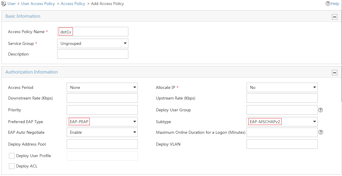

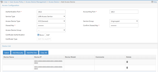

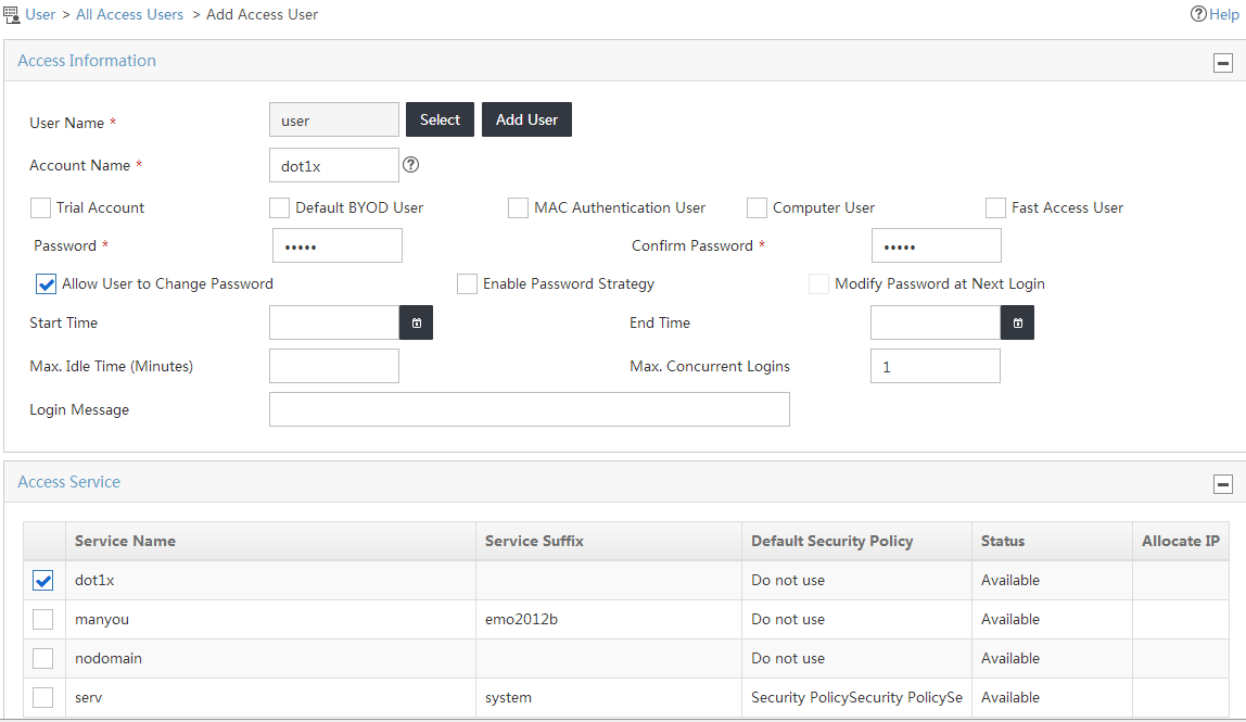

2.     Configure 802.1X authentication:
# Set the EAP message handling method to EAP.
[AC1] dot1x authentication-method eap
# Create a RADIUS scheme named office and enter its view.
[AC1] radius scheme office
# Specify the server at 1::3:0:0:2 as the primary authentication server.
[AC1-radius-office] primary authentication ipv6 1::3:0:0:2
# Specify the server at 1::3:0:0:2 as the primary accounting server.
[AC1-radius-office] primary accounting ipv6 1::3:0:0:2
# Set the shared key to 12345678 for secure communication with the primary authentication server and accounting server.
[AC1-radius-office] key authentication simple 12345678
[AC1-radius-office] key accounting simple 12345678
# Set the source IPv6 address to 1::1:0:0:2 for outgoing RADIUS packets.
[AC1-radius-office] nas-ip ipv6 1::1:0:0:2
[AC1-radius-office] quit
# Create an ISP domain named office and enter its view.
[AC1] domain office
# Configure the ISP domain to use RADIUS scheme office for authentication, authorization, and accounting of LAN users.
[AC1-isp-office] authentication lan-access radius-scheme office
[AC1-isp-office] authorization lan-access radius-scheme office
[AC1-isp-office] accounting lan-access radius-scheme office
[AC1-isp-office] quit

1.     Add the ACs to the IMC Platform as access devices:
a.     Log in to IMC.
b.     Click the User tab.
c.     From the navigation tree, select User Access Policy > Access Device Management > Access Device.
d.     Click Add and perform the following tasks:
-     Enter 12345678 in the Shared Key field.
-     Add IPv6 addresses 1::1:0:0:2 and 1::1:0:0:3 to the Device List.
-     Use the default settings for other parameters.
e.     Click OK.
Figure 2 Adding access devices
2.     Add an access policy:
a.     From the navigation tree, select User Access Policy > Access Policy.
b.     Click Add to add an access policy that uses the following settings:
-     Access Policy Namedot1x.
-     Preferred EAP TypeEAP-PEAP.
-     SubtypeEAP-MSCHAPv2. The subtype must match the client authentication method.
Figure 3 Adding an access policy

4.     Add an access user:
a.     From the navigation tree, select All Access Users.
b.     Click Add and perform the following tasks:
-     Click Add User to add a user with username user.
-     Set the Account Name to dot1x.
-     Set the Password to dot1x.
-     Select the dot1x service.
Figure 5 Adding an access user
