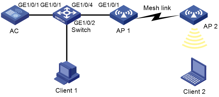

As shown in Figure 1, in centralized forwarding mode, the AC is connected to the switch, and the switch assigns an IP address to APs and clients as a DHCP server. Configure devices to meet the following requirements:
·     AP 1 and AP 2 obtain an IP address from the address pool on VLAN 10 configured on the switch and come online from the AC.
·     The wired client and wireless client are assigned to the same VLAN and are reachable to each other at Layer 2.
Figure 1 Network diagram
·     Use the actual serial ID of an AP to uniquely identify that AP.
·     To avoid too many packets in VLAN 1, configure GE1/0/4 that connects the switch to AP 1 as a trunk port, and remove the port from VLAN 1.

·     Switch:
 dhcp enable
vlan 10
vlan 20
dhcp server ip-pool 1
 gateway-list 172.16.1.1
 network 172.16.1.0 mask 255.255.255.0
 forbidden-ip 172.16.1.2
dhcp server ip-pool 2
 gateway-list 192.168.10.1
 network 192.168.10.0 mask 255.255.255.0
 dns-list 192.168.10.1
interface Vlan-interface10
 ip address 172.16.1.1 255.255.255.0
interface Vlan-interface20
 ip address 192.168.10.1 255.255.255.0
 port link-type trunk
 port trunk permit vlan all
 port access vlan 20
interface GigabitEthernet1/0/4
 undo port trunk permit vlan 1
 port trunk permit vlan 2 to 4094
 port trunk pvid vlan 10
·     AC:
wlan mesh-profile 1
 mesh-id 1
 akm mode sae
 preshared-key pass-phrase cipher $c$3$qVXx1KuNn4FeEi3nMUkQ7A8jcIMrN8JH2AOv
 mesh-profile enable
vlan 10
vlan 20
wlan service-template office
 ssid Documents
 vlan 20
 client forwarding-location ac
 akm mode psk
 preshared-key pass-phrase cipher $c$3$hqxvBKKM0Go5NmRe1XGhiy/nVnzusK20fzlz
 cipher-suite ccmp
 security-ie wpa
 service-template enable
 ip address 172.16.1.2 255.255.255.0
wlan ap-group group1
 vlan 1
 ap ap1
 interface wlan-mesh 1
  mesh-port link-type trunk
  mesh-port trunk permit vlan all
 ap-model WA6330
  radio 1
   type dot11an
   channel 36
   radio enable
   service-template 1
   mesh-interface 1
   mesh-profile 1
   mesh peer-mac-address 90e7-1066-e060
wlan ap-group group2
 map-configuration flash:/map.txt
 vlan 1
 ap ap2
 ap-model WA6330
  radio 1
   type dot11an
   channel 36
   radio enable
   mesh-interface 1
   mesh-profile 1
   mesh peer-mac-address 542b-dea7-a8c0
wlan ap ap1 model WA6330
 serial-id 219801A23V8192E00021
wlan ap ap2 model WA6330
 serial-id 219801A23V8192E00022
