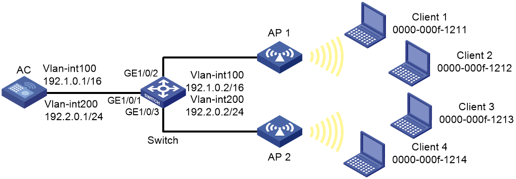

As shown in Figure 1, the switch acts as a DHCP server to assign IP addresses to the APs and clients. The AC forwards client traffic. Perform the following tasks:
·     Set the maximum number of clients that can associate with a radio to enable AP 1 to permit only Client 1.
·     Set the maximum number of clients that can associate with a service template to enable AP 2 to permit only Client 2 and Client 3.
Figure 1 Network diagram
