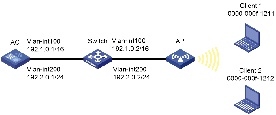

As shown in Figure 1, the switch acts as a DHCP server to assign IP addresses to the AP and the clients. The AC forwards client traffic. Configure service-template-based client rate limiting to limit both the incoming and outgoing traffic rates to 6000 Kbps in dynamic mode.
Figure 1 Network diagram
Use the serial ID labeled on the AP's rear panel to specify an AP.
