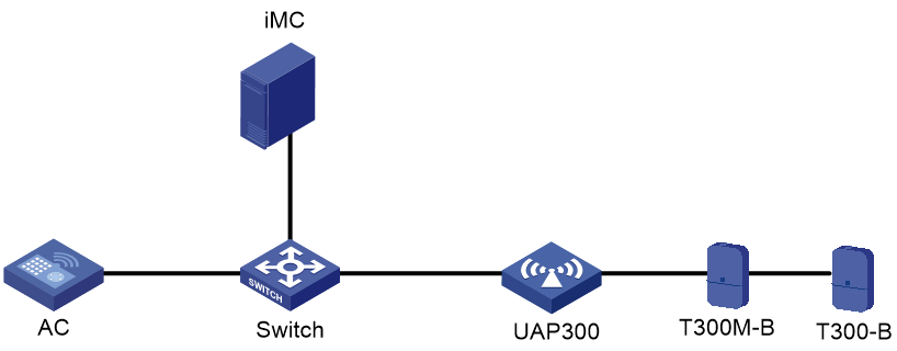

As shown in Figure 1, the IMC server acts as an IoT server, and UAP300 acts as an IoT AP to provide IoT services for the connected IoT modules T300M-B and T300-B.

1. Make sure the devices can reach each other (Details not shown.).
